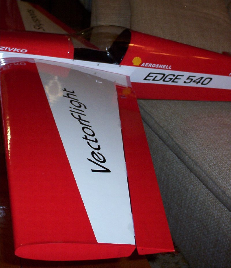

Well...My girl arrived in a nice big box!
Everything arrived in good condition...but I've been working outside all day..tooooooooo tired to start on her!
Maybe tomorrow!
One thing I noticed was the weight of the Fuse...
Everyone here talks about how heavy it is....Mine feels light as a feather!!!!!
As a matter of fact...I don't even have a way to get a weight on it...it doesn't register on any scale I own!
I really want to get a weight before I start!
Only one bad thing about my plane thusfar.
I ordered it with factory slotted ailerons and wings...and they must have missed that!
The shape of the edges tells me I'm goint to need to make a jig....I hope I don't ruin the wing...I SUCK at slotting!
Larry

Bunn,,, sounds like your doing great with the new VF. Sorry about the gear and underside. But I'm sure it'll be even better when your done bulking it up a tad.
Maybe it's just me,,, but of the two Edge540s I've owned , both like a tiny bit of forward CG compared to the Extra300 or Giles202, etc, etc, etc. They seem to get a bit harder to land when tail heavy than others do. Although, too much nose weight and it's a jet on landing or worse..... a deadstick. I found the best position on approach was at a little higher altitude than normal. Then point the plane at the runway and leave the throttle on a high idle. It was hard for me at first to trust myself on this type of landing but the VF Edge always flaired in and slowed down real nice before touching down then rolled to a stop. When I've tried a standard approach using less throttle and gradually dropping alt from a level position I always found the Edge to pop up or dive down a hair. I guess what I'm trying to say is that flying the Edge downward with power works better than trying to use a glide pattern type landing approach. Those wings just wanna keep flying even though you don't.
Larry,,,, glad to see you got your new bird. I've PM'd you with some info on the hinge slotting. Also,,, if you need anything feel free to call me anytime. I may not know the answer but I'll help you become more confused over the question. LOL [sm=confused.gif][sm=lol.gif]

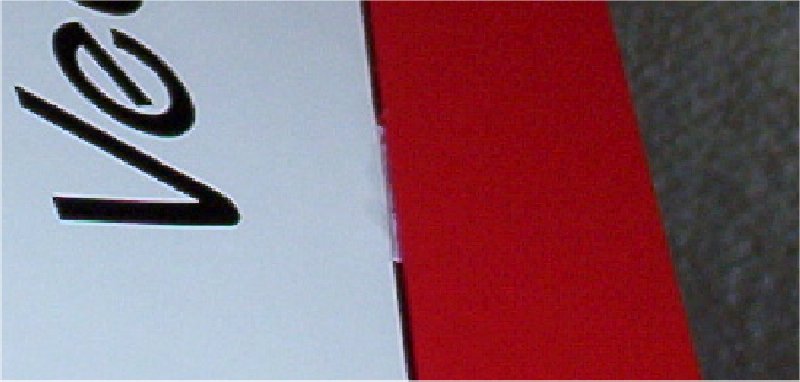

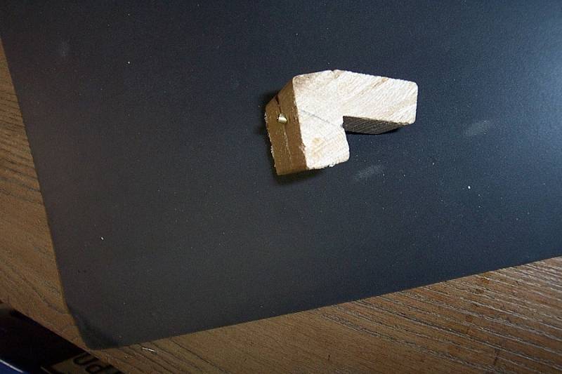

Ok,, wish I had taken step by step pics of how to hinge these ailerons. But I'll try and describe it.
1. Lay the ailerons along the trailing edge (TE) the way they will be attached. (dry fit). The underside of each aileron has a 1/4" fold from the covering job. Good way to tell up from down on this part.
2. Use a couple strips of blue painters tape to hold them in place. Then take a fine-point non-permanent marker or ink pen and mark the location of each area you plan to hinge. (Use the acual hinge as a guide for marking.)
3. Take a new thin bladed XActo , starting 1/16th from the edge of the TE. MAKE YOUR SLOTS AT AN ANGLE TOWARDS THE CENTER.
Do this with both the aileron and the TE of the wing. Take your time. Don't rush !! Keep dry-fitting between to make sure each one is even and in-line with the wing.
4. You have exactly 1/2" of wood between you and the foam. Your hinges don't need to be any deeper than this. If you choose to use regular non-foam safe CA you will liquify the foam beyond the 1/2" of wood.
The same angled process is used to install point hinges as well. The trick to those is to cut off excess segments of the point that might damage the foam. Normally hinge glue or epoxy is used with the point style hinges so foam damage from reg CA is avoided.
Take your time and dry fit every one till your positive they are straight and true.
P.S. Oh yeah,,,, be careful with the CA because it will soak through the vinyl and slightly stain the white colored areas around the hinge.
