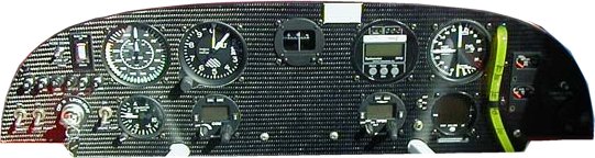

Oh ,, almost forgot Larry. Here's a couple of real photos of the Zivko's panel if you want to make yourself a nice cockpit with exact scale intruments.
I can also send them to you in a larger file format like .PSP , Photoshop or .BMP.
