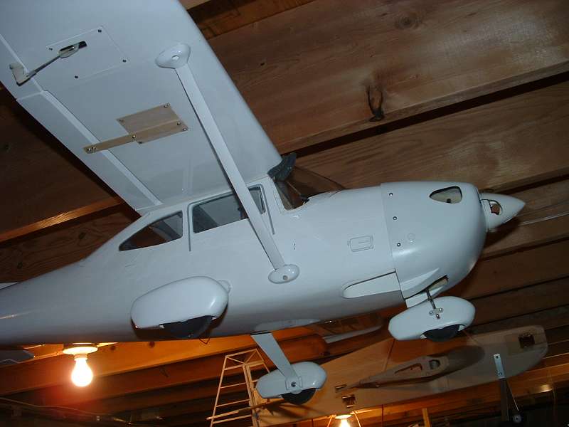

Well, it looks like the Jett is not the engine for this plane. But now I have a new dilema. I have this Cessna as well as an OMP Katana both needing an engine. I have an Irvine 53 and will be selling the Jett to get another engine. I was thinking of putting the Irvine on the Cessna and a Saito 72 on the Katana. But my concern with the Cessna is that I do not want to cut more cowl than necessary. To those that have this plane with a 2 stroke, how much cowl did you have to cut away?

DO a search (make sure the time period specified is at least a year) in RC Universe on "Cessna" and you will find some pictures of the GP Cessna. This should give you some idea of how others have cut their cowls. Ignore Topflite, etc. Generally you should open up the front cowl as much as you can stand and then I would open up the bottom exit area around the nose gear strut. Here is a pict of mine where you can see how I cut the bottom of the cowl. You can see where I put a delta shaped hole for my OS52 valve cover.

Thanks Gary. I did some searches but was not finding many pics of these with 2 strokes showing cutouts. There was one person that had an Irvine 53 in his, but he did not have pics of the side of the cowl. I am really leaning towards the Irvine, and getting a 4 stroke for the profile.

After doing some more searches, I found a pic of this plane with an OS 46 in it. The cutout for the head was not bad, but the one for the muffler looked bad. So now I am thinking of a Saito 72 for it. I know it would be overpowered, but I could easily use that engine in a lot of other planes down the road. Is this to much engine for the plane?

Yes, the Saito .72 would work very well, after all the plane weighs 7 pounds or more! It was a little bit of a struggle to take off with my OS.52, but I had wheel pants on and they were dragging in the grass. Be prepared to land rather fast as this plane cannot be glided in like a trainer....it will stall. On landing, mine did with a bent gear and cracked pant as a result. Guess I should take some heavy warbird landing lessons!!
I suggest that you seriously consider the Saito .82. It just about makes the Saito .72 and .91 both obsolete. It weighs about the same as the .72 and puts out almost the power of the .91 according to engine tests. It would be a slightly more versatile engine for you expecially if you are into aerobatics. Or it could swing a 3 bladed prop on that Cessna for a more scale look......if you are into spending some money for all of this!!!
