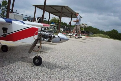

This is a slighty modified WM SS 60.
Wing is stock as is fuse but I made a different rear end to hold up to the 180.
Fuel is CP 180 heli:
Prop is APC 16/10:
Radio is JR with 2 Hitecs digital MG in wing.
Needless to say it is a vertical rocket.

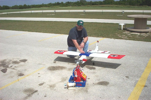

It's me with SS 180, the plane actually belongs to Doug Dodson.

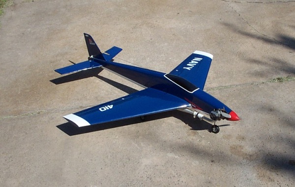

When I want to go fast I use the plane below.
