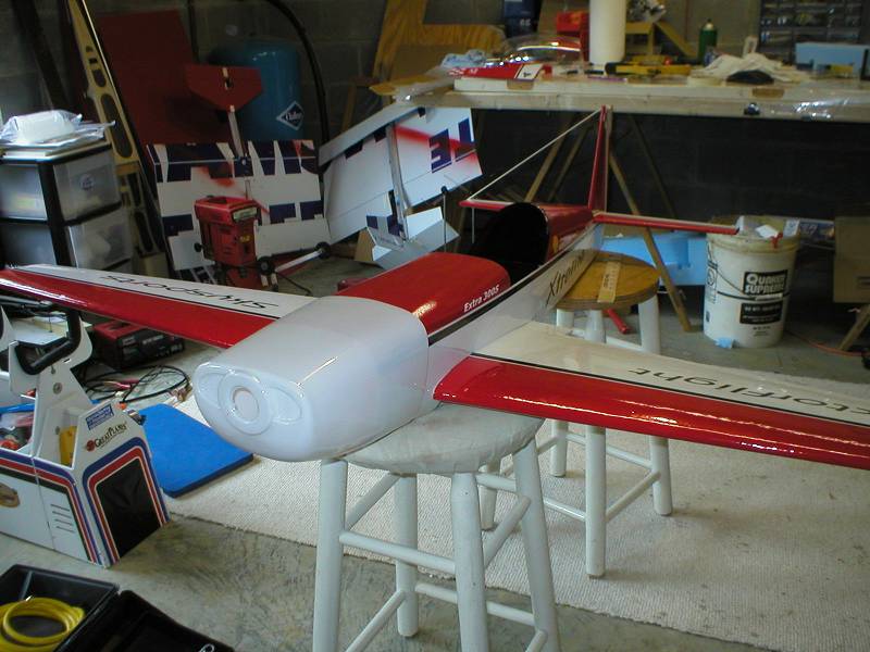

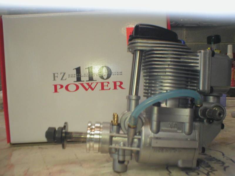

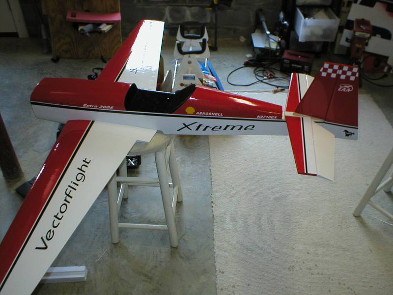

Here are a few pics of my build so far.
ID:	308485   Click image for larger version
ID:	308486   Click image for larger version

Aren't they purty
Old 08-10-2005 | 07:50 PM
exeter_acres's Avatar
Joined: Sep 2004
Posts: 7,457
From: Johns Creek, GA
Default RE: Vector Flight Xtra 300 66" build
nice Spads

Your plane will be insane with that YS on the nose.
Looks good. Keep posting.

ORIGINAL: suitcase
suitcase, why is the cowling all white??? Don't they come prepainted? Nice looking plane. I've been looking at the 300 and the 540. Can't seem to make up my mind
Old 08-13-2005 | 04:37 PM
Joined: Sep 2004
Posts: 7,457
Was wondering about the cowling... on the Edge it is red and then I needed to apply the trim
as for applying the "cheesy"[:@] plastic piece over the tail feathers...I used canopy glue...worked fine....
