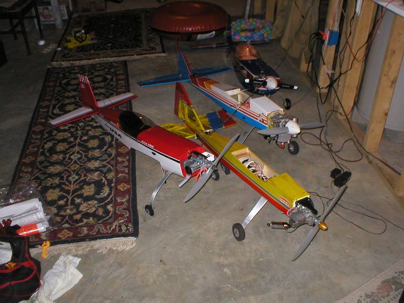

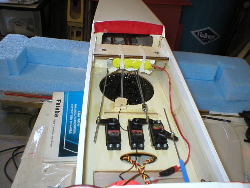

Sounds like a good idea Ross. I've just got used to tying them off to the top of the stab. Yet I worry about tripping on it when I hold it with the back of my legs. Here's a pic of how my battery and antenna wire is done. The other photo is our stuff charging. That's my Jerry's Big Boy and VF Extra and RVator's US 60 and Goldberg Extra 300. When we actually went, we only took the two extras and my BB. Lucky I did because the YS wasn't cooperating that day. I hope to maiden it next week some time. Well,,, when my new tank arrives.

on my edge... I just ran it inside a tube down the inside of the fuse... nothing showing.. no problems for me

I've heard of some interference from them run inside the fuse on some models. I'll post when I maiden mine next week I hope.
ORIGINAL: exeter_acres

there can be...depends on the construction... proximity to control rods, carbon fibre, etc...
but I have had no problems yet...

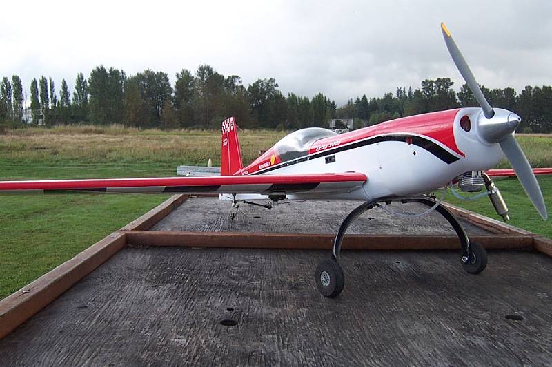

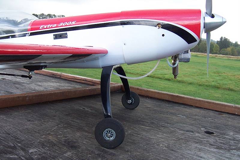

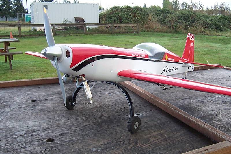

I got in the maiden + some this morning before the rain and wind arrived. Overall, awesome plane. First takeoff, got speed up and tail lifted off ground, up elevator, more up elevator then finally a low angle takeoff just before the end of the field. It needed much up elevator trim and a smidge of right aileron. Based on some field tests, I think a thin shim under the wing hold-down bolts to decrease the incidence will cure the elevator problem. Knife edge was very good, just a slight tendency to pull to the wheels (another indicator of incidence problem). rolls are nearly axial. Snap rolls are almost instantaneous on high rates and no aileron is necessary. I put in the 2 degree right thrust, but I think 2.5 or 3 degrees will be necessary. Zero down thrust is correct. I won't change anything until I can test under calmer conditions. Plane tracked straight in loops, no deviation. Inverted flight requires a bit more down elevator than I would like but I will ignore for now. Vertical was unlimited with the O.S. 1.2 FS and a 16x6 APC prop. I must keep the speed up on landing (as I suspected with a 9# 4 oz weight) as it tends to tip stall to the left. Found this to be true on takeoff too if not enough speed is acquired before liftoff. I still have several more tests to do before it's trimmed out but I will say the aileron and rudder high rates are too low. I like one roll per second or or more on high rates and it rolls at about 3/4 roll per second. Rudder high rate is not enough to maintain level flight in knife edge. The aileron differential per the manual was ok, i need some fine adjustment on mine to track straight. Couple of pics of the engine install
