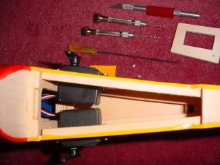

It's actually alot easier to have them come out tail heavy than nose heavy. Putting two elevator servos in the tail usually means a battery pack up by the firewall.

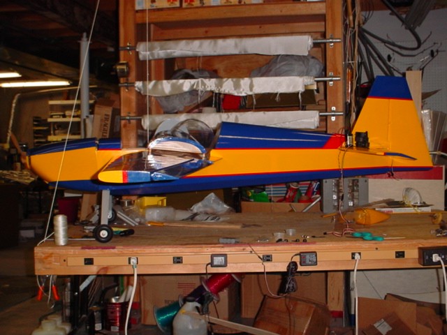

Thanks for the comeback. On mine I hung it by the former infront of the spar, about 4¼" back, and did a layout. It balanced with three servo's on the stab so I was considering putting all three servo's in the rear but first wanted to hear what others were doing with theirs. What engine were you using? What size prop was it spinning? Any help on the spar situation?

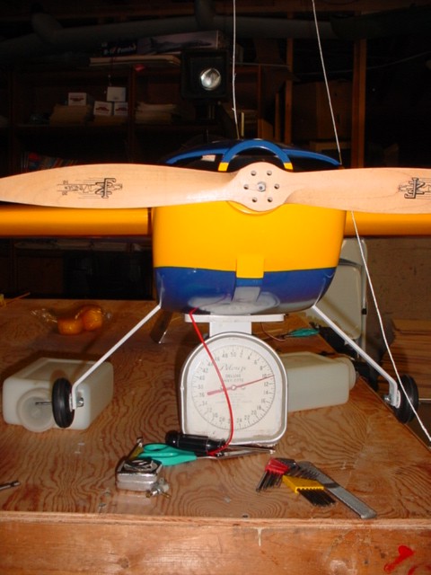

My H9 edge, has a RCS140 gas engine on it. Servos mounted as per plans, except that I added another elevator servo. Flight battery is in front of the fromer directly below the front of the turtle deck. ignition battery is up front behind the firewall.
weight is 12-1/2 lbs. apc (w) prop17 x 8 -, 8300 rpm.
Balance point 4-1/2"

I just did a retest on mine. I tied a string to the former in front of the spar, (no fingers this time!). clamped the engine, (Super Tigre 3000), to the firewall which is ½" further back then they call for, with prop but no propnut or spinner. I then put three servo's on the stab...still didn't balance. I then put the battery, 1100 mil, on the stab and it was just a little nose down! Weight is about 10 ½ # without wheel pants, reciever, throttle or aileron servo's, glue, spinner, extensions.

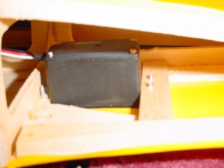

Definitely put two elevator servos in the tail... like you're already planning.
I wouldn't put the rudder servo in the tail unless I needed to for CG... which in this case you don't. The main reason would be all the glow goo it would get all over it. I'd put it in the stock location.

Yup, I sure do...the light little gasser is why you had no problem with balance. The Tigre 3000 is a heavy engine in my opinion. I did a rebalance at 4¼" and decided that I will put two servo's in the tail for elevator. I was concerned about the goo getting into the rudder servo if I mounted it under the fuse so I will mount it in the recommended location. (Thanks Joe)
I will use a Webra Bully for power and still have to mount the throttle servo back with the rudder servo and put the battery pack somewhere behind the cockpit to get it to balance.
Reason for using the Bully is that with the 3000 I was only able to get unlimited vertical, slow climb!, using a 16-6/10 on a 9 pound stick. With 10½ pound bird I'll need the extra horsepower to hang on the prop. Don't know which size prop I'll need to use yet. I'll keep you informed!

I too have mounted two servos in the tail. I have found that it works alot better this way. I run the saito 180 up front with a little nose weight to balance. I would like to know if anybody has had there edge pitch up when going to land. I have calculated the cg position on the wings and it is about 3/4-1" in front of what the manual states. Let me know what you guys think.

I had a H9 Edge with a Fox 2.4 Gasser on the nose. I installed three servos in the tail. Two on the sides for elevator, and one on the bottom for rudder. I used pull pull on the rudder. Worked great. I used Hitec 645mg all the way around. Great servo. This was a great plane. I lost it after I ran it out of gas. Everything else survived so I got another one in a box. Will build the same. I will have her ready in the spring. Here it is with smoke on. Enjoy.
