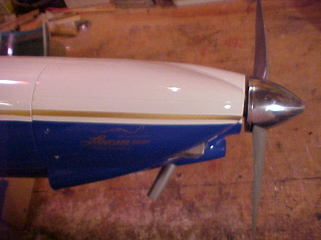

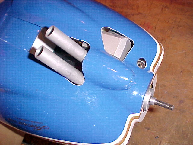

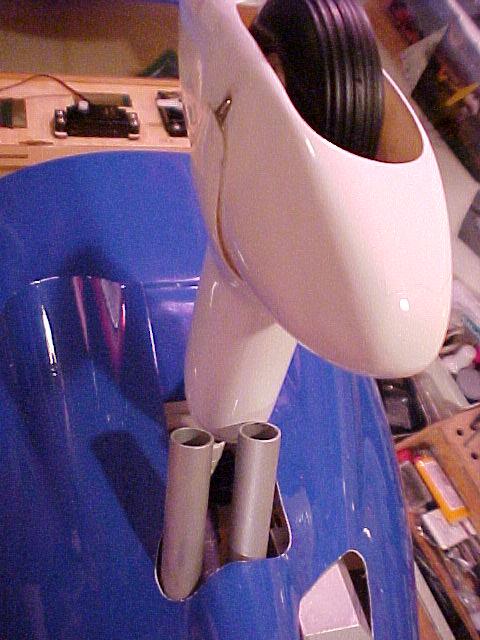

Got mine the other day and I will be using an OS .46 SF engine. The engine fits just fine but you have to cut a big hole in the cowl for the muffler. Anyone tried a pitts muffler. The Slimline Pitts muffler looks like it may barely fit without cutting any holes except for the exhaust tubes. I think that will look better than the stock setup even if you have to cut a small hole for the side of the muffler.
Old 08-30-2006 | 09:45 AM
  #85
Joined: Aug 2002
Posts: 690
From: Columbia, MD
Default RE: CMPro Lancair
ORIGINAL: iFLYrc_Vic
I found a thread on another forum that showed this Lancair with a Slimline Pitts muffler installed. I ordered a slimline for my plane.

Old 08-30-2006 | 10:32 AM
  #86
Hot Rod Todd's Avatar
Posts: 1,306
Received 25 Likes on 19 Posts
From: Robins, IA
I've seen some who have had problems with the slimline with a .46FX because it has very little back pressure. They have resorted to partially blocking one of the outputs. Depending on your tank location, maybe you will have no problems.

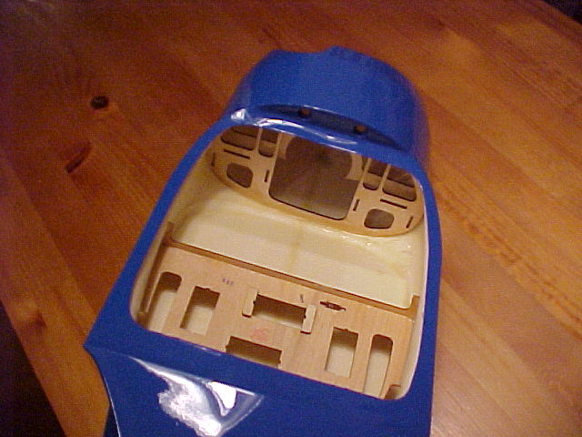

BJOR, one of us has a newer model for this plane from CMP. I just got mine a few weeks ago and my servo tray is different. They rotated the rudder/nosewheel servo 90 degrees and move it forward. The elevator servo is now located on the centerline behind the rudder servo. This results in the elevator push rod running down the center of the plane rather than from one side. I have another plane (GP Lancair) that has split elevators and if the push rod is not centered, the elevators deflect at different rates. At full deflection, one elevator has a higher angle than the other which will induce some roll (snap).
I suppose there were some complaints about this and they revised the design to get the elevator push rod centered. They added some plywood spacers for the rudder servo to raise the servo arm up enough so that the pull-pull wires don't rub across the top of the elevator servo arm. I had to add additional spacers to get good clearance. I also used some heat-shrink tubing on the ends of the wires prevent the wire lock (copper tube) from snagging on the elevator servo arm.
This is not my model but you can see the location of the servos in the servo tray. The instruction sheet does not show anything mounted in the outboard servo holes.

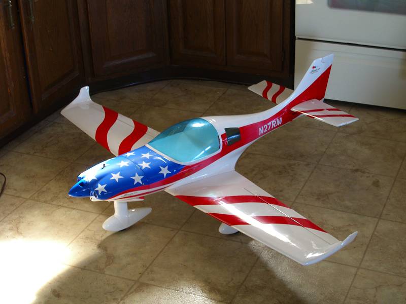

Just finished mine,
Came in at 6.2 lbs, RTF with OS46AX for power.
Have to say, for a buck, this is a real nice ARF.
Jim
