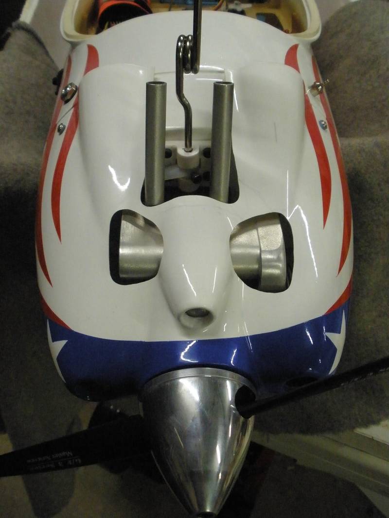

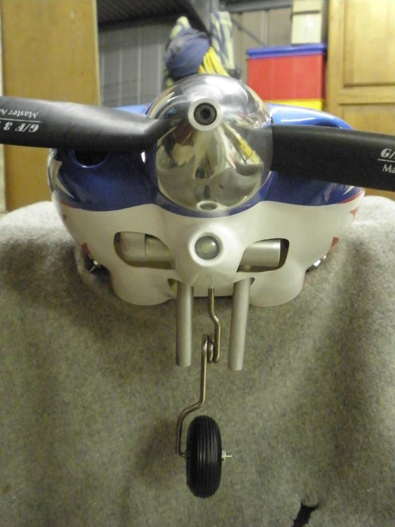

More on my Lancair. powered by OS 46AX with a pitts muffler. Prop 11x6 Master Airscrew (I would like to fit a wooden prop later for even better looks)

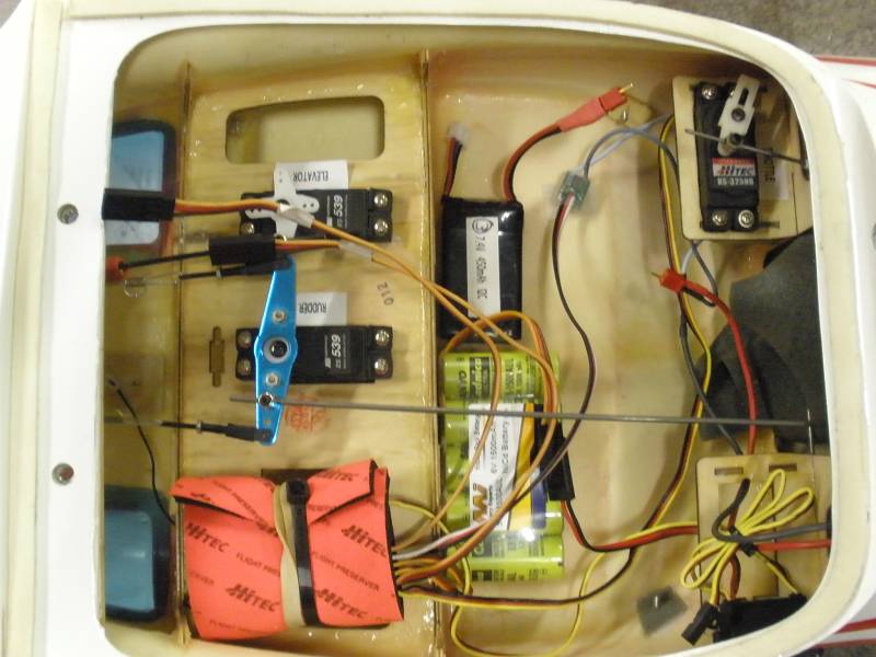

CG @72mm back. no weight needed to balance, just moved the 5 cell battery as far forward as possible. Throws elevator 8mm up & 8mm down, ailerons 0.5" up & 0.5" down, rudder 0.75" left & 0.75" right. Weight around 2.5 kg (I think-cant quite remember)
Radio JR PCM9X Synth with 10 ch PCM Synth receiver.
Rudder 70% exp on high rates with 60% low rates 20% exp.
Elevator 25% exp high 65% low rates with 20% exp.
Aileron 30% exp high 70% rates low with no exp.

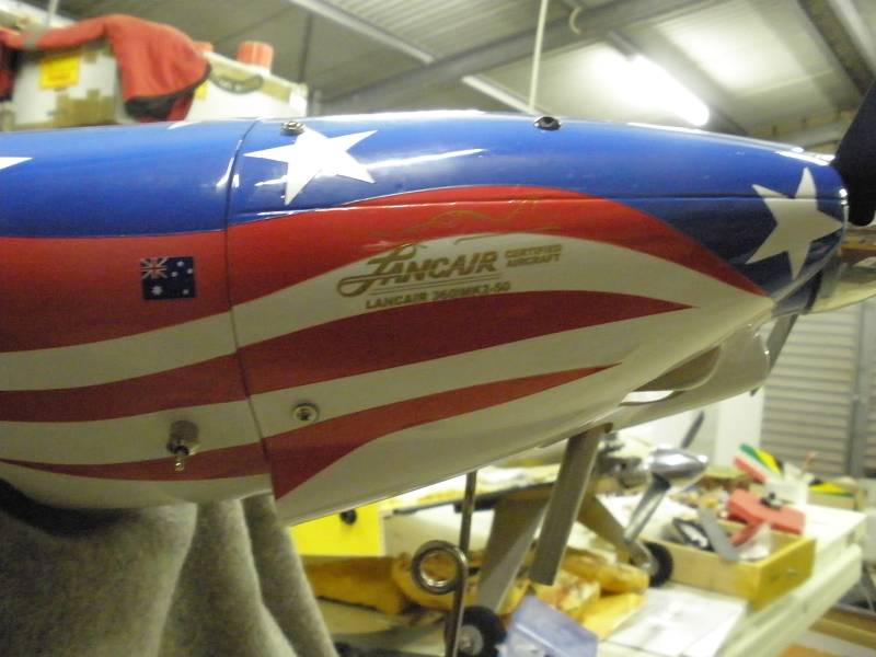

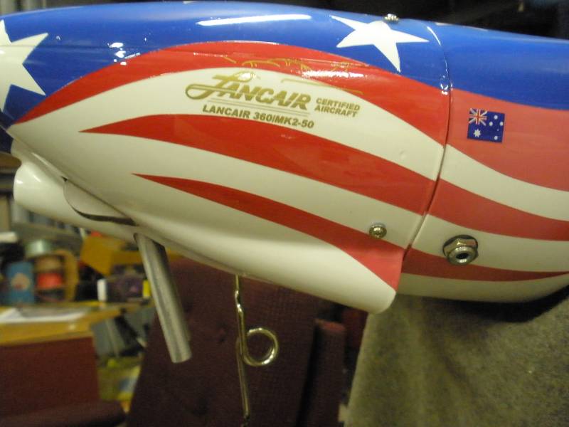

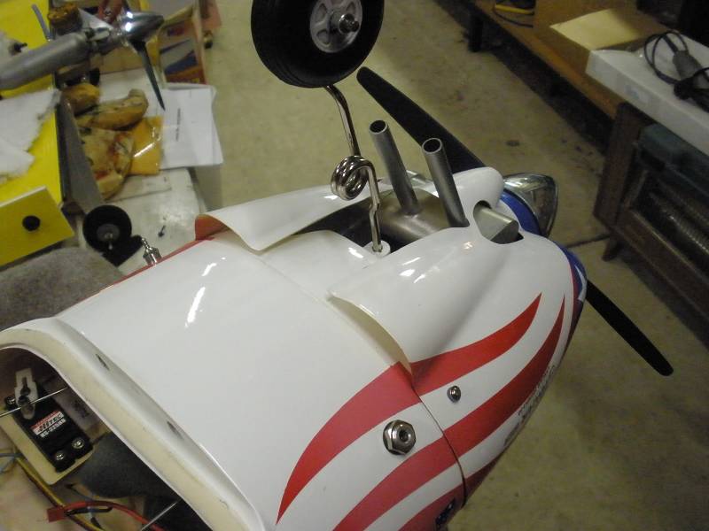

I fitted a remote glow & fuel filler so I did not have to put holes in the cowl. I use an allen key to adjust the mixture This fits into a small allen head screw ground down to fit the mixture screw.
I left the wheel spats off due to our grass strip.
Any questions please ask.

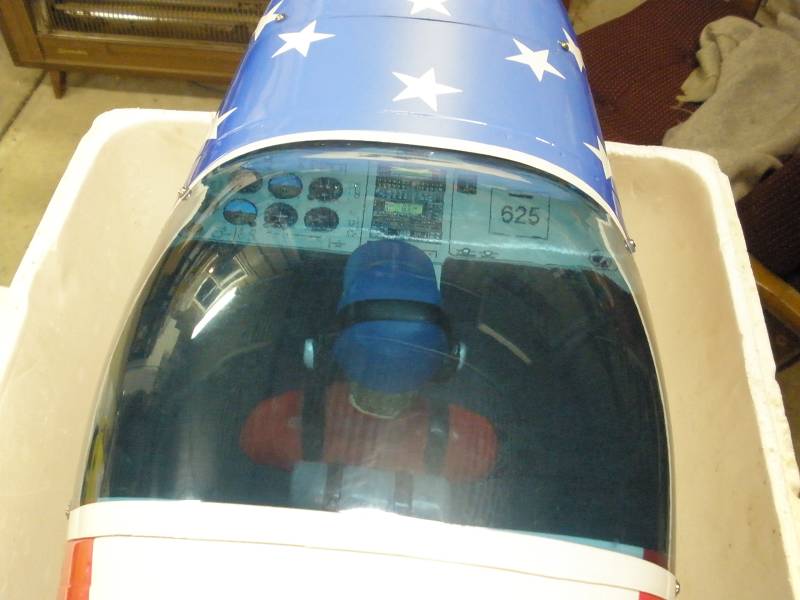

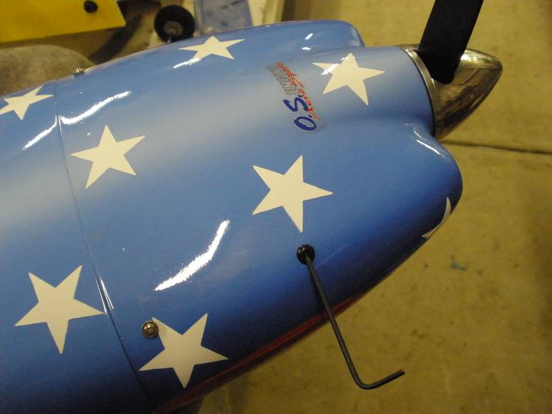

Some more photos, showing the cockpit- downloaded a pic of a Lancair panel U glued it in. Have to find a smaller pilot (hits the canopy if placed at the side).
pitts muffler, fuel & glow remotes, control fitout, note the landing light (super bright LED in the nose-it switches on via a nano switch & lipo battery with series resistor) on gear channel.

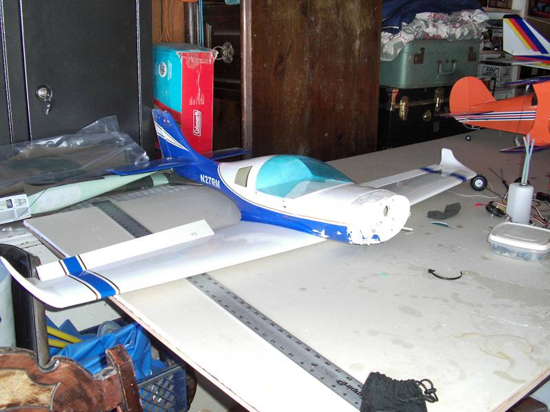

My lancair died all electronics removed from plane and engine. Will post pics later. Whatever you do make sure you have a good running engine this plane has no glide Ratio and mine dead sticked and hit the ground nose first. For the most part the plane is intact. Good bye to the lancair. i wont be rebuilding this plane. Oncew a plane is gone its time to move on.. Good luck with yours..[&o]
For the most part it still looks like a plane but all the internal wood was destroyed in the front and some in the back. A large hole is in the wing inside the fuse. I'm gonna patch it up try and make it look good again and hang it. My first Plane i nosed into tthe ground. And if someone shows intrest in it. and has the fiberglassing repair abilities that wants to take onthe challenge of repiring in i'll sell it to them cheap.lol
I myself dont have the know how on repiring fiberglass plus the would have to make all the wood components that go in the front that hold the tank and throttle servo and such.
#280
Bad news linkadrip. Sorry to say I saw this coming myself thats why I retired mine while still in one piece.I have to agree with you when you say good luck to those still flying them.
