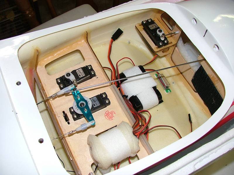

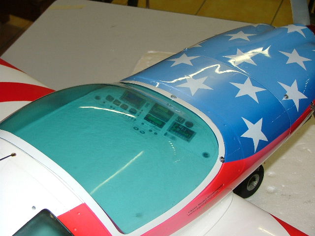

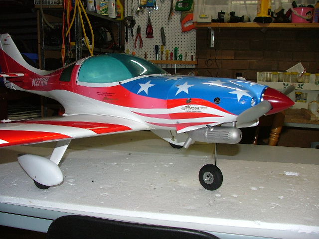

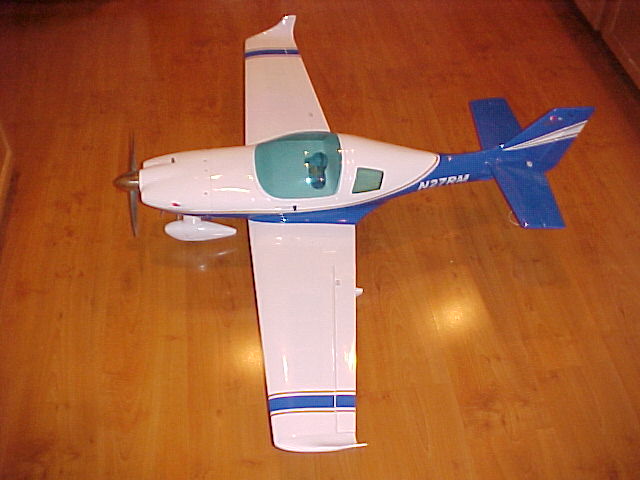

Here are some pics of my beast
I added the red solarfilm to the bottom of the wings to make it easier to see in flight. I've also removed the front wheel pants to make grass take off's / landings easier. The interior is spacious so playing with the CG is easy especially with my battery pack covered in Velcro. I placed a Rx battery monitor / indicator in the cockpit for easy viewing prior to each flight. The cockpit layout was printed from the net and printed onto photo paper and glued in place. The only thing i would have done was to fit a remote glow plug - no need for a whopping bit hole in the cowl.

Finally got my electric Lancair flying. My early flights were not too fun, since I set the CG at about 72mm. Keep in mind that I have no fuel to add into the nose, so it ended up being quite tail heavy. I repositioned my battery and ended up at about 67mm. The plane now flys excellent, and is everything I hoped it would be. It is very fast and climbs like a rocket. The plane is not light, but lands fine with a bit of speed on a hard surface runway. Full throttle is not needed often, and I can get about 10 minutes of sporty flying using a 5-cell 3700 mah Li-po. The 4120/14 AXI outrunner pulls the APC 12X8E prop at over 10,000 rpm static. I removed the front wheel pant after a couple of rough landings due to the rearward CG, but it is back on now. Here are a couple of photos.
