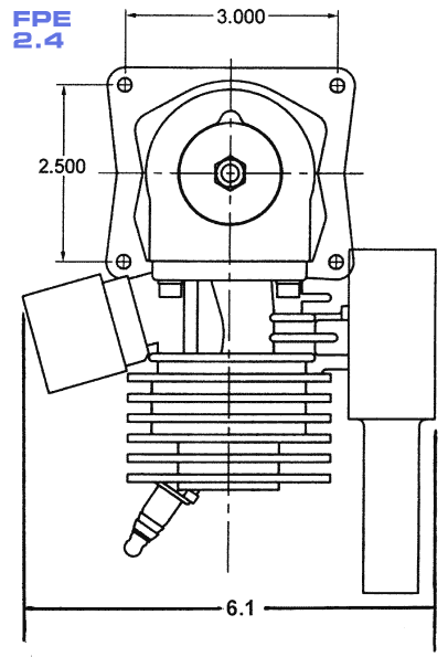

How about a 40cc First Place engine?
High quality made here in the USA, and looks like it would be a great fit too!

Good little engine for the money. I think you'd find performance and fit similar to that of rslstft's setup. Enjoy!

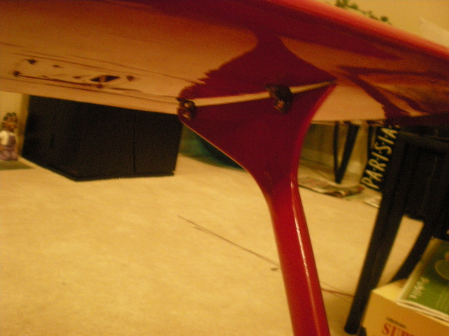

Check these photos out, look at the gap on the struts and the wing. One side it is almost tight, the other is a difference in about 3 or 4 mm. Will this make a big difference in flight?

Almost looks like one of 'em is installed upside down. Either that or the L-brackets weren't installed flush with the edge of the strut.

They are installed properly and the L brackets are all flush as they are going to get. I drilled the holes to high on the right strut, do you all think this will effect the flight. Towerhobbies sales new struts for $11. I can buy them and drill new holes.

It'll more than likely affect the first flight but once you're trimmed out you may not notice anything further. It doesn't really change your wing incidence but there would be an imbalance that would probably require some counter aileron trim and/or possibly a little rudder trim to level the wings in flight.
If it were mine, I'd probably just take my Dremel and elongate the screw hole in the L-bracket to a slot so it could be repositioned flush with the edge of the strut.

The other alternative is to fill the hole in the strut with epoxy and redrill.

I was thinking about filling it with epoxy and then drilling it again. I will do that!
