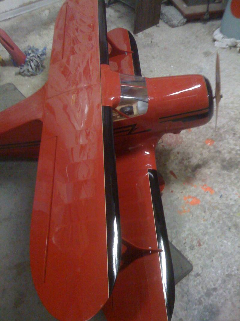

I took a couple of pics from the iPhone to show the painted Leading edges with Gold Pin-Stripes - exactly like the factory stripes are!

Nice! I like the leading edge stripes! Can I send you mine and have you paint it?
Look forward to hearing your flight report. Good luck!
I don't think you can afford my painter.
He thinks he's Michealangelo with a paint can - you get it when you get it - but it's gonna be perfect!

Painting the leading edge isn't all that difficult, 3M fine line tape, scuff pad and an aerolsol can of black fuelproof paint. Mask with newspaper.
Or, I could provide four pieces of black vinyl which can be used for the leading edge. Bottom piece would go on first and require trimming then the top piece can be applied. Ultracote or another iron on material could work also.

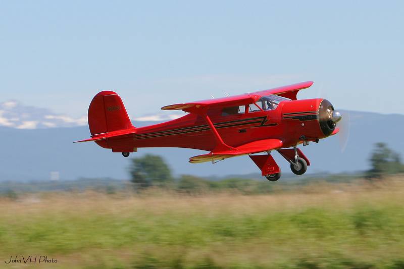

I know that some/most/all of the S.W.'s didn't have the painted LE's, but I was at Hobby Airport here in Houston a while back and saw Howard Pardues S.W. at the HawkerBeech FBO. His has the painted LE's and it just REALLY stands out from the others. I'm glad we did it - it was worth the two hours it took to do it!
No fit or clearance issues with the 1.80 unless you consider the two small oval that we made in the cowl to clear the rocker arms an "issue"? Take a look at that Keleo Creations Muffler - REALLY NICE!
Yes, I just finished balancing it at the recommended 5.5" from the LE of the lower wing.
It took an additional 2lb 3oz of lead weight to bring that number in!
Originally I was going to use a 4000 5-cell NiMh battery (wieghing 11.8oz), but after realizing that I REALLY need an on-board glow system for easy starting and reliability (plus the additional battery pack) I decided to down-size the main pack to a 5-cell 2700 and then have a 4-cell 2500 on-board glow battery (12.2oz total).
As you can see I made an aluminum shelf to mount the batteries and the lead brick.
The lead brick is UNDERNEATH the aluminum shelf, mounted with 4ea #12 self-tapping screws, and then the batteries are stacked on top and velcro'd into place.
With the shelf there would not have been room to mount the second pack on top of the main one, so down-sizing helped save room and overall weight, too.
I'm just about finished with the dummy radial and will see how much the balance changes with that installed. I may go to a wood prop to offset the extra couple of oz's.
I hate it that I needed to mount the switch and glow system in the forward stripes, but I really didn't want to run any more long extensions just for that.

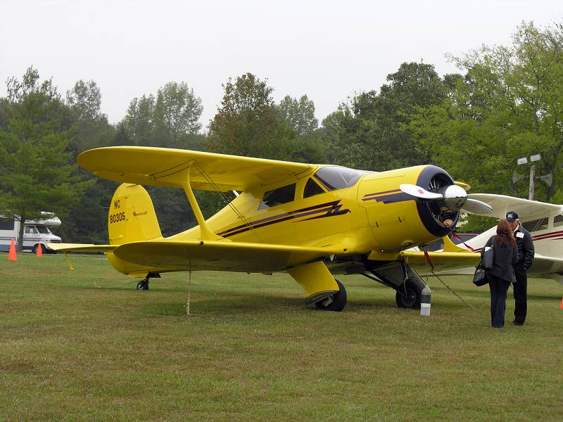

#793
ORIGINAL: mobyal

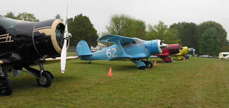

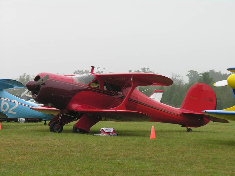

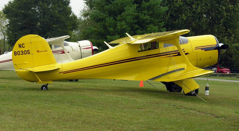

The leading edge trim looks nice, but it wasn't on all (many?) of the Staggerswings. Attached are photos of two G models...

Yeah. I agree about the yellow one. I like that one the best too. If you buy another kit and have it finished in those colors let me know and maybe we can get a discount for two of them! LOL Seriously, that kit is so good I really have been thinking of getting another one just to have on hand and would jump at the chance to have a yellow one..
I took those pics at the Fall flyin at the Beech Heritage Museum in Tullahoma TN in 2005. The yellow one belongs to a guy named Jim Gorman from someplace in the midwest. I think Ohio. The red one is "Big Red", and it belongs to the Parrish family, the prime movers behind the museum. They live on the airport property! But Big Red is with one of the Parish sons and currently is based near St Louis at Creve Coeuer (sp?) airport, I think.
I appreciate the pics of your engine installation. I already have both engines (OS 160 and Saito 180, and the metal mounts for each. I'll mess with both of them and try to figure out what to do.
I'll attach a few more pics, some of SWs w/ the painted leading edges and one more of the yellow G17.
Damn I do love the Staggerwing. Even got a couple of hours in one at the 2003 flyin.
