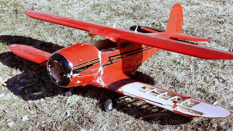

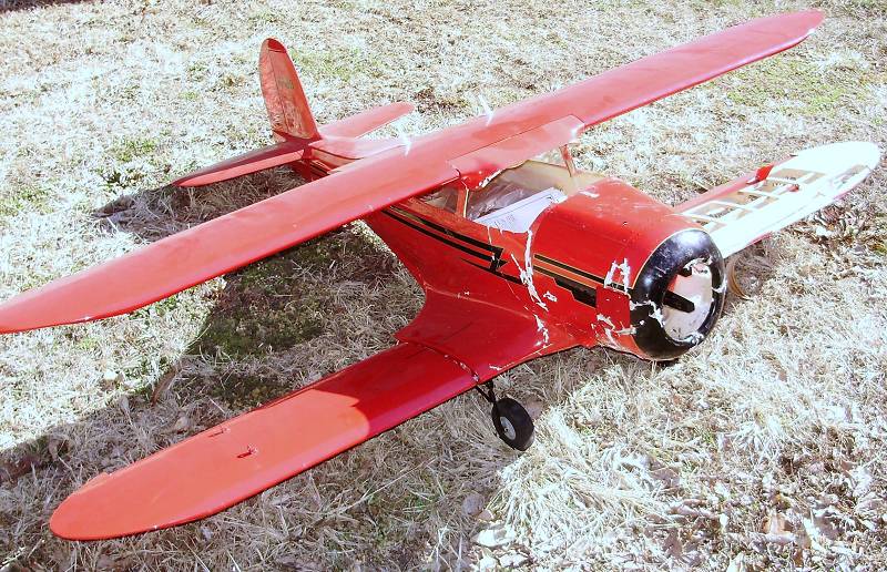

From the ashes ....
A fellow club member lost the 2+ lb lead ballast mid flight. He said it became rather unstable and at about 10' it nosed in. Makin them fly again has always saved me money in building up my fleet. For $60 I thought it would be worth the effort. Sending $40 to Tower, I've got new windows and cowl. On a trip to O'Reily's with a scrap of covering in hand, found a perfect match in a "truck and van" paint. Years ago I swore off that so-called MonoKote match stuff.
I too was thinking of the 2300 as a replacement to his Saito 180. I'm using a 2300 on my Midwest 72" Giles which gives it decent power, but after lifting the Beech, I'll be going up to the 3250 or a CRRC gas to cut the lead req'd down to a few ounces. This thing must have flexed like a pretzel on impact since ALL the bulkheads were broken or separated from the fuse walls. Since I fly off grass, it was good to read here that the gear doors might not survive. Guess they'll be a static display feature only.
Hope the photos aren't too large since I'm learning a new digi camera and laptop. I think I missed the resizing step and can't seem to backtrack and correct.

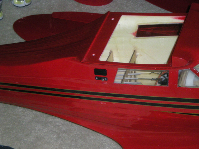

Default RE: Top Flite Staggerwing

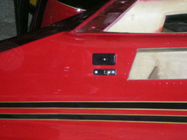

Here is my on and off switch and my remote glow starter. My engine should be in tomorrow, I will post pictures of that once it comes in.

Wow Randy! You've really got your work cut out for you. Be sure and post pics of the repaired bird. Glad it's being salvaged instead of going to the Great Hangar in the Sky.

Lookin' good rowdog. Hope your engine gets here on schedule.

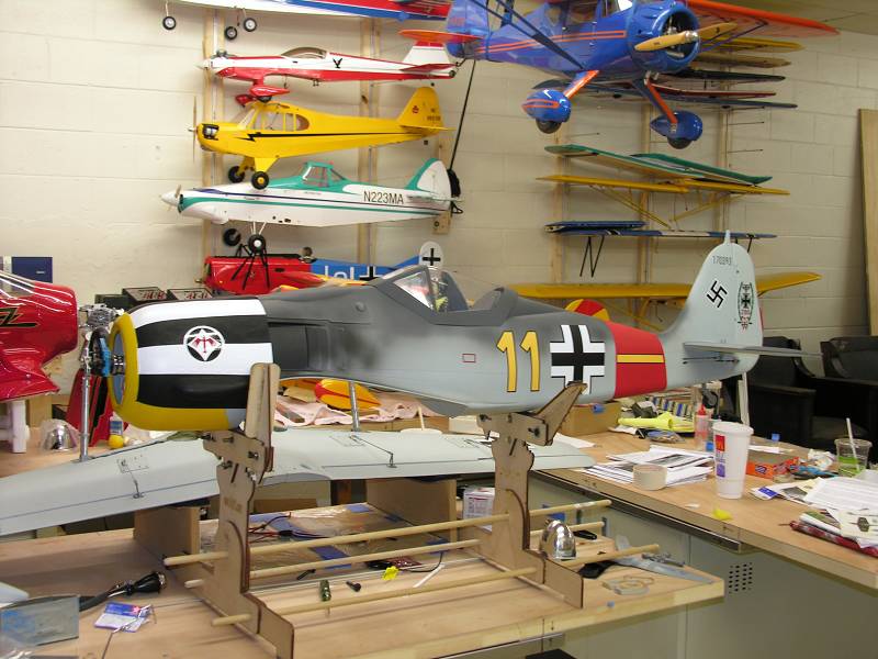

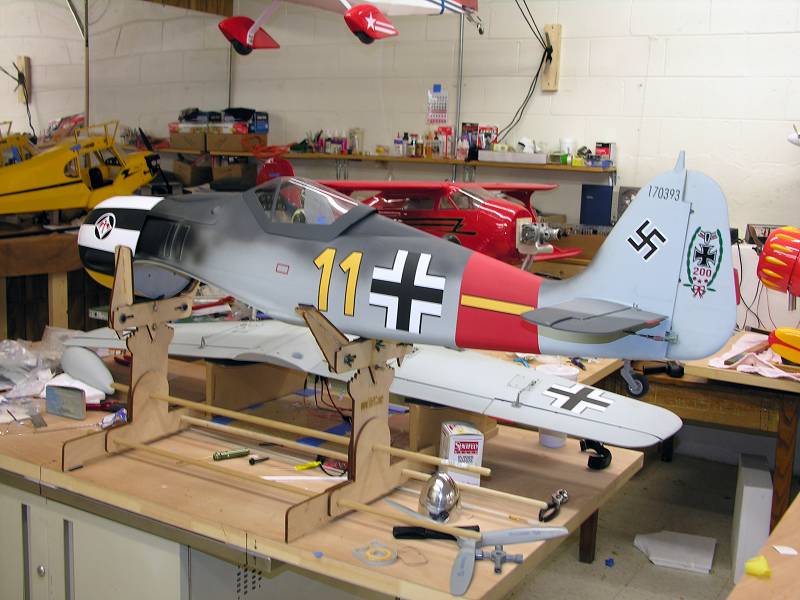

I have the wings finished and mounted. Has anyone made the top wing a one-piece wing? Seems to make sense to me, and I use a Tahoe for transport so don't really need the two-piece wing, and it'd be stronger, I think. Just wondering... The engine is mounted; I have a 1/4 ply spacer behind the mount. Need another 3/16 spacer, but will need some longer mounting bolts than those supplied w/ the OS metal mount. I've ordered the Beech logos and wing "N" numbers from Charlie. Retracts are next, then horizontzl stab, elevators, rudder and tailwheel. That ought to do it!
Taking a break from the Staggerbeech to get back on my KMP FW190A. The Staggerwing and FW 190. My two favorite airplanes. My cup runneth over!
Al
As I said, my cup runneth over! You can see (sort of) the Staggerwing in the background of these pics.
GaGeeBees. I agree w/ your thinking on the two-piece top wing. But one (more) advantage to making it a one piece wing is that I can get rid of that ugly seam on top of the two-piece setup. Still thinking about it tho.
Al

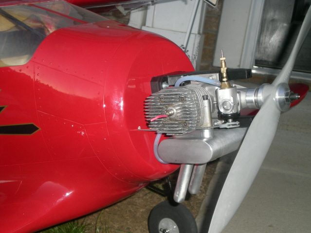

Here it is. All I have to do is balance it out! Good luck to myself trying to keep it lower than 17lbs . LOL

Congrats on getting your engine mounted, rowdog. The installation looks good. Hope it balances for you at your target weight.

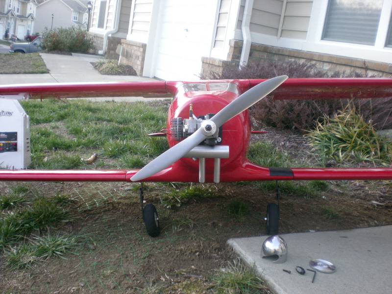

Right now I am at 15.4 lbs. I moved the engine up .5 so instead of 6 inches from the firewall it is 6.5 this should help with the balancing. I am also going to put the battery above the engine. I will probably balance it next week.

I actually weighed it again it comes out to 14.4 lbs. I weighed it with three different scales. This is with everything engine, servos , battery, etc.

No I have not balanced it yet. I moved the engine up about 1/2 inch and I am going to put the battery above the engine. The battery is a 3000mah jr. I should be able to keep it right at 16 or 17 after it is balanced. I do not have retracts installed so this is saving a lot of weight I do not plan on putting them in yet I want to fly it first. I am taking it out to the field today to run the engine. Most people with a 16x8 prop are getting about 19lbs of thrust out of the super tigre 2300, and top flight states that it will fly it, and on the review the gentleman said that the OS was almost to much power. Yes, I would rather have to much than to little, but I do not think top flight would advertise the super tigre with it if it would not fly it, and I am on a really tight budget with this. So far I only have about $600 total in the plane.

After running the ST 2300 and the OS 160 there is a night and day. The OS running sloppy rich turns a 18X10 MAS like it is not even there, the ST 2300 on the 18X6 sounded like it was trying to get more. The ST 2300 rpms with the 18X6 was about 7800, I did not tach the OS but it sounded like it was swinging it a lot faster!!! Thanks everybody, my wife finally talked me into it. She said better more than enough than just right.
