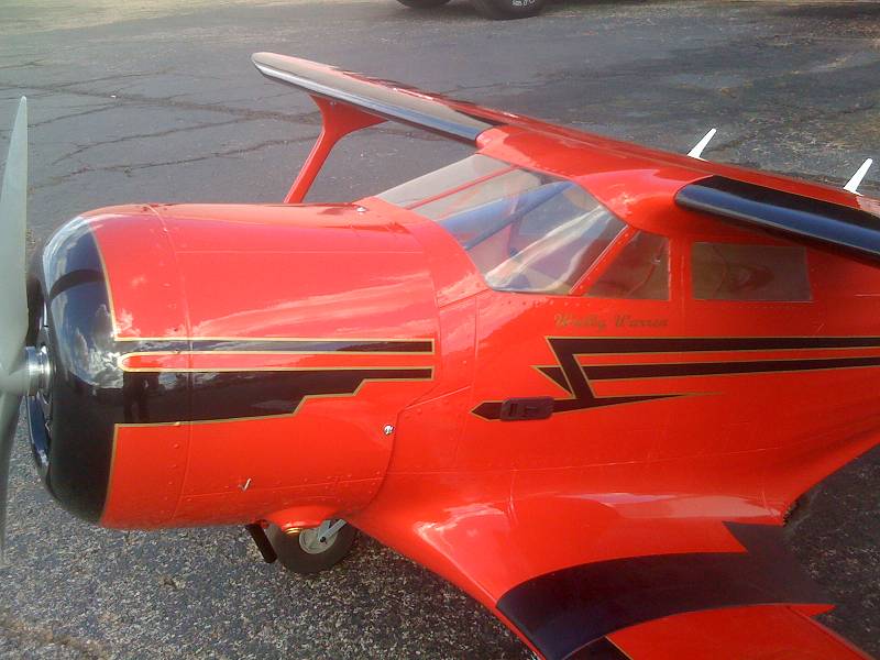

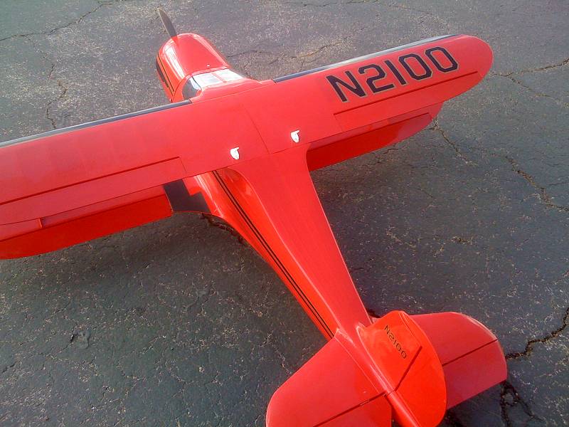

I also got the "N" numbers on the wings. Took a while to dry last week when it was in the 40's in the hangar...
Will take some beauty shots when I get back from my trip tomorrow.
Heres a low res iphone pic till then...

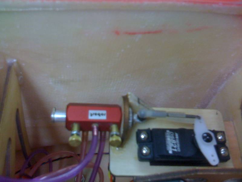

BTW... Is it just me that's had a problem with the strength of the retract valve mount?
I hit the switch last week and the horizontal plate just cracked where the vertical mount glues into it! I just epoxied a piece of triangle ply on to solve that problem. Now to find the next weak link!

Had the same problem with mine and did the triangle stock reinforcement too. One annoying thing about my Spektrum system is that it cycles the retract channel every time I turn it on. If there's a way to get it to stop that, I'm not aware of it. It also seems to ignore the end point settings as well when it does this, so the servo is going maximum travel. Anybody else experience this?
Good shot of your wings and N-numbers. The gold pinstripe is a nice touch. Maiden flight this weekend?

Theres a fellow at our flying field tat had that same problem: He was upset as he called Spektrum and they told him just to deal with it.
Now I work at a local hobby shop and know that Spektrum/JR has pretty good customer service: I told him to call back, ask for a supervisor. He did and received an answer and a fix for the problem, now all I have to do is remember what the answer was.
So:::: sit tight: I will contact him today (the 5th) find out what he did and send a message before the day is out

O.K. Gang: here's the scoop on the Spektrum/JR retract issue
The folks at JR say (drum roll please) you have to bind you're transmitter to receiver with the retract switch in the DOWN position as well as your landing gear also in the DOWN position. That way when the units are switched on it will recognize the gear as "Down"
see if that helps !!

Okay, you may now picture me slapping my forehead while asking "Why didn't I think of that??". I'm going to test this right away!
Thanks so much for the info Denis! Most appreciated!

IT FARKIN WORKS! Just went out and froze my butt off in the garage... er hangar... and did a rebind on the Staggerwing's Rx and viola! No more cycling of the retract servo. Thank you very much Denis!

Also one of the "fix" for the air valve issue.
I did the re-bind with the 12X and it worked perfectly. Thanks again Knuckle!
