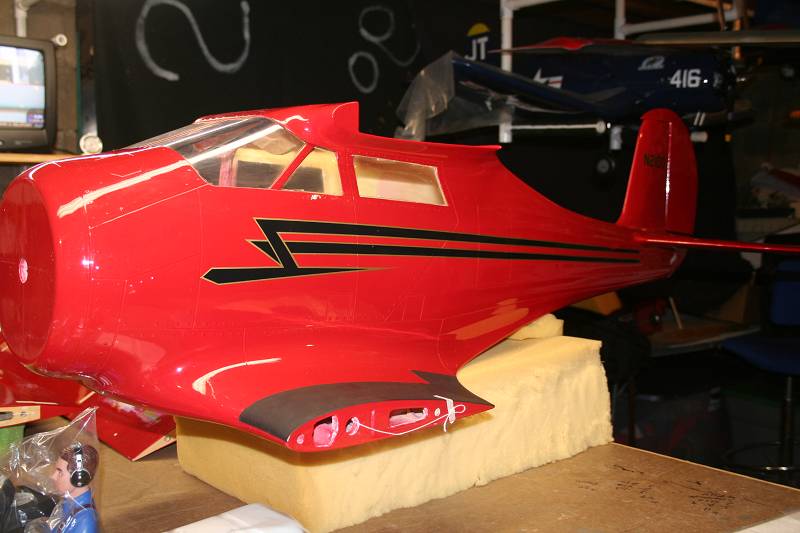

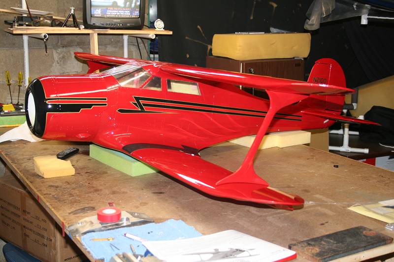

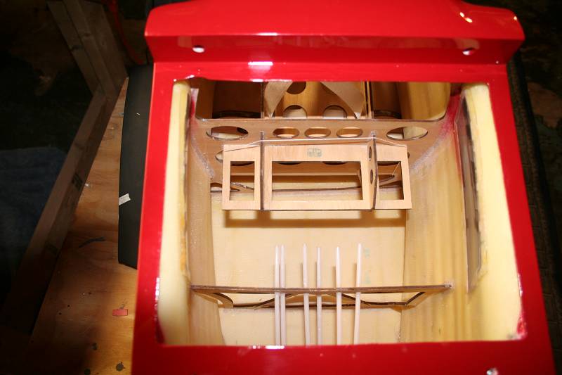

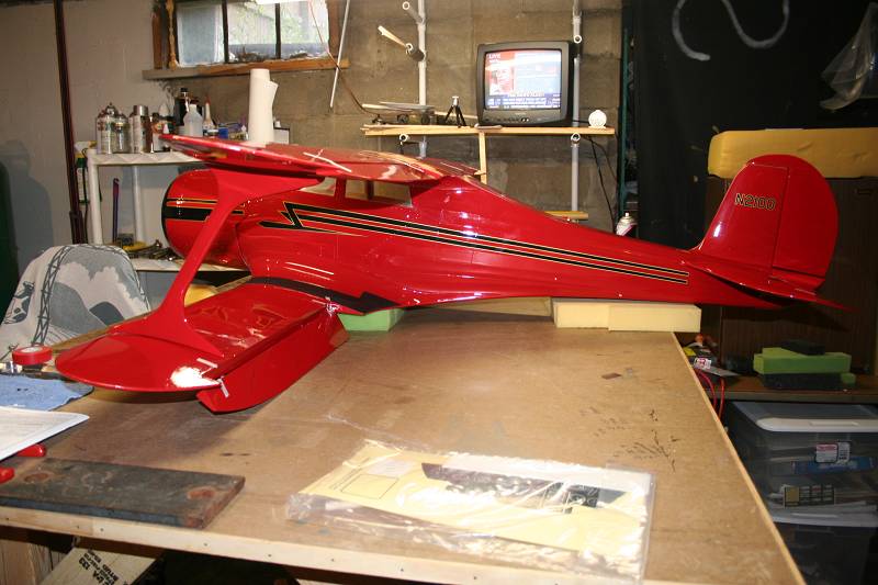

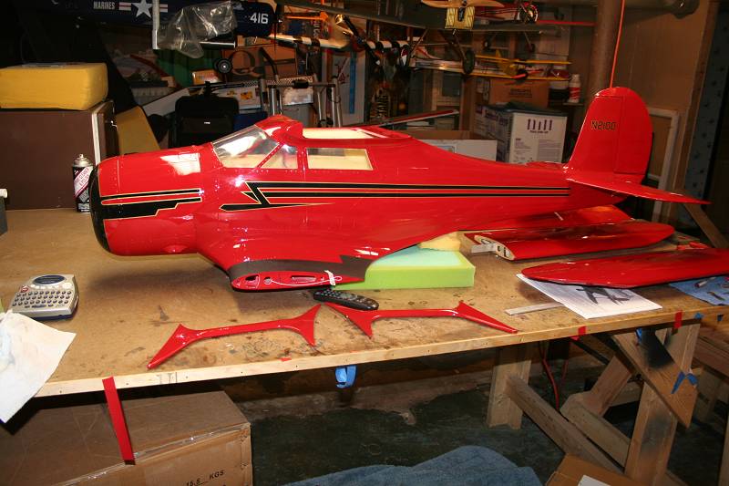

I will try to post a few pitures. If this works I can post more if you like.

It worked let me know if you want more and of what part of the plane.

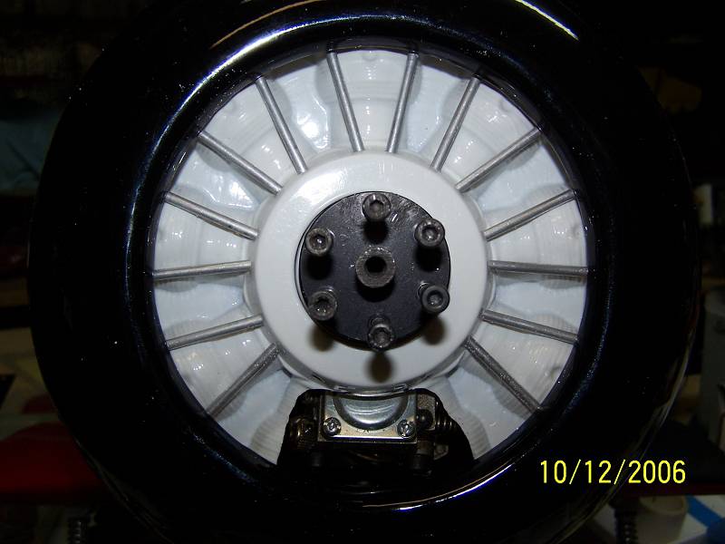

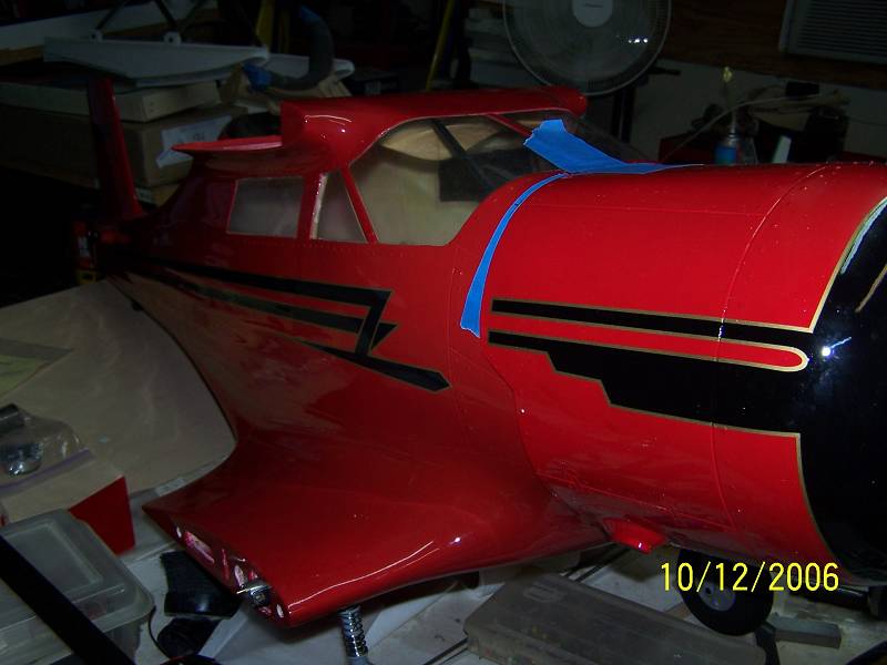

It seems that I did need to raise the engine 1/2". The pics show the cowl and dummy engine aligned to the side graphics and prop shaft. I also needed to shift the engine ,facing the firewall, to the right 1/4".

Yiour pictures seem to show that you mounted the 180se inverted. Is that correct?
According to the RCS website, the 180se is 5" from the prop centerline to the top of the plug. My Saito 180 is 4.4" so it should work inverted, also. Did you try to mount the 180se at 90 degrees? Do you know how much room there is for a 90 degree monted engine?

From: Etiwanda, CA
Default RE: Top Flite Staggerwing
jimmkeeh
Your right! The engine is inverted. I'm sure all the cowls are the same shape as mine and with that being said you'll notice that the cowl isn't round. The bottom drops down a bit giving a little more room for the inverted position. I don't think you'll find the same room horizontally. However your engine is shorter than mine so you may be able to sneak it in. Now there's the consideration of cooling. The cowl is too tight against the fuselage for that. You'll need to make a hole. I wanted mine on the bottom. After all a lot time spent in admiration of this beauty will be on the ground. The unsightly hole won't be as noticeable to the ants.

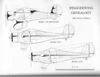

Some different versions, notice the gear doors.................
