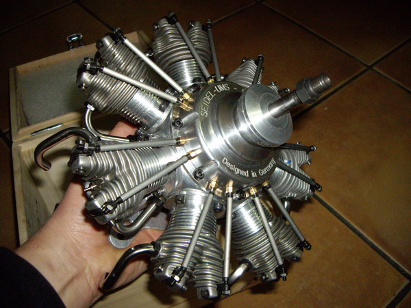

I picked up a 7-cyl 70cc radial engine.... as it was the same price....
This pict is not my engine, as it will be here in a couple 2-3 weeks....
I have thought about taking the Cowl on this plane and making the version that has the Wacco type round cowl
THe radial would then fit....
What is the max 2-blade prop one can fit on this one???

Re the prop size, what is it? Hard to answer without that information...
But looking at the size of it compared to the hand that's holding it, looks like it's way too big to fit on the front of the Top Flite Staggerwing. Maybe a Ziroli.
Remember, this airplane was designed around the OS Max160 2-cycle.

Will a 22X8 prop fit on this Plane....????
a 1.60 GLOW plane is was guys place 50cc gas singles in...
20 Inch prop???
18inch prop?
Does anyone know what the biggest prop you can use ?
Thank you..

I use a 20 x 8 and have plenty of ground clearance. 22" shouldn't be a problem.

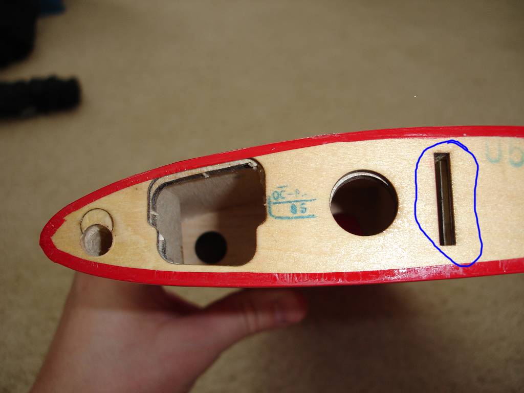

I went throught my entire plane today....
everything went great except for one thing....
The bottom right wing had the endcap placed on it incorectly, causing alignment issues....
Being the bottom wing is already discontinued, I can only conclude that they
had issues with this on other beeches..???
I am going to call them up tommorow and see what we can work out....

The fist pict shows were it should have been cut (they outline it...really paying attention there worker!)
the best part is the QC stamp on the wing in green!![>:]
The 2nd show how it looks....
I can take the end hardwood off the wing, and move it to the appropriate
place, ( where the factory worker should have placed it!!)
for a great OEM looking fix...

Re the wing. This happened to a few of them early on and is discussed towards the front of this thread. There's a relatively simple fix. Just cut a piece of ply to the correct shape and epoxy it into place behind the improperly drilled hole. I used a few pieces of bamboo skewer to pin it in place. Once it cures, drill the hole in the correct location and you're done. Problem solved. Took about half an hour not counting cure time.

THanks for the advice. I may have to take the end cap off...I wish it was just the antirotation rods...
THe circled area is also off....were the Alum. Rod slides in..
