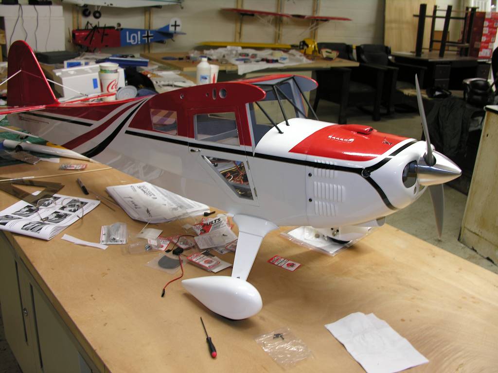

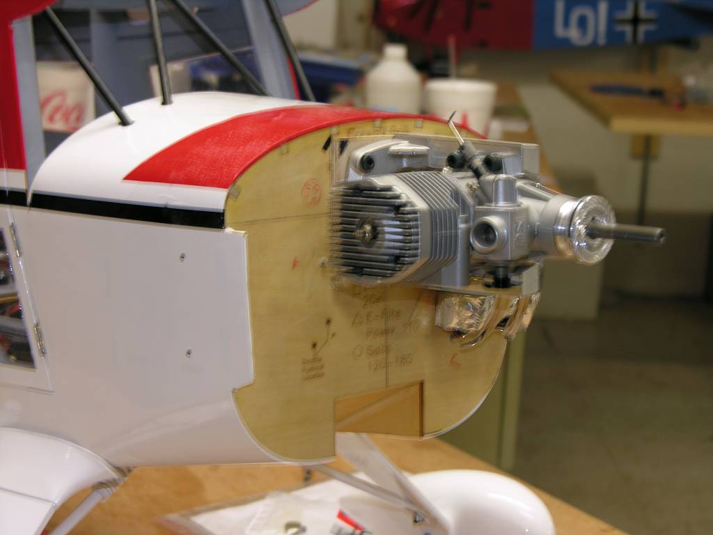

That G23 sure looks small in there! Looks like I may have found a home for the G26 I have. Many thanks Dick for taking the time to post those pics!
FB

Thanks to you, Dick. I'ii go with a G-26
Alex

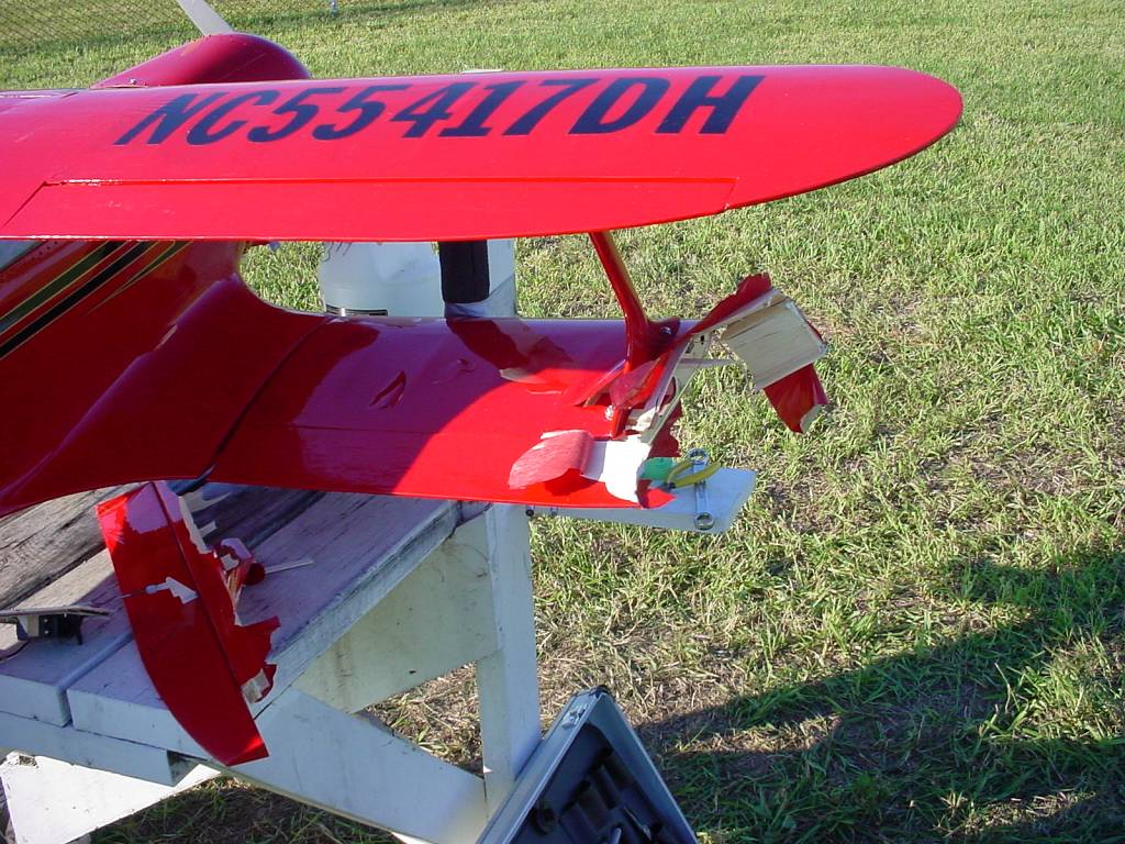

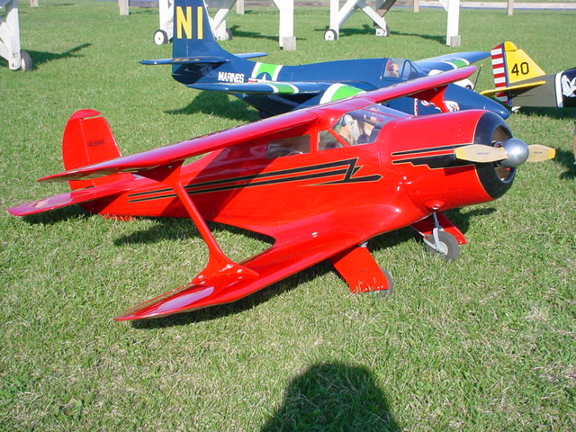

Hi all. Just found this thread. (Wasn't really looking hard. ) I wanted to comment on kochj's statement about the motor sizes. I bought my Staggerwing when I saw it was flyable with the OS 1.60 Gemini Twin. My motor has serial number 582 on it. I WANTED this plane. When all done, mine weighed almost 25lb!! [X(] It was marginal on take-off. Once up and flying with an APC 17x8 prop, which turned out to be best for my area, it flew great. But that marginal take-off power was it's undoing. The Robart struts bounced so bad that a rough spot on our runway sent the plane airborne before it was ready, and it stalled and cartwheeled, requireing a new set of wings. The tail and nose never touched, ironically. Also required a new leg for one gear assy. After the repairs, I electrified mine with en E-Flite power 160, on 10S 20C 4800mph Impulse batteries and a Phoenix 110HV ESC, swinging a 20x8 Master Airscrew wood prop. It now weighs 21.25 lbs, and climbs vertically on take-off. 95mph flat pass, no dive or wind, on radar. Most of the flight is at half throttle. I get 5-7 minutes, depending on throttle control and routine flown. It will do the full routine, except I never spin/snap it, since parts are no longer available.
A couple pics of crash damage, and as it is now. Yes, those are my planes in the background, also. All electric, also.

Wow.... Crazy...
Those wings would have been a chore to try to fix!...
The flying you described, is what I would have expected...
You could power most anything with marginal to hardly anything at all, and once it was up a flying, things can go pretty well...
It is when you get into trouble, the extra power in neccesarry to get you out...
Seeing those wings, make me nervious to fly mine now!...[], because parts are nill...

I have no recent experience with gas motors, my last one was a Quadra 50 back in the '80s. However, over on RC Groups, there is a thread stating the Staggerwing does fly with the G-26, so... Maybe someone with more experience on them will jump in here.
The Staggerwing is a great flyer, but it needs speed, especially on take-off, so the motor needs to have excess power. I do not recommend marginal, or bottom of recommended size. You will NOT be saving money. Parts are no longer available for this model, and it always comes out heavy.
Old 06-09-2011 | 08:58 AM
