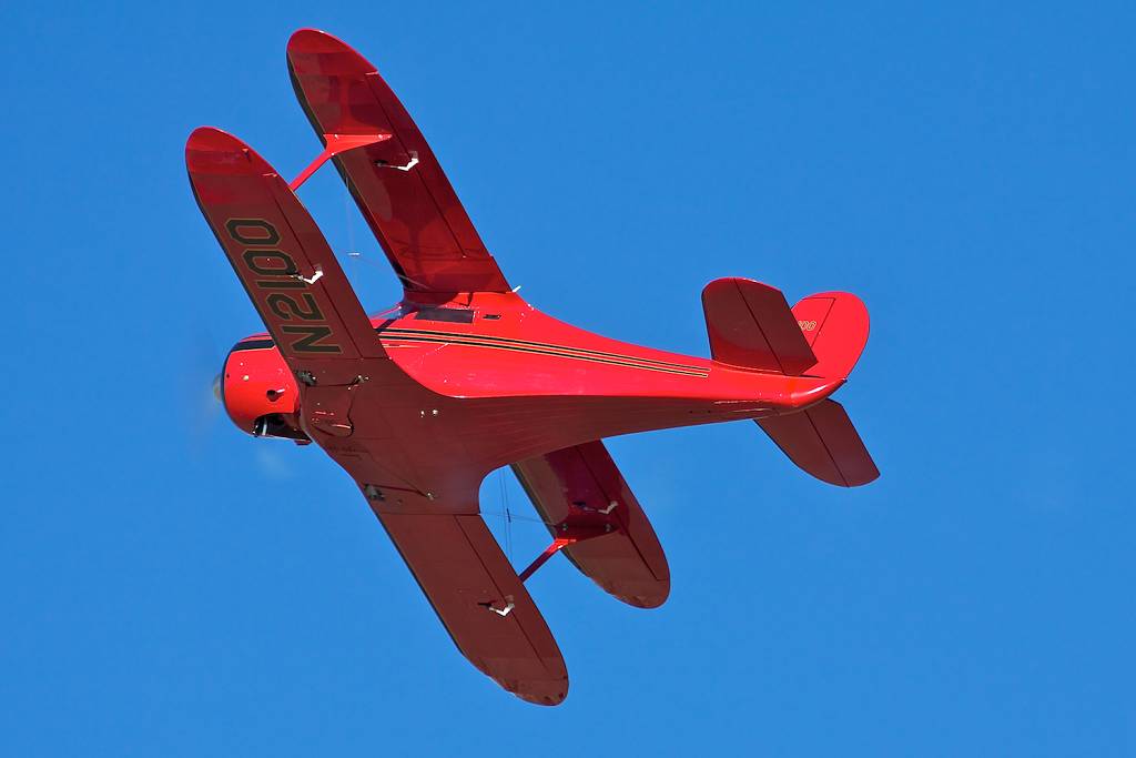

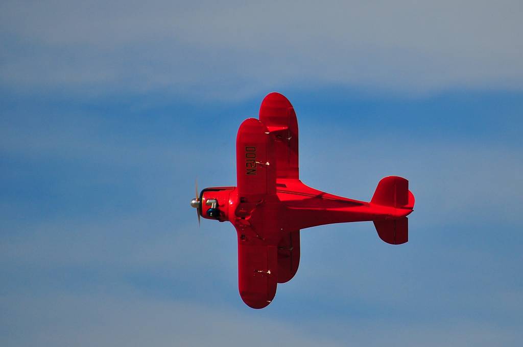

I agree with Paul, mine flies "heavy" also. I prefer to keep the speed up and in the landings too as she does slow down quickly. The flaps work well, with very little elevator coupling needed. Mine seems to need quite a bit of rudder in the turns to make them look good, I'm not sure about others. Paul? I have the Robart retracts in mine and haven't had even 1 little problem with them in over 100 flights, and they seem to make a good bit of speed difference when retracted. I've heard one of the local hobby shops has one in stock, may check into it as this is one of my favorite planes. Good luck and keep us informed.

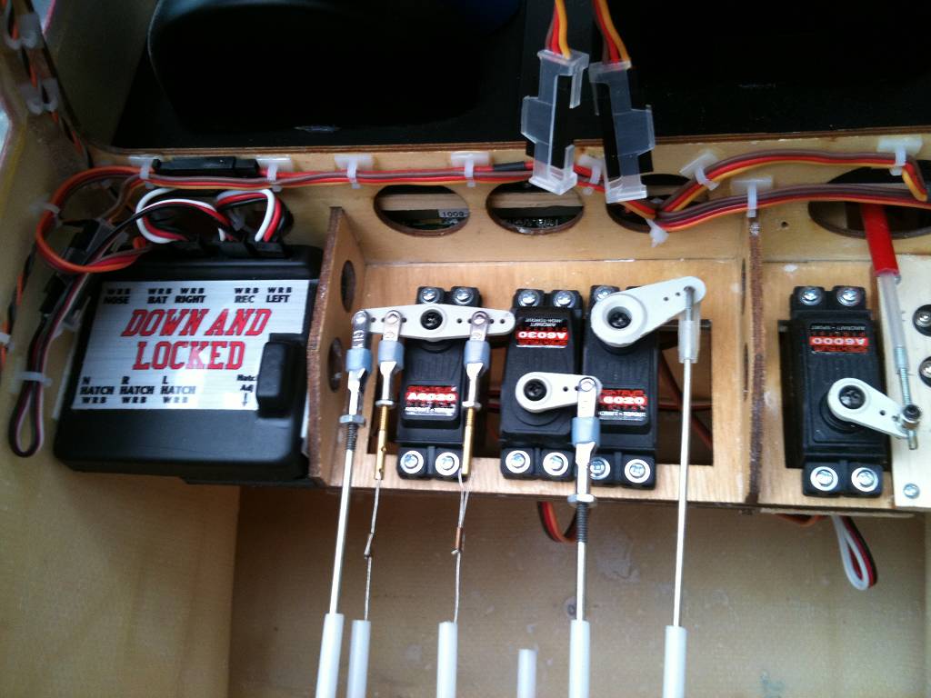

Hi to all in this "Thread".
This is the "link" to the video of my "DOWN and LOCKED" retract conversion on my T/F Staggerwing.Still awaiyng good weather to maiden her.............
http://www.youtube.com/watch?v=MVm7P98gLqE

Hi Al.
DOWN and LOCKED conversion...........Not too much had to be done,with respect to modifying,I just made sure that there was enough clearence ( by using the "dremel" ) for the "modified and extended Robarts"all around the actuator.This is because the "wires" from the electric motors have to move backwards and forwards as the motor runs back and forth as the screw jack turns.........Don't want any rubbing here on the fibreglass in the fuzz or on the plywood in the wings !!!! The "pocket" in each wing that the "Robarts" protrude into are deep enough as standard to allow the "extended Robarts" to fit easily.Mitch of D & L,made me aware of the extra depth that would be needed when I sent him the photos of the STD pnuematic set up.
I assume that you have seen my earlier posting of the D & L in action on my Staggerwing........for an idea of the clearance look back to my posting # 1445,last pic and "enlarge" it to normal size.
The other thing you may have to do is to ensure that the "wires" coming out of the electric motor ate "bonded" flat to the motorcasing ( this will give you a good chance to get the clearance you need for the movement of the motor.
Another good thing about this conversion.............the screw jack is nicely "tucked" away in a clean pocket in the wing...therefore well away from all that runway dust and dirt !!! ( that could foul things up if not cleaned and lubricated on a regular basis )
I use a seperate stand alone battery for my retracts,so no relying on the RX power.
Hope this helps.
Nick..................(UK)
Hope this helps.

Joined: Aug 2008
Posts: 321
From: ADDLESTONESURREY, UNITED KINGDOM
Hi Al.
Your D & L conversion on your SW will be ok,do you use a voltage regulator on the B-25 for your retracts?.....Mitch / instructions state not to allow more than 6 volts into the control box,hence I'm using a reg for volts ( battery is a 6volt,but as charged can do up to 7 + volts ).
Mitc / Ron at D & L were hoping to introduce a "new" control box with a regulator already built in it..............do you know about this...?
I think that the speed of the retracts after the conversion are not too far from the full size "speed / operation ",having see a cilp on You-Tube.........!!! The motors sound a little strained as they reach the end of the UP cycle,but the speed doesn't appear to slow and I think this is due to Mr Gravity and Mr Geometry doing their thing..........!!!!
Let me know when you have the retracts back and up and running...........post a vid, would be good to see?
I have attached a pic of my "control box" position,just held in place with very good double sided tap ( used for holding car number plates on...much better than the stuff to get in hobby stores )
Cheers..................Nick (UK)
