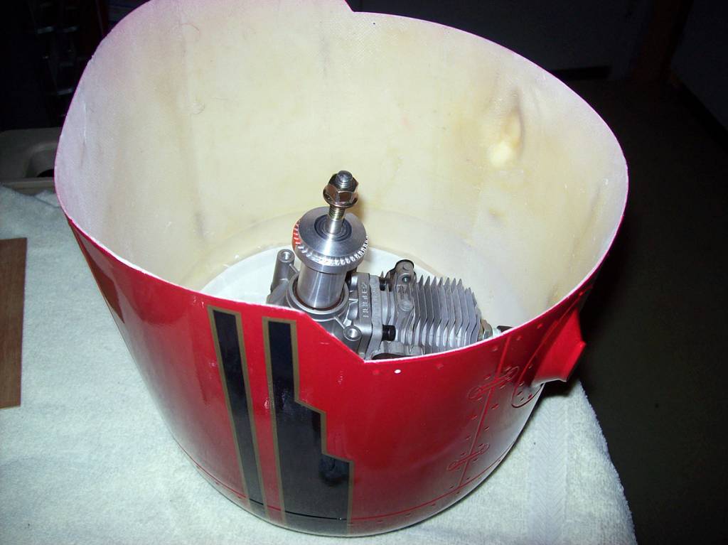

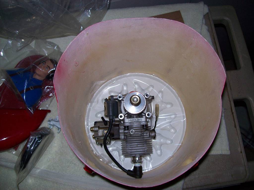

I didn't photograph it but recall while looking at the added weight inside the cowl mounted above the engine that the G-23 fit completely inside the cowl. Spark plug wire may have protruded but didn't notice.
Time permitting I will fit my G-23 inside the cowl to see how it fits and advise.
#1500
My Feedback: (243)
Took a minute to check the fit.
Attached photos show the G-23 centerline about 1" above the cowl centerline, according to the dummy engine in the bottom.
Obviously spark plug and cap will protrude about the same 1". Everything else should stay inside.
