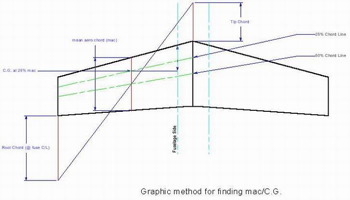

guys cg as per spec(manual) and go soft on the control throws on first flight get use to the plane then give it lots more, this plane can do almost all manuvers in 3d, hovers well and does the most amasing snap roll.
below something to keep and use for cg set up. best
