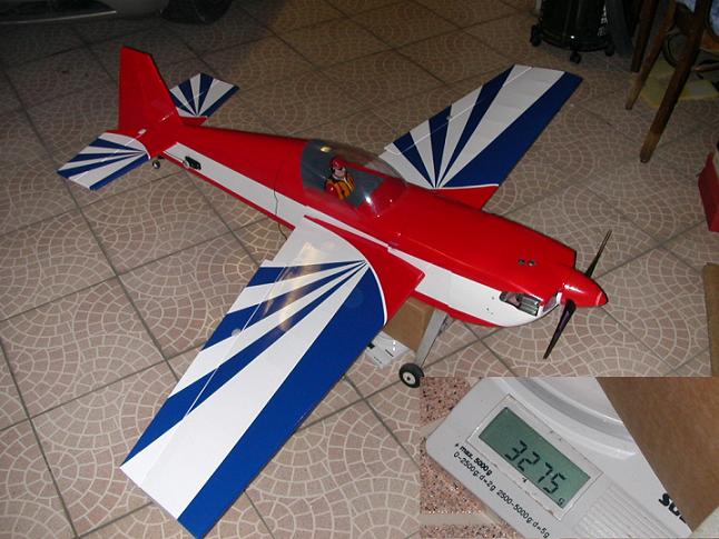

Old 01-16-2003 | 08:04 PM
  #147
wolf123's Avatar
Posts: 253
From: Castelnuovo Rangone (Modena), ITALY
Default Seagull Models Edge 540
no i use it right out of the box
this is the finished model

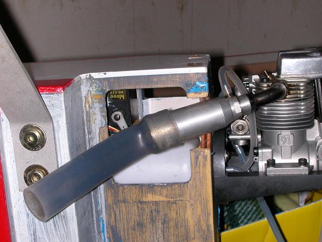

Old 01-16-2003 | 08:10 PM
  #148
wolf123's Avatar
Posts: 253
and this is where i put trottle servo
if you wont more pic tell me
ciao mirco

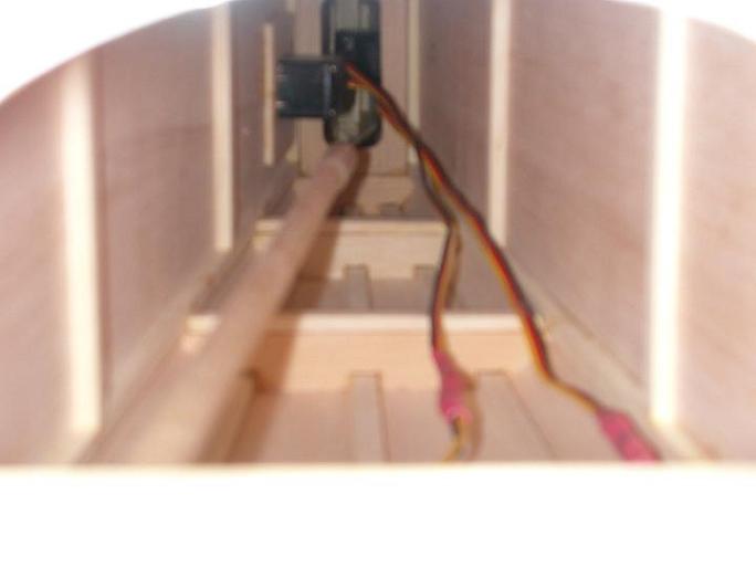

Old 01-16-2003 | 08:55 PM
  #150
wolf123's Avatar
Posts: 253
tail section inside
