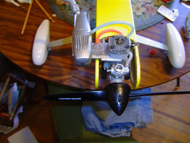

It should not pull left when you throttle up. Somthing is misaligned (or warped). Check it over carefully, with an incidence meter if possible. Make sure you dont have any left offset in the engine mount. Post some pictures if you can.
Joined: May 2005
Posts: 129
From: East Moline,
IL
The engine may point a little left although it looks fairly straight . Do you think putting some washers behind the left side of the engine mount is worth trying ?

[:@][>:][:@][&o][&o] Well now I am screwed forgive the pun for breaking off 2 of the 4 screws holding on the engine mount . The engine seemed to be pointing slightly left so I decided I would put washers behind the left side to make up for some of the torque left problem . I forgot about putting non permanent loctite on the very wimpy screws they provided to fit the blind nuts in the firewall . Those screws must be made of some of the cheapest weakest metal known to man . I applied very little force to get them loose and they broke so easily I didn’t even realize 2 were broke till I had the mount in my hand . So now I have more to worry about then a plane that doesn’t want to roll . I don’t think while increasing throttle a plane should start turning left . No other plane I have ever flown did that . Anyway I don’t mean to sound defensive I know I have sooooooo much to learn but should a plane try and turn left while throttling up ? One thing you are defiantly right about is if I would have flown fast till it quite turning left ( assuming it would eventually fly straight again ) I probably could have done a decent roll . Anyway at this time it is all academic till I figure a way to remount the engine with 2 snapped off screws . I am not a builder my planes were used and put together and the 4* was my first ARF the Twist just needed engine and radio . So like I said if I can’t get the broke screws out I am screwed since I wouldn’t know how or want to attempt cutting the firewall out and replace it .
My Feedback: (13)
Was it the screws holding the motor to the mount, or the screws that hold the mount to the firewall?
If it was the ones holding the mount to the firewall there should be blind nuts on the back side of the firewall. Easy enough to knock them out and replace them. Take outthe tank and look at the backside of the firewall. Should be 4 nuts, look almost like washers from the backside. If they are not glued in, tap them out from the front side using a punch or some other object you can strike the broken bolt with. Don't hit them hard, just light taps.

I got the engine back on the 4* it was not bad at all
. I just tapped out the blind nuts with the broken screws and went and got more . I put thin washers behind the left side of the engine mount to have it point more right and increased aileron throw (with in specs ) at the servo . We will see what happens . I may not get a chance to try it for at least a day or 2 if we get the storms and winds predicted . So anyway if I don't do any better rolling it with the adjustments I made I will have a veteran flyer fly the 4* and see if every thing is set right . If it is I will have to get a little training on how to do what I have been already doing over and over with other planes .

Flew the 4* today and after putting the washers behind the left side of the engine mount and moving the clevis to the outer servo arm hole she rolls just fine [8D] . I can roll her now with no effort just right or left aileron no rudder no down elevator needed . I can even do a roll like I like to coming in slow over the middle of the field throttle up quickly with up elevator then right or left aileron rolling while going up . I am now very pleased with the 4* I didn't think it was me since I could do this with much less aerobatic planes
. I know I am changing subjects but my OS .46 AX on the 4* was starting with 1 flip or 2 and I now have to use the electric starter . It don't seem to stay primed I prime it then you can see the fuel go to the carb but by the time I put the glow starter on it you can see the fuel in the line go back toward the fuel tank [:@] . It never use to do that and the .46 AX on my Twist is starting with just a flip and stays primed
. Once the engine starts it runs great like the other one . What could cause it not to stay primed but it runs fine once started ?
