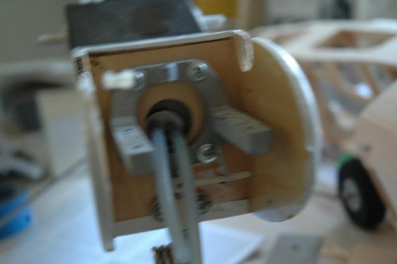

Hello. I have bought two of these planes, and the first one we crashed of what we thought was piliot error but as we built the second one we found that the engine had trouble getting fuel to the carburetor. We believe that the fuel tank is to low and that the carb is too high. This could or couldnt be the problem but this is an ARF and we have built the same plane twice with the same outcome...
What do you suggest I do to fix it? Thanks

Got a picture? Show us how you've mounted the engine.
It would be possible to mount the engine higher than the tank. If the appropriate clearances are cut into the cheeks, the spinner should be at the point of the cheeks and your carburetor will be aligned with the tank.

ok i will work on getting a picture. The engine that i have is a .46 Tower Hobbies abc engine, that is what is on the box. Has anyone had any problems with this? The engine runs great on the ground but when you lift the nose upwards you lose the power and it is a dead stick not 3 feet off the ground.

Here are the pics....We have tried tuning it and we got some others at the field to try without luck, this is my first plane but my dad has had many. So i am up for any ideas on how to fix it.

Do you have foam around your tank? If not, put some extra under it to raise the throat of the tank to be square in the hole. It sounds like either its just too lean, or your fuel is just foaming. I forgot to ask, do you have a spare engine you can drop in it. To test if its the tank or the engine.

i will try the foam to raise it but i think that it is all the way up... Umm i do not have an extra engine to put in.. This is really frustrating because i want to fly but i cant think of a way to fix it.. if the fuel tank was a little high and the engine a little lower it would be perfect.

I have to agree that it sounds like tuning. When you go nose up does it die at any throttle setting, or just wide open? I'm guessing that you're running the engine too lean.

bmannrcflyer , i would remove the fuel tank with the lines , block off the pressure line from the muffler and blow in the fuel line(clunk line) to pressurize the tank , with pressure in the tank pinch of the fuel line (now both lines are sealed with pressure in the tank ) now submerge in water and look for bubbles.
I would also check the clunk line in the tank to be sure that it is properly connected and also make sure that the clunk line is the line going to the carb. and the vent line is going to the muffler for pressure

I would do the pinch test. Start your engine, and carefully pinch the fuel line at the carb. The engine should rev up for atleast five seconds before it dies. If it does not rev up and just quits, you are too lean. If it revs longer than 7 or 8 seconds then you are too rich. That will set the low end. After thats set, open it up to full throttle. slowly lean it out until it quits gaining rpm. If it dies, richen it up 2 turns and start again. Once you get the peak rpm, richen it up so till the engine losses 400 rmp, or once you hear the engine change to a lower pitch, make it about a little less than a 1/4 turn richer. That will give you a starting point. Another test you can do it take out your fuel tank and with all the lines attached, put the tank underwater, while keeping the ends of the lines out. Pinch off one line, and blow in the other. Look for bubble coming out of the tank or tank neck. That will show you if you have a sealed tank. I hope this helps.
I forgot to mention, make sure you dont have the clunk and the vent reversed going to the engine. That could cause the problem also.
