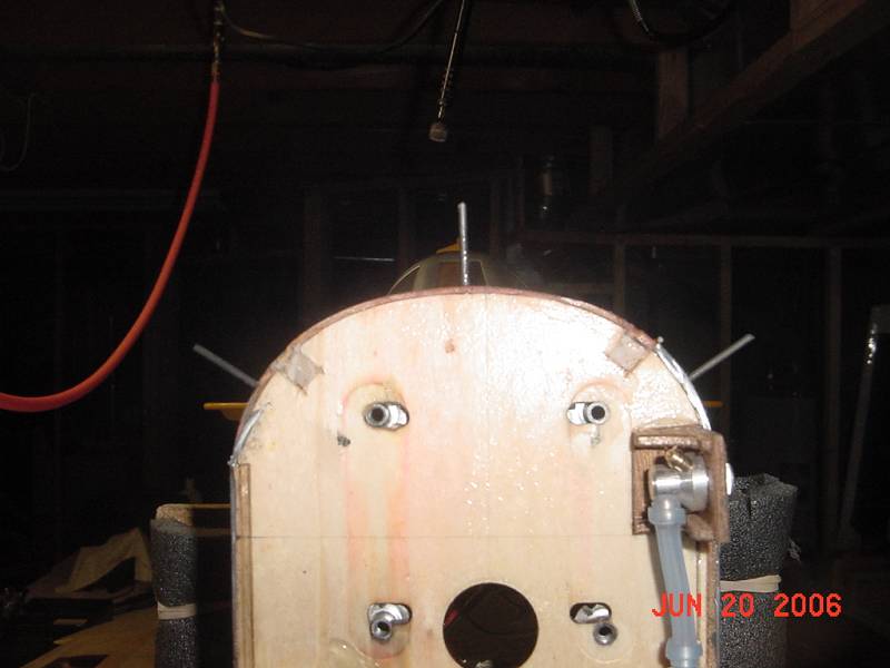

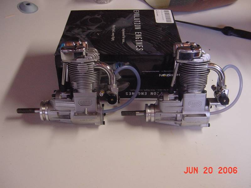

Pit-Viper 1's Avatar
My Feedback: (12)
Joined: Sep 2005
Posts: 1,626
From: Butte, MT
Default RE: CONTINUATION..H9 HELLCAT MINES OK HOWS YERS?
Yeah the G26 is heavier and in my application the extra weight is needed. I was using the RCV.91CD and it flies it nice but it just isn't quite enough to pull it around even for scale flight. If your thiking of the Saito 100 and if the extra cash isn't a problem, you should go with the 1.25. My buddy used the 100 in a the H9 P-51 then he put the 1.25 out of his showtime in it and that thing has gobs more power. Just a thought. It's kinda funny when you put the Saito 1.20 and the 1.25 side by side cause the 1.20 looks huge compared to the 1.25. Here's the 1.00 and 1.25 together, can you tell which is which? He uses an APC 16x8 and the plane is around 8-9lbs. and will almost hover, lol

I really like having that extra power. The guys at my club field said that I was nuts putting in an OS .61fx in my H9 PTS. Well I'm flying circles around their PTS's now. I was looking at the Saito 100 because in the RC mags, they always use the 100 on their 60's. I think for the extra $60 it would be worth while getting the 125. I will need to re inforce the FW for sure then. So the G26 will fit in H9 Hellcat? Do you have any pictures of the install? If the G26 fits nice, I rather go with it. From your pictures, I can't tell which one is the 120 or the 125.

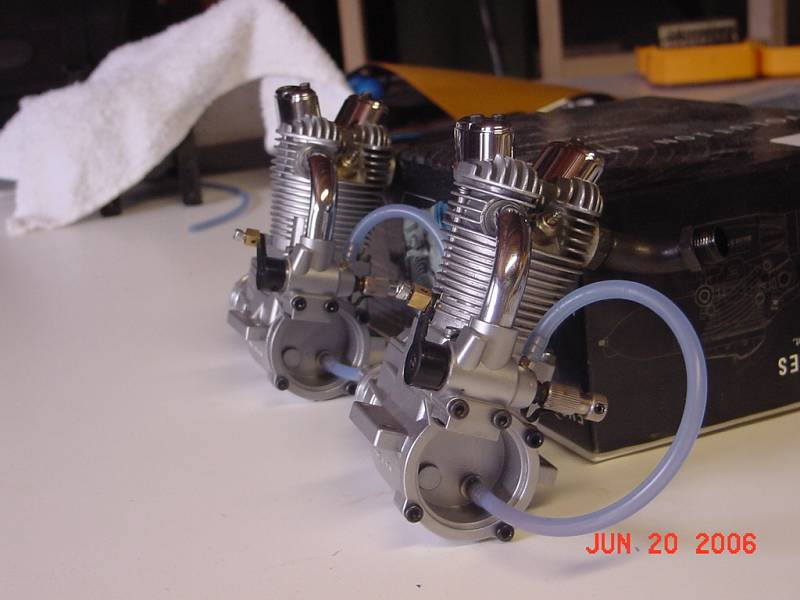

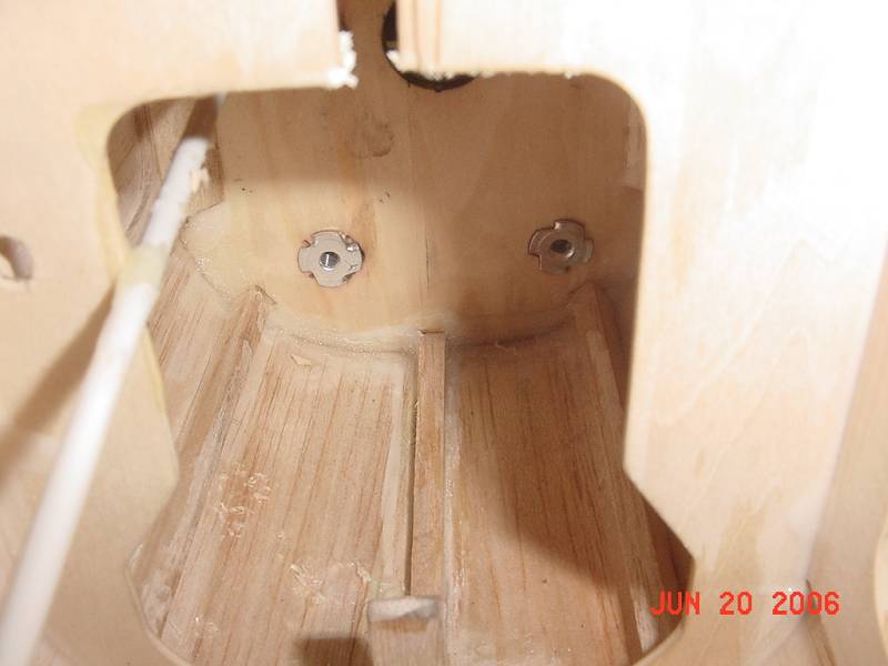

My Feedback: (12)
Joined: Sep 2005
Posts: 1,626
From: Butte, MT
The left is the 1.25, I don't have the G26 yet but that what I will be useing, If it was a four banger I would definately go Saito 1.25. Yeah I would reinforce the firewall as well, thats the reason this is off the plane now. Here's a couple pics on how he did it. The 2 square pieces of stock between the metal rods are where he cut the firewall and ran them all the way into the bulkhead so they look like the original one that is there. Should work pretty well. I was going to put my RCV .91 in the PTS but it weighs a little much for this plane, I will figure something else out. Wish we still had the OS .50, it took a dirt nap in a fourstar 40. lol

I just got done pulling all the hot glue from the back side of the firewall. It is scary how easy that stuff came out with a hemostat. Just grab the corner of it, and it all pulled right clean off the wood. Now for the fun stuff, applying epoxy and little 1/2 sections of triangle stock all the way around the firewall joint. I cannot believe H9 expected us to bolt there 1.0 paint shaker to the front of this.[X(] It would kinda belike trying to fly Santa's Sleigh when Rudolph decided to fly on his own. 90 percent of the hot melt they put on firewall was not even contacting both surfaces. I have a whole lunch bagy full of hot melt glue, maybe I should send it to Horizon.

How hard would it be at the factory to glue the firewall in with epoxy.[sm=confused.gif] I wonder what the glue joints look like in the tail and in the wings.[X(] Maybe if enough people would complain to Horizon, they could step up the glue quality a bit.
