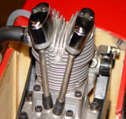

Travis,
Here is how I set my Saito 100 up. I switched the pushrod to the opposite side and set the arm to point up instead of down and used a braided wire as a pushrod tinned on both ends for rigidity.
Hope this helps.
Bill
Hope this helps.
Bill

That's a great picture. I think I will use the same setup. Bill, what type and brand of connector is that holding the wire to the carb control arm? It looks like it has a metal backing to hold it on. Did you do anything special to make sure it doesn't come off the control arm in flight?
Travis

Hi Travis,
Actually, it was just a keeper I had laying around but there are different ones available from several manufacturers at any hobby shop. Some have metal ends and others use a hard rubber type grommet. DuBro makes some different types. You could probably find several by searching on Tower Hobbies site. By the way, I had to add 4 ounces of lead the the nose of my 4*60 to balance it properly. The Saito is a sweet running engine, I've started adding more nitro and it seems to like it just fine.
Good Luck,
Bill
