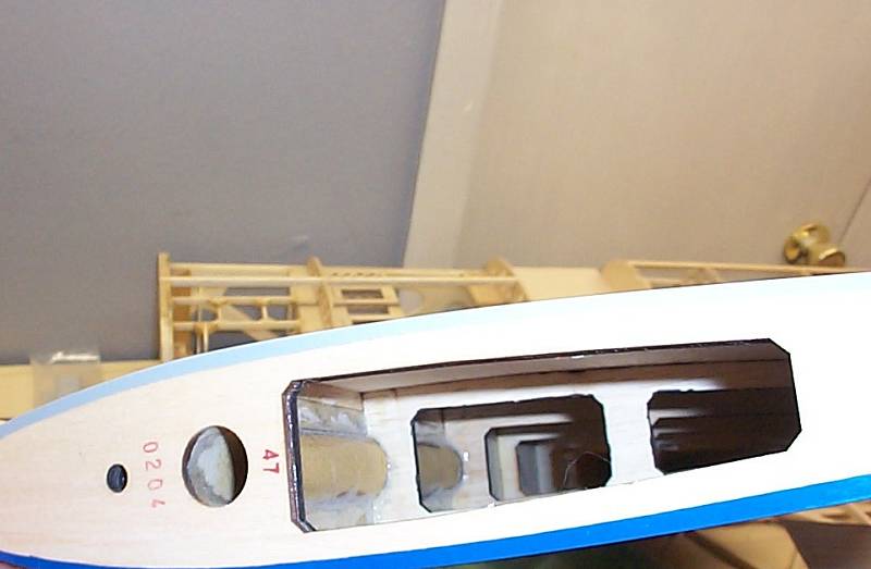

I have finished with the root rib addition/spacer to fix my short wing.
Picture shows the finished balsa rib that was cut with an xacto knife and sanded to finish size using a sanding block.
I was able to use my trim iron, xacto knife, small screw driver, and finger nails to pull the covering off the face of the original root rib.
The new rib was glued on using “Titebond II†and using the trim Iron once again, I wrapped the covering back around the face of the root rib.

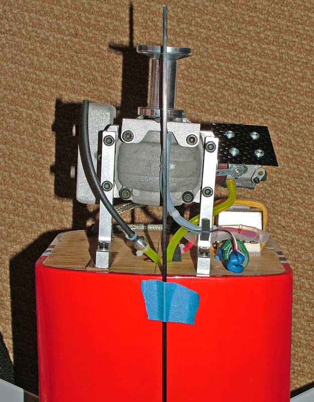

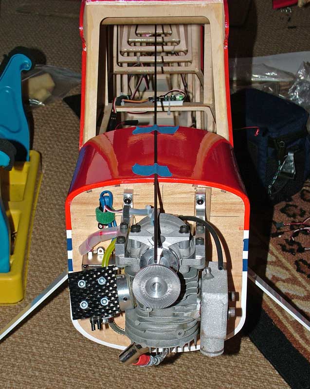

I did find the firewall is cut for right thrust, but their mount seems to take it out, ...magic? I ended up about 0 down, 0 right first try. Flew great- no dive or balloon on power changes.
The plane won't dive or balloon because it doesn't need downthrust, but it will pull hard to the left unless there's a LOT of right rudder trim. Or magic.
Also, if there is zero right then the prop drive face should be off-center to the left, requiring the cowl to be tilted to the left a little.

quoting cmoulder:
"Zero down is correct for this model, but zero right? All models need some right."
Agreed, cmoulder, despite all of the long winded debates at the airfield (which I have learned to avoid, too smelly) a tad of right thrust usually counters the PEE factor or whatever as the propwash comes around helically and kicks the fin, yada yada yada..... I generally just stay on the rudder the whole time whether hovering, KE, landing and prefer the motor and fin straight- right thrust and fin only cocked in the right direction by my "tolerance" or measurement error which I think (pray) is about 0.5°.
To be honest, the one thing that I really "ARFED" is bolting on the motor to the stock mount. I twisted it between the rails to get rid of downthrust and figured that I could washer the side thrust later. I cannot go by the incidence meter numbers or my eyes on the right thrust. My eyes work for right thrust if I get up in a chair& look down....but that all goes away if I mount the engine at 45°/RHS per kit instructions- just can't see it. (BTW that 45°will mean no cutting the cowl for the Saito 91's valve covers!) (EDIT:Iwas wrong... had to cut the cowl for the valve covers.)It seems a little dicey (in my limited experience) to use my incidence meter's prop drive washer mount with the plane sideways to measure right thrust- no good 0° reference. But measuring the same blade on LH and RH sides to the center of my (straightened) fin reads zero. I've only flown in high wind so far, so the rudder comps are full time anyway. Yes, right thrust would be good, but at the 1 degree level, its not noticeable in puffy 15-25 knot winds. What IS noticeable is my severe pucker factor with such a light plane in those conditions for the first 5 flights!!!
Gotta love the airbrakes for landing without rolling over, bouncing or stalling in a puffy crosswind.
MAGIC?!?!: Good point about the cowl-the whole motor appears to be CL slightly to the left(3-5mm?), which does effectively give a tad of right thrust IMHO- as in standing on the rudder in a twin when one engine goes out. The center of force is left of the center of drag, so it goes right. But now you have me questioning my prop tip L/R measurement- which is only good if the motor is on centerline.

Actually, when I switch to the .91 FX I am going to add a tad more right thrust. I like to run 13x8 props, and higher pitch props also work better with a little extra right thrust.
As for getting the prop drive face centered horizontally on the firewall, the best gauge IMHO is a long CF rod taped to the centerline of the fuse. The pics below are from another project, but the application is identical for most models. Once the desired right thrust is achieved, just move the engine mount around with the engine attached until it lines up.

An alternate way to measure right thrust is to use a prop. This assumes the fuse wing and tail are square. Mark which ever tip you prefer so that you can use that tip for measuring each side. Measure from the prop tip to the elevator hinge line.

I do believe the right thrust debate will never end. For those that use it no one will talk them out of it. For those that do not use it no one can talk them into it.
Once upon a time I did not beleive in it. Even when I built a plane that was designed with it I would remove it. I had/have a little biplane that taught me the difference because I was bold enough to experiment and saw the difference first hand.

Here is the picture of my wing showing the spar/wing tube and the shear web.

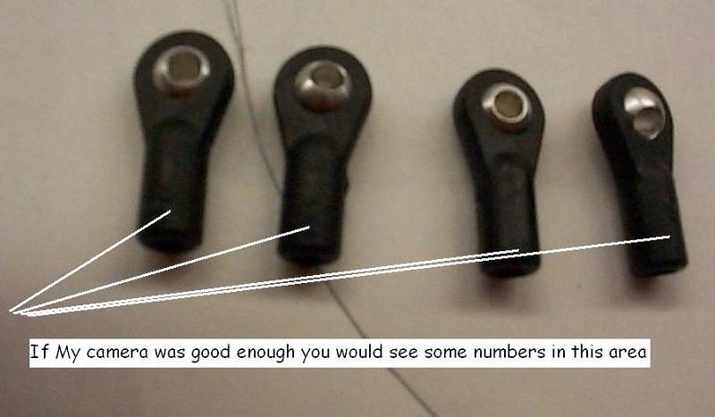

Also a little tip that can be taken with the grain of salt that it is served with:
The second picture is an attempt to show the little numbers that are molded into the ball links supplied in this kit.
When mounting these ball links the numbers should go toward the servo horn you are mounting them to. In this manner if the link should wear out and fail some day it will not completely fall apart thus allowing you at least some control with that linkage.
