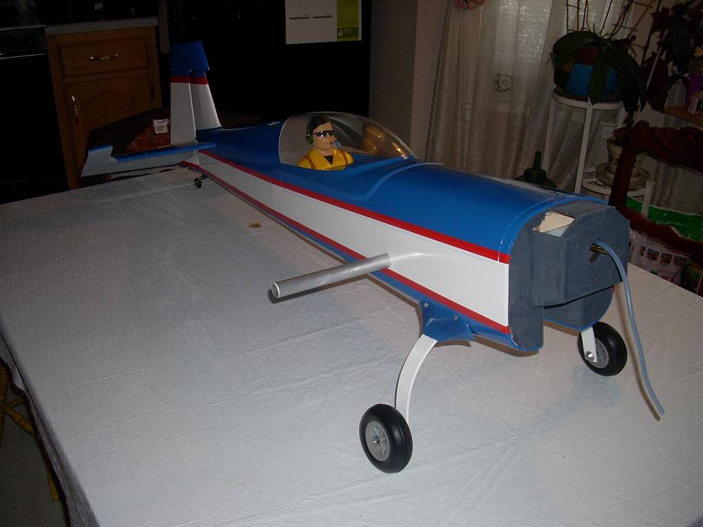

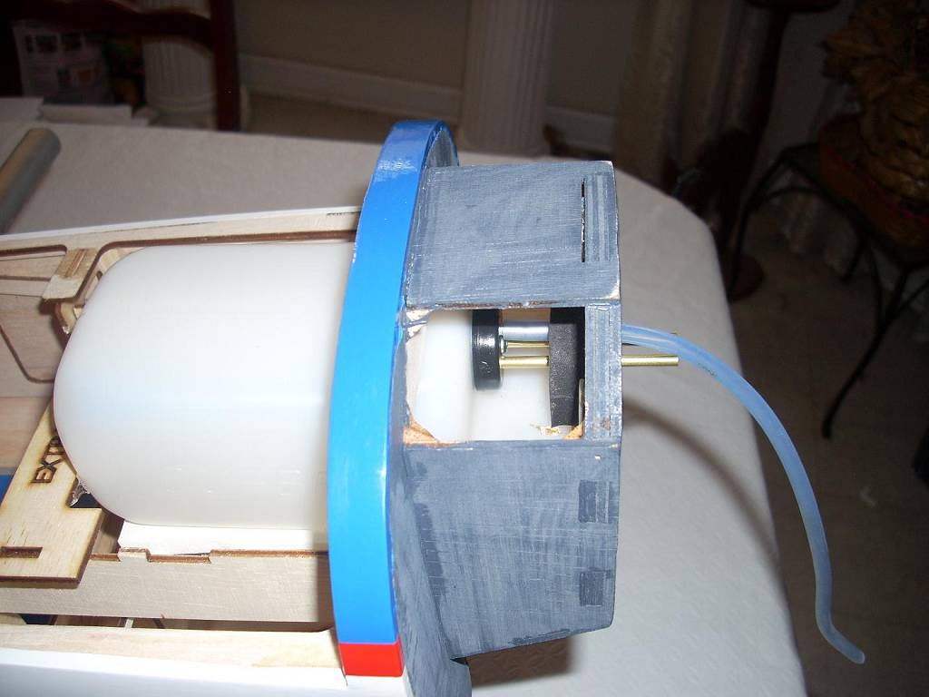

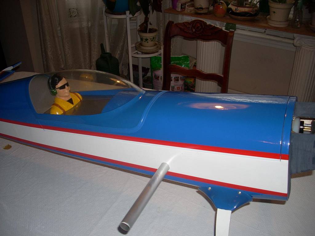

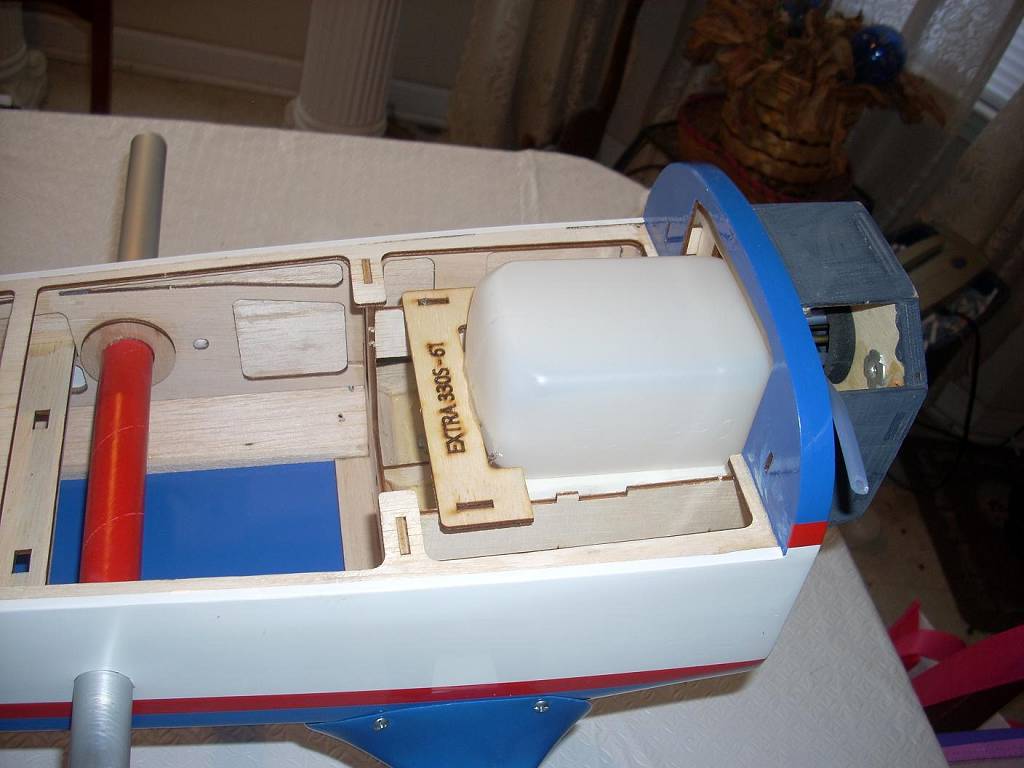

I installed the dubro 14oz tank. It does fit but you will have to move the support pice back a little and glue it in place. The head of the dubro tank does not come through the firewall and you will have to use long pieces of tubeing to get the fuel line through the fire wall. That being said it is a good fit and the top hatch even still fits without any modifacation. Here are a few pics I took of my progress so far.

Boy those improvements on the new model sure beat the old one. The gastank etc on mine was a real pain to enlarge and install :-) Having the top open to the firewall looks to have made it a piece of cake. Kee us informed !

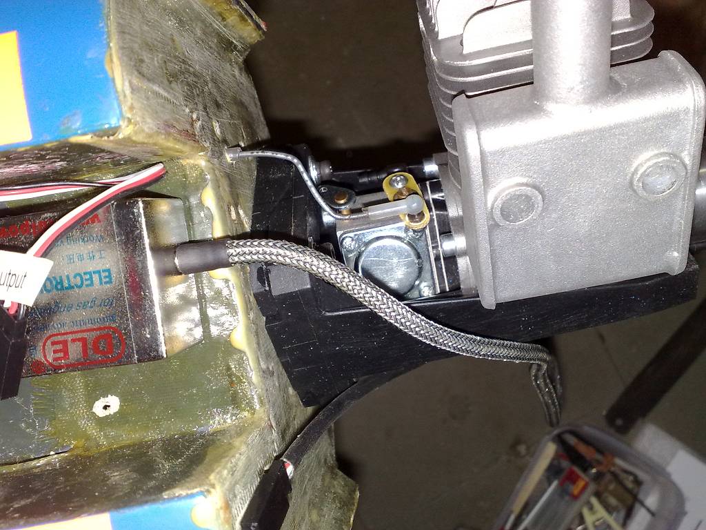

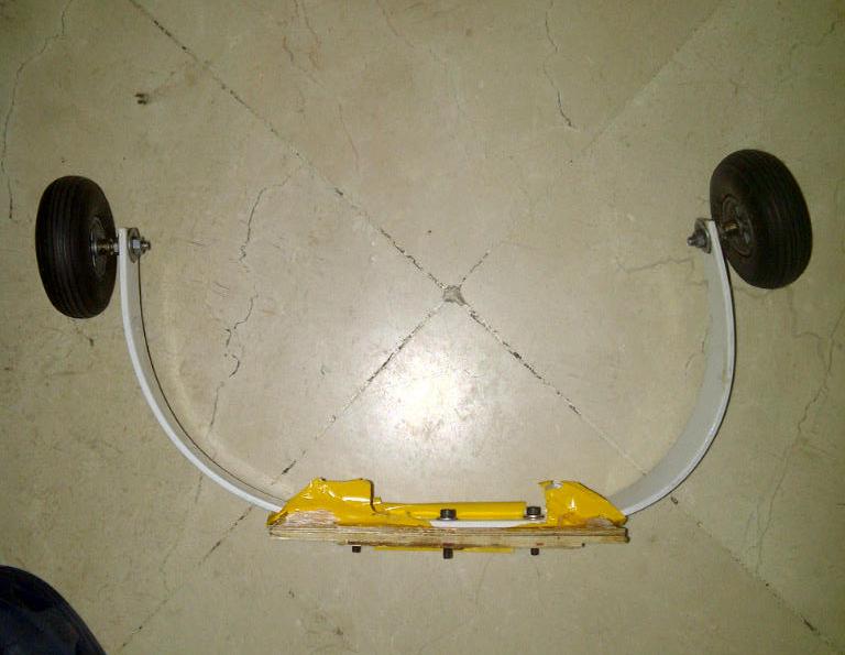

I just finished putting together the old version with the Dle20. Actually, I had already had it together with a FS91SII earlier and was waiting to put the DLE20 in this season (ours starts just about now). It was full of woes in the setup and took a lot of time. I have two major concerns
1) Put in the 2-56 Dubro rod one side threaded with the phenolic arm and snap-on ball link on it (see pic). I am worried it will come off due to vibration
2) Its now 3.8kgs (8.48lb) and am starting to worry its overweight
Have done just a temporary install right now, planning to tighten everything later after I feel more secure with this setup. What do you guys think? If its too heavy for 3d I am thinking going to the fs110 I was originally going to update to (or may be a OS 95AX)
Ameyam

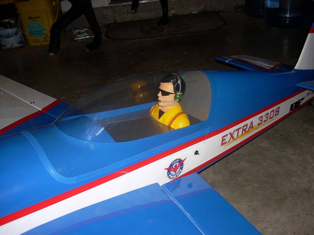

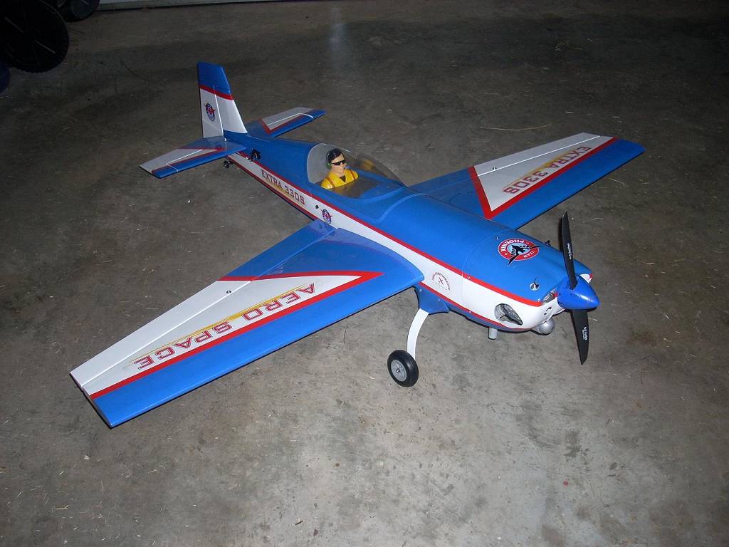

Here are a few pic's on my finished Phoenix Extra with the Magnum 108A. I hope to do the maiden this coming weekend.

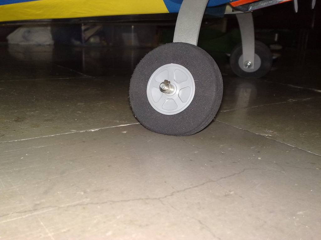

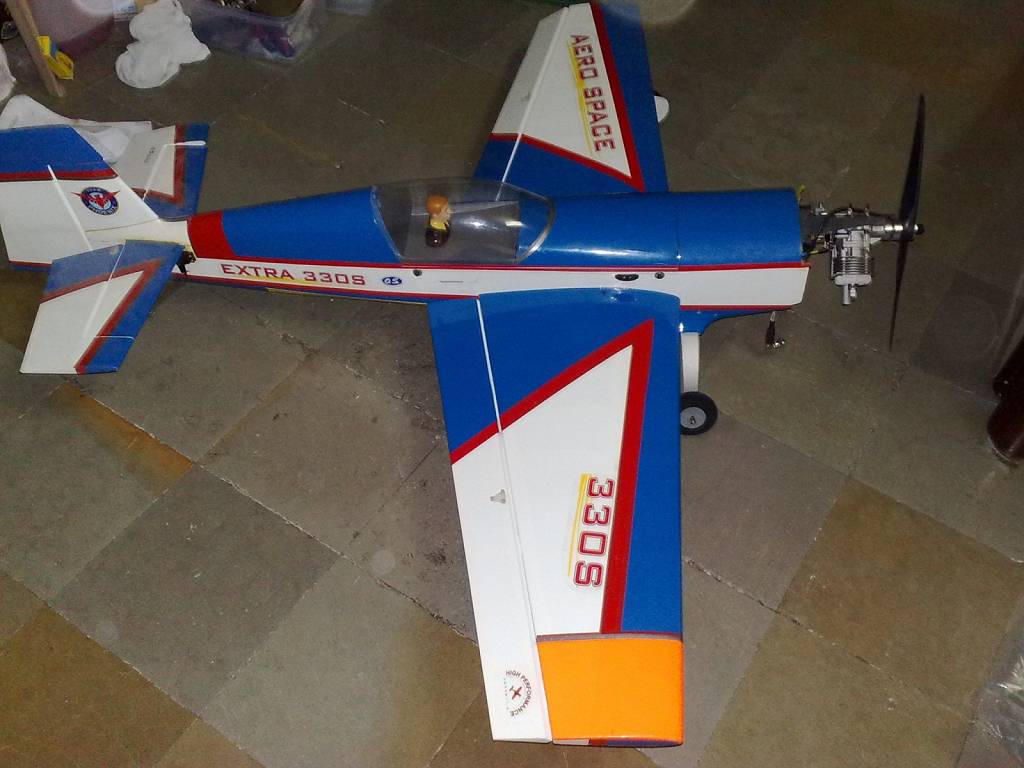

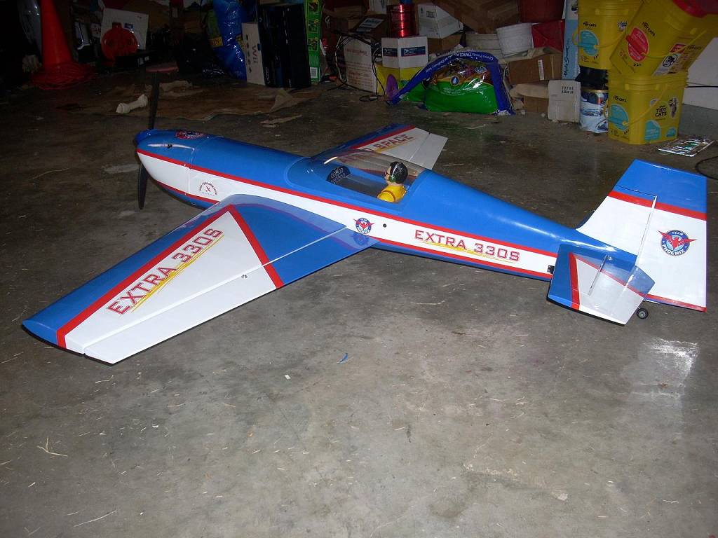

I flew the Extra withe the DLE20 today. Havent flown for 6months so I really cant compare against the FS91 earlier but I had left the trim at the same as the 91 so I can tell what has happened from trim adjustment
Firstly, this engine is really really strong. We put in so much down trim. Even with low throws it was quite reactive and I was happily gaining altitude even at 20 -25% throttle. I didnt do too much aerobatics today, had just one flight that too partly. Also, I had to fly too far to really feel the airplane because there was a huge flock of kites, eagles etc tailing an eagle shaped glider that was flown by some fellow fliers. But my trainer took the sticks for some time and he had two observations- one, over powered airplane. Even at low throttle it was doing a rudder loop easily. And two, its a bit of staller at low speed- while he was landing it was tending to squat down- even I saw that. I didnt do any landings today, so I cant give more details. In the little I flew, it does all the moves at 20% power and is likely to happily hover at 30-40% power. A fellow experienced flier has a couple of circuits and said that it really flew well. He also said landing was 'ok'
Its gained a lot of weight- 3.85kg without fuel. So much so that the foam wheels flatten when on the ground. I dont know how to make it lose weight. I has ordered CF lear but I didnt use because they told me it would be brittle. I didnt install spinner or cowl either. I used a 6v NiMH battery for ignition with diode and a 1300mAh RX battery. Wondering whether to get a LiFe for a ignition as well but it wont lose me 300 - 400g that I need to lose
