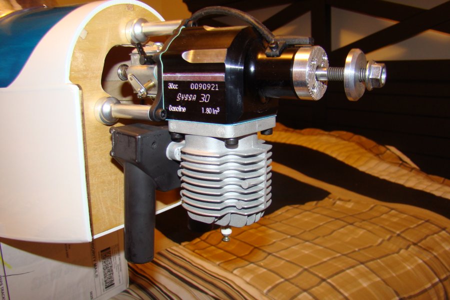

I managed to get my Syssa 30cc bolted up this morning. Everything looks fine and the cowl should fit like a glove. The engine fit fine without cutting the carb hole from the template supplied by Syssa but it was so close I decided to cut it anyway. This way the hot air can pass through the fuse. Never hurts to have extra cooling.

Your caption says " it ain't lookin' good"........... But this " is" looking good. You'll love it. Brian

That looks sharp! What is the firewall to prop hub for this plane?
Also, the engine uses pins on the prop hub, or are those optional?

The firewall to backplate dimension is 5 15/16". I never use pins and I don't like the multi bolt hubs. No need for all those bolts.

Here is a pic of how I safty wired the exhaust bolts. I drilled a 1/16" hole through the bolt heads and added wire and solder.

I have never had the 1st problem with the muffler bolts or anything else coming loose on my Syssa 30. And it is all box stock.. Brian

Thanks for the kind words. This engine is very well made and is small for it's size. Totally fits inside the cowl of my Rascal.
