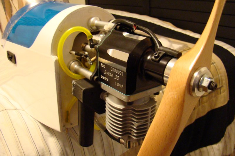

That engine looks good Zippi. I can't wait to hear how it performs.

Thanx for the reply. Your Syssa looks sweet. I still haven't decided which engine to use. Did you have to put spacers under your standoffs??
