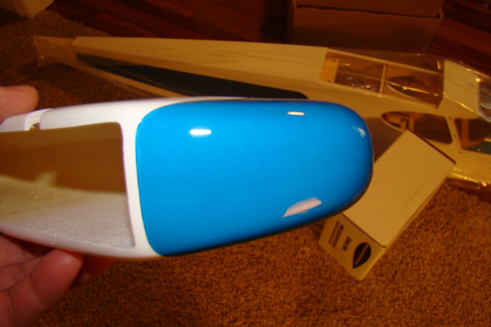

Just received my new Rascal 110. The box was not crushed and all the contents look good so far. Beside the addition of flaps SIG has went to Robart style hinges which I'm glad to see because I switched all of mine to this style of hinge when the CA hinges started giving away on the old Rascal. I do not like that the hinges are pre-installed and glued in. The limit of travel is minimal. The wheel pants now do not have the seam line that was visable on the old Rascal. The quality still looks as good as the original Rascal 110. Only time will tell as I get deeper into the build but so far the first impressions are good.

Hey Zippi!
Can you tell me what the width is on the cowl? I am wanting to run a Laser V-Twin Inverted.

PTS,
The ID of the cowl in the middle is 5".
bladebender,
There is no mention of electric setup in the manual or the manual update.
JeffinTD,
Since all the control surfaces are pre-installed and glued your stuck with what you get. If I could have glued the hinges in myself I would have set the control surface out a little futher to gain a little more throw. From experience with my last Rascal 110 you need all the throw you can get if you want to fly a little 3D. There is no hatch in the fuse.
