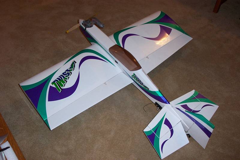

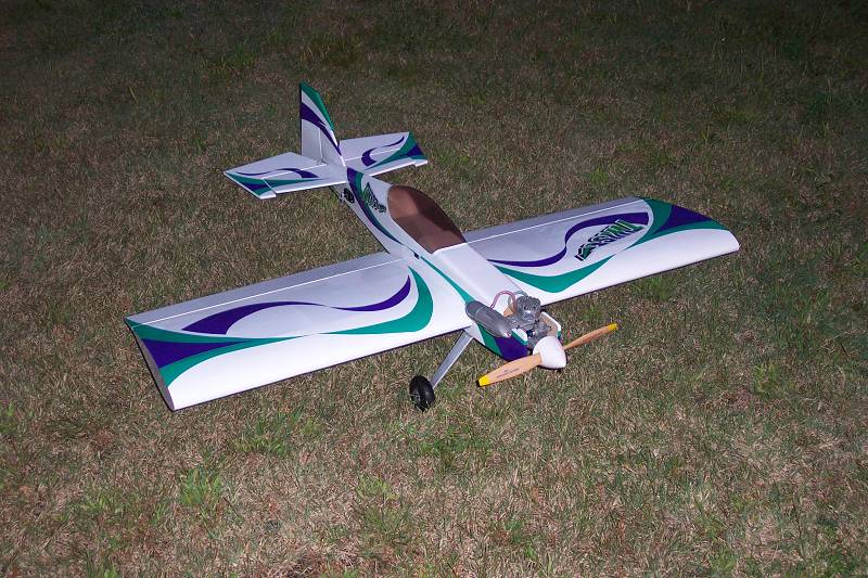

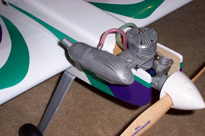

Here are some pics of my new plane.[8D]

Ugh, that's a shame about having to use JB Weld. I'm running a TT Pro 46, and don't seem to have an issue with that... but others have.
I just had a fun thought... I've got a OS -55AX and I think it uses the same bolt pattern as the 46PRO. Hmmmmm, are you thinkin' what I'm thinkin'?
Bob
