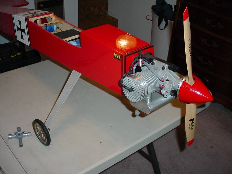

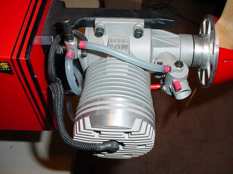

My MDS 2.18 was the same way then I put the O.S. "F" series plug (which helped) and a onboard glo system that I made & it idles Great now, It will idle slower than the spec. sheet says it will.

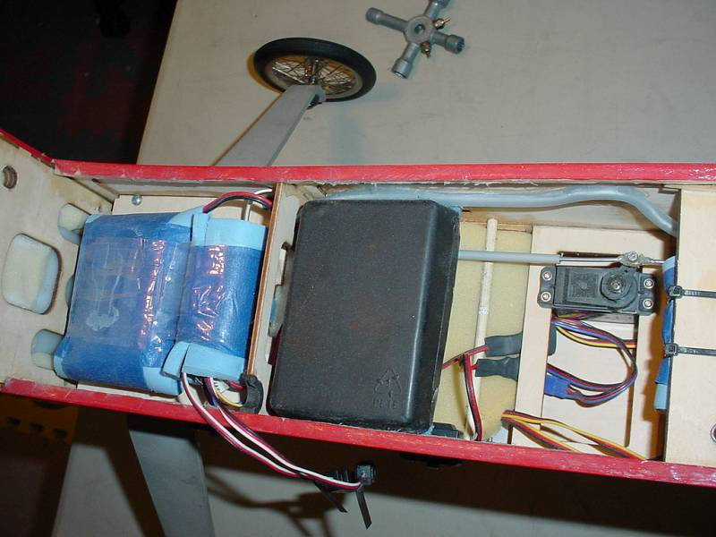

That's a considerable amount of weight.
Hope you don't mind me asking but how did you compensate for that with the plane then becoming tail heavy?
Battery moved way aft?
What's your CG?

The plane was tail heavy to start with, Putting the .61 made it a little nose heavy so I moved the Bty back as far as possible till it ballanced out. I think it is @ 5 1/4. Will have to check to be sure as I am old & have CRS (Can't Remember S--T).
