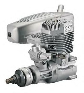

Dutch, if I was considering a .55, I think I would wait a bit and see what the new O.S. .75 is like. I'm guessing it will be a lot like my Jett .76. $195.
SPECS: Displacement: 0.75 cu in (12.3cc)
Bore: 1.02" (25.8mm)
Stroke: 0.93" (23.5mm)
Practical RPM:
Power Output:
Weight: 19.4 oz (550g)
Recommended Props: 14x6, 14x8, 15x7

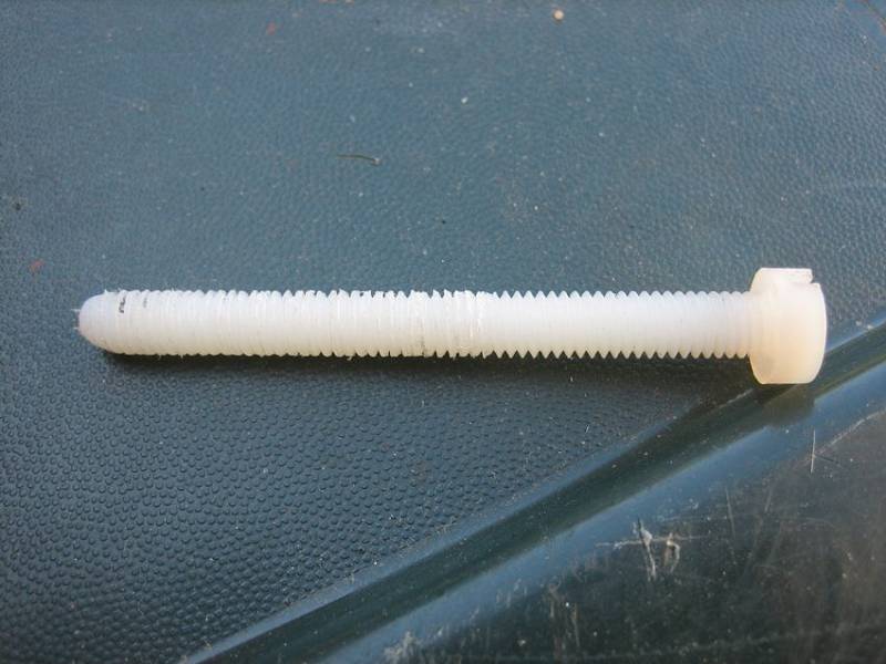

For the second time since starting to fly my 40-size Twist I find that I need to replace the wing bolt - take a look at the attached pic and you'll see why. The thread has stripped in exactly the same way as the first bolt stripped. So far the model has only had 34 flights, and I never remove the wing between flying sessions as my models go into my car without having to do so . . . . so why are the bolts wearing-out so quickly? Maybe it's because I fly so hard? I just don't know. Is anyone else having this problem? I'm considering changing to a steel wing bolt - more especially since there was a 1/4" gap between the training edge of the wing and the fuz when I landed at the end of my last flight today
Tony

TW, is the hole through the wing in allignment with the threaded hole in the fuse? It looks like the bolt threads are burning on something. I just checked my bolt and it looks fine. Mine is 1/4", not metric. When you replaced the bolt, what size did you use?
