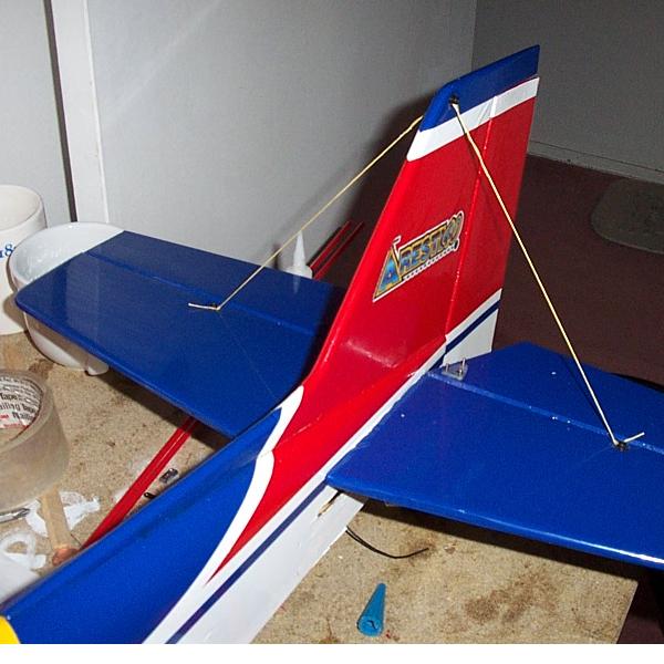

I wouldn't say it is complete garbage
It is a really nice flying plane. Yes, if there is any weakness on this plane it is the tail. One of the other members in my club had the same problem. One of the horizontal stabilizers broke in flight.
The good thing is that you can prevent it by installing flying wires. I put some on my plane and haven't had a problem. The wires are made of kevlar wire (the kind that you get in pull pull setups). I attached them with regular bolts and blind nuts

I don't understand flying wires
Okay, after reading this thread I will install flying wires on my Aresti before I take it up for the first time.
But I don't understand flying wires. If the horizontal stabilizer folded UP, then the flying wires won't prevent that--they'll just buckle in. Or are the flying wires installed under the plane as well?
Or does the horizontal stabilizer always break downward?
Thanks in advance.
Thanks in advance.
