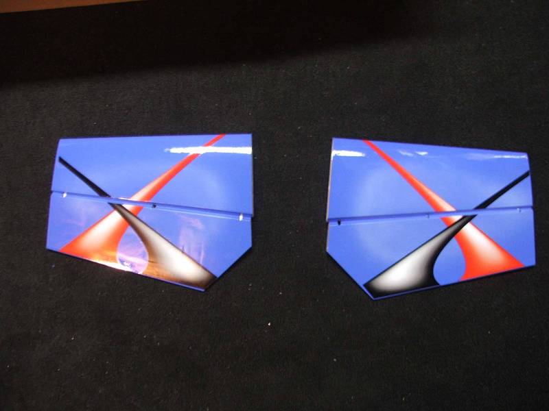

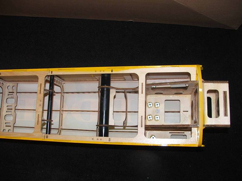

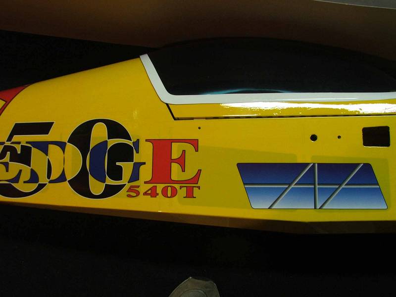

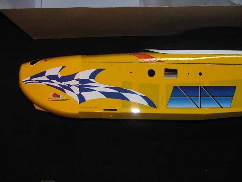

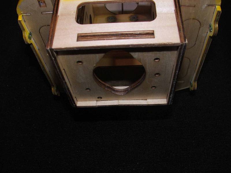

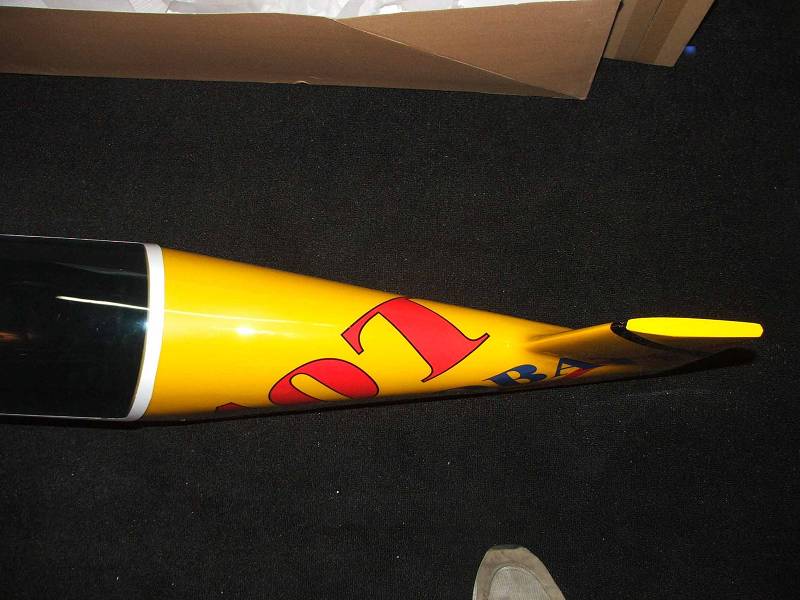

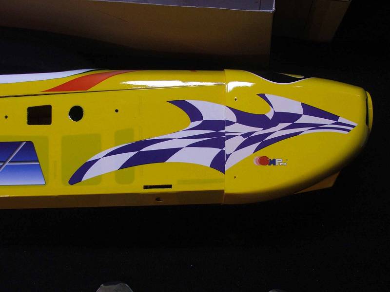

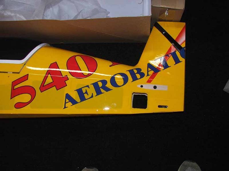

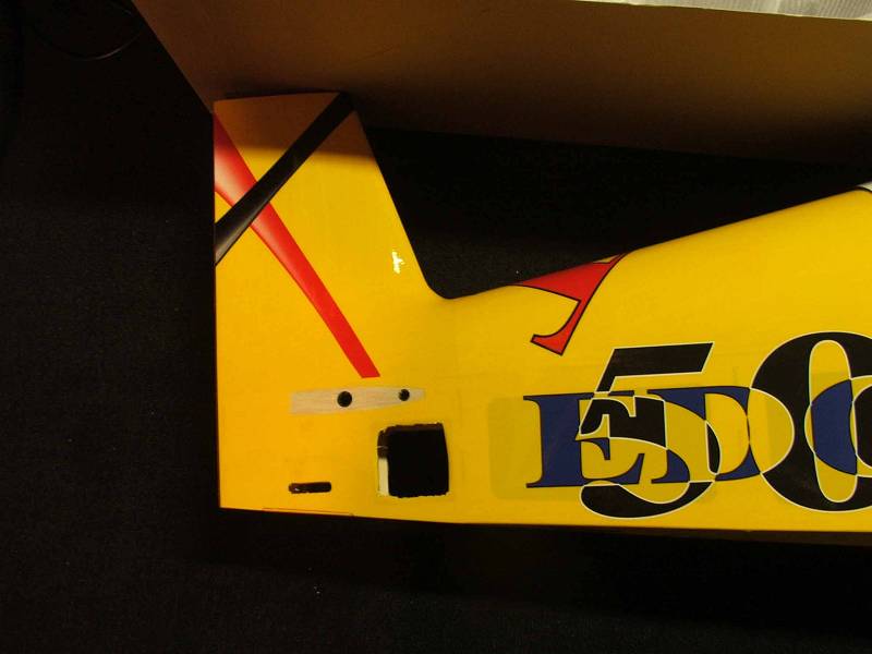

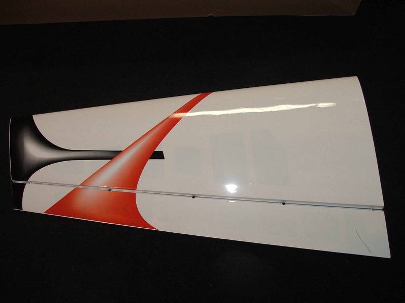

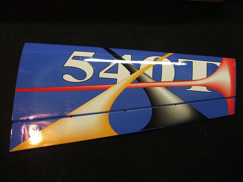

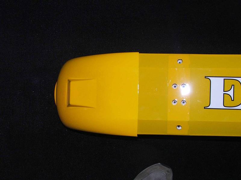

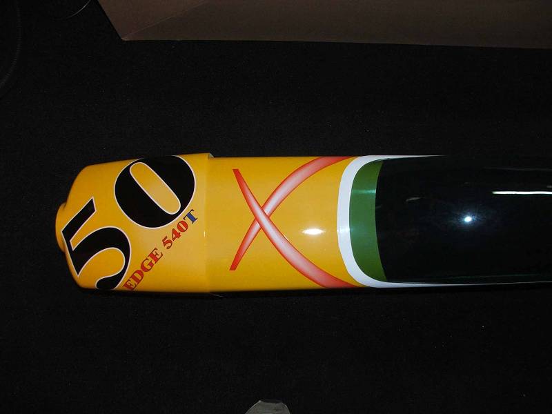

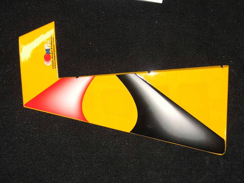

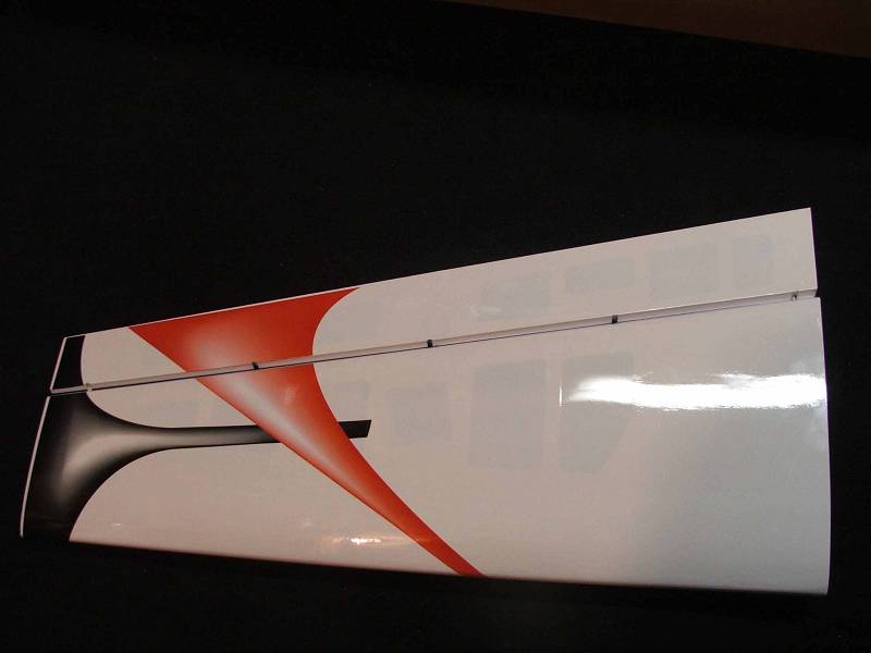

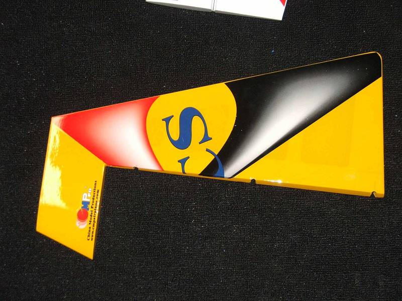

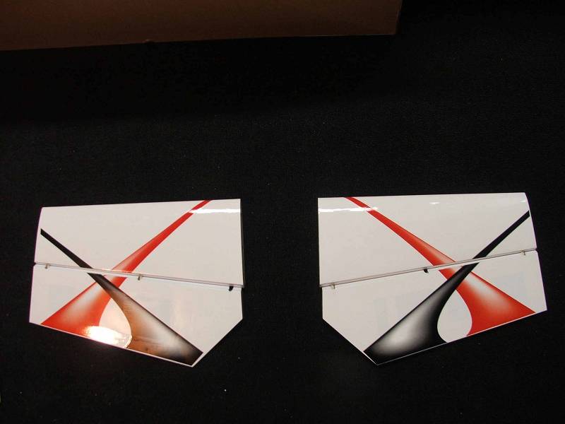

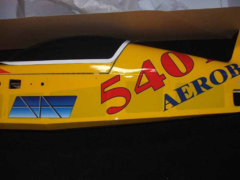

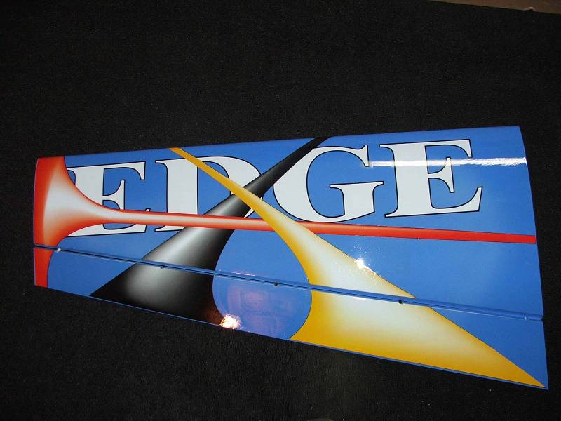

This my first attempt at a gas plane and one this big. I am going to try and go thru the build process of the CMP Edge 540 T.
First after unpacking and examining the airframe for any defects. I took a few pictures. Mainly to use for Realflight G4 540 color scheme,also to log the assembly for future reference.

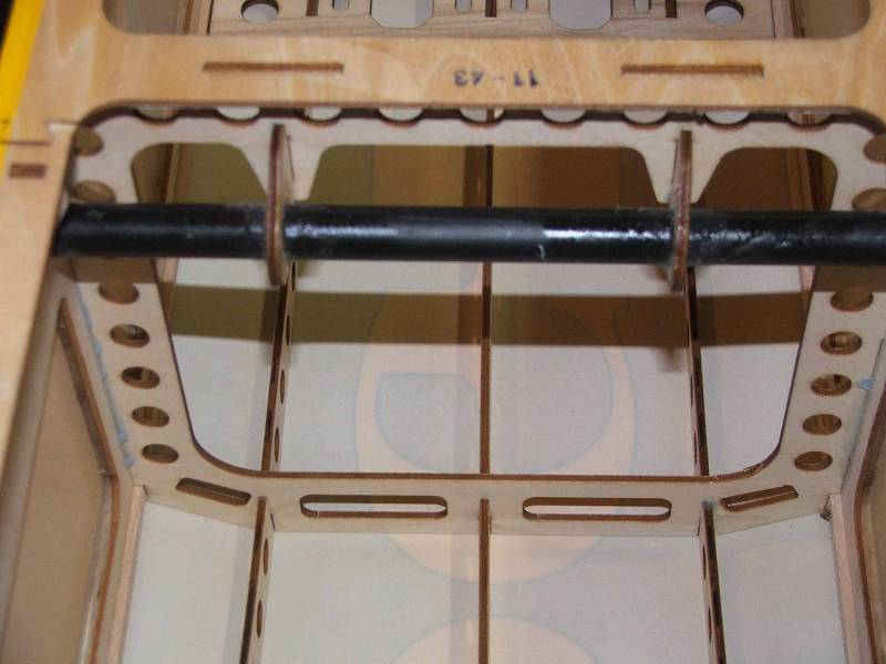

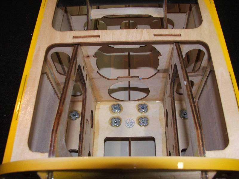

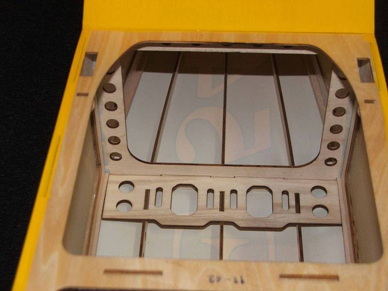

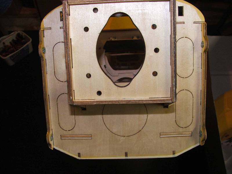

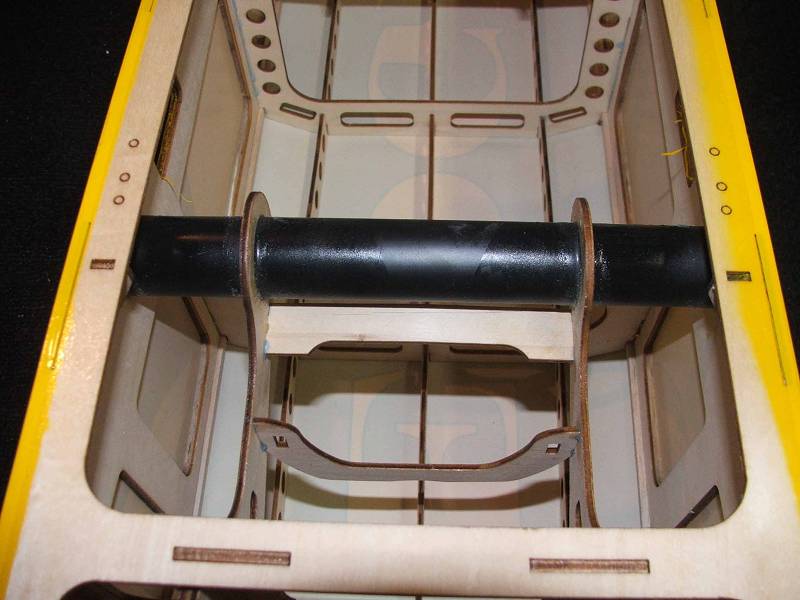

It looks like I'm going to insert strengthening blocks under the bottom panel, to beef up the gear area.
I'm a bit nervous about this area.
It looks like the fuel tank is mounted on it's side. Not a biggie, but unusual. The instructions give no real details on it's mounting location, so I guess it is to go as far back as possible against the stop.
Anyone have any ideas about what appear to be strap holes on either side of the fuel tank?
My ZDZ 50 ND has it's carb on the rear, which makes the included throttle servo mounts somewhat useless. I guess I'll have to figure out something for the throttle and the choke servos... I may also add a mechanical kill switch which can be activated via another micro servo.
The edge seals on the covering are beautiful. Mine came with the covering edges epoxied AND painted. It looks like the epoxy was smoothed down by pressing wax paper over it, especially on the wing roots. Not a wrinkle anywhere.
The tail looks very short to me... this is definitely NOT a plane for newbies.... it should snap roll if you look at it the wrong way.

The ZDZ 50ND engine requires about 2 3/16" inches of spacer/standoffs to give me the thrust washer distance stated in the manual.
I'm a bit worried about having the engine out so far supported by the standoffs... finding long enough bolts was a pain as well. I ended up having to take the bolts out of drywall toggle bolts, as these were the only things I could find that were long enough to do the job.
10-24 x 3" were all I could find in any hardware store. 12-24 x3 would have been better, but I was unable to find anything long enough.
While I have aluminum standoffs that I can combine to give me the required length, I'm considering instead cutting dowel stock to size.
The dowel stock is thicker than the aluminum standoffs. It may not look as nice, but there may be less chance of any lever moment effects breaking or bending the entire setup.
Anyone have any comments about using such long mounts?

Yeah I was reading on many other threads that long bolts & spacers are a BAD idea as the engine puts an lot of torque on the bolts causing them to eventually rip out.
A hardwood plate or base with short spacers was suggested, so this is exactly what I did.
I created a "U" shaped 1 3/4" spacer block to which I've adding short standoffs.
As suggested this creates a wide area to distribute engine torque and the U shape prevents lateral movement.
In addition to blind nuts I have a set of wide washers and lock nuts behind the blind nuts behind the firewall.
I'm still a bit worried about the gear mounting area.
The gear attached to ply that is in turn glued to the formers.
The ply looks too thin to me....
You can see this in post #3 above.

Since we are discussing finishes and maintenance in the other thread,whats your thoughts on the pattern on this Edge?
The scheme looks pretty good and fresh. Is it layered or all printed onto one sheet?
Old 02-28-2008 | 11:57 AM
opjose's Avatar
Joined: Nov 2005
Posts: 12,624
From: Poolesville, MD
Default RE: CMP 540 Edge T 28% Build
ORIGINAL: nitro wing
Most of it is a single layer covering. There are a few things such as the CMP logos that are layered on top.
Several areas show overspray indicating a matching paint was used.
I see yellow, white and blue overspray on some of the wood edges... e.g. where the canopy attaches.
This is firmly affixed and actually seals some of the edges.
There seems to be a gel type coating over the everything.
This may be a different material than used on the other CMP arf's though I do not know for sure.
It is fairly thick, and feels stronger/thicker than Ultracoat.
It may hold up well to gas.
I have the same stuff on a CMP Giles 202 V2 that I have, and I ended up using the Top Flite clear coat on that. There is no paint overspray on the Giles....
I do not know if that was necessary to use the clear coat on the Giles, it's imperative on the older CMP planes and the other Asian ARF's such as the fly-models, and world models planes.
Next time I take some pictures I'll also take a couple of the paint areas so you can see what was done.
