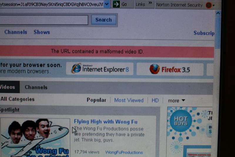

Old 11-13-2009 | 03:58 PM
  #807
balsabuster2003's Avatar
Joined: Nov 2003
Posts: 343
From: Washougal, WA
Default RE: BH T-28 Assembly
YouTube doesn't like that video.

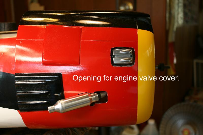

Old 11-13-2009 | 04:08 PM
  #808
Joined: Nov 2003
Posts: 343
From: Washougal, WA
I'm pretty much done hacking up the cowl. I'm installing the screws that hold the cowl on now.

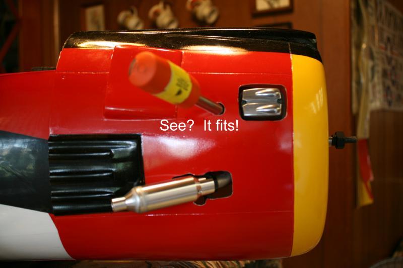

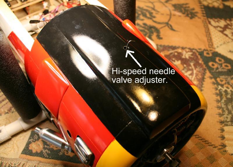

Old 11-13-2009 | 07:53 PM
  #811
Joined: Nov 2003
Posts: 343
From: Washougal, WA

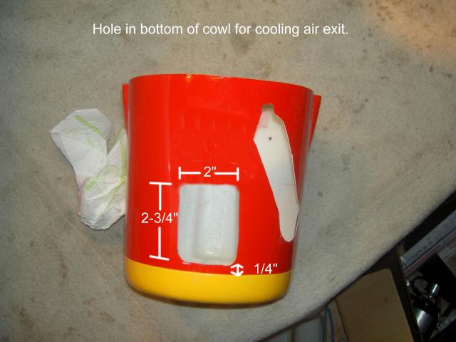

ORIGINAL: fishkillbill
Man that's some real fancy cutting! I can guarantee mine won't look half that good. How big of a hole did you make on the bottom?
Bill
My mistake!!! I posted the pictures I took of the Hobby People 160 size T-28 I'm putting together now.
On my 60 size T-28, I cut a hole 2" x 2-3/4" - total 5.5 sq. in. Have not had ANY cooling problems with it.

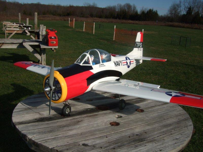

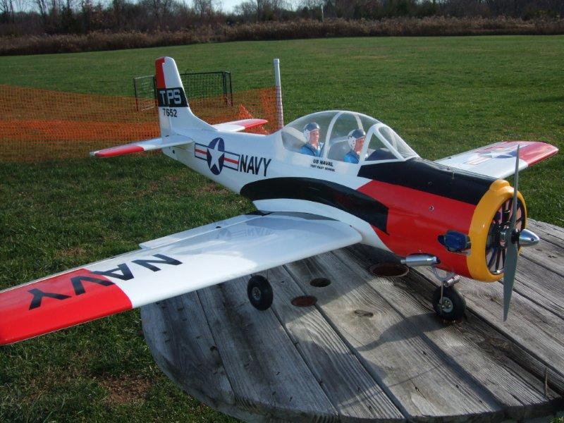

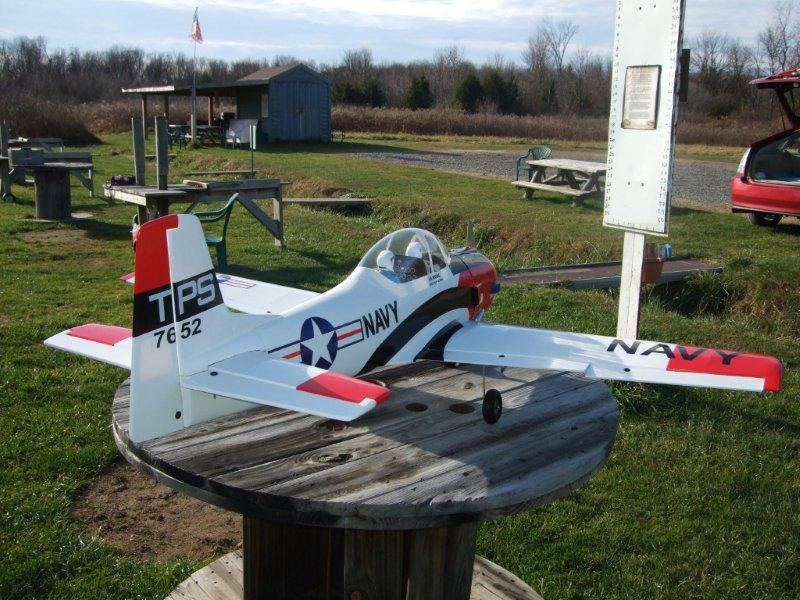

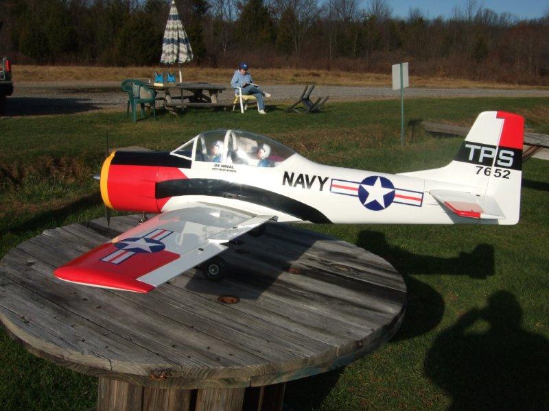

I got the cowl cut.
Bill
