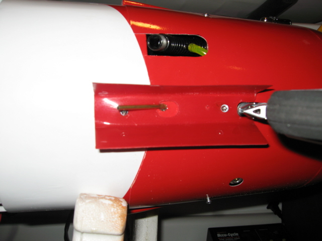

Here's a pic with the brass tube inside the front gear doos that vents my case. It keeps the inside of the cowl a lot cleaner.

ORIGINAL: maukaonyx
Yes sir Bob, will do! LOL, I have been meaning to do that. I think I will vent my 82 with fuel tube down to a lower part of the cowl, but up front. Jon
The brass tube is thru the fire wall and out the bottom. I just plug fuel tubing into it inside the cowl. The front gear doors hide it.

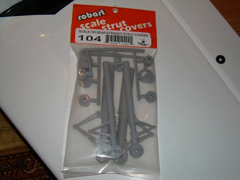

ORIGINAL: cruzomatic
Jon, I have the Modeltech P47 as well. Great flying plane. What engine do you have in yours? They build really tail heavy, so I stuck a Magnum 1.20RFS in mine. I figured more engine vs. lead up front would be best. Fast plane, lands nice and slow.
Okay, back to the topic, what's the part number for those robart strut covers?
cruzomatic, I looked at my order history on TH and here is what it says: Robart 104 Trike Gear Strut Large

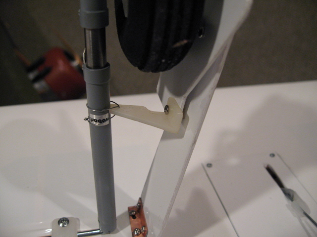

I believe the Robarts struts for this plane are the 104's......at least I hope it is as I bought a set but have yet to install them. Aside from that, I just have to check the CG and she's done. I've run about 2 tanks in the 72 so far, so she's almost ready.
What are the "shocks" that join your gear doors to your struts?

DHC, those are the same strut covers that I used and they fit real nicely. Your T-28 is looking good...I like how your muffler shows very little, and only on the bottom. The "shocks" that connect my gear doors to the struts are some leftover aileron control horns from some old plane. I think a nylon clevis would work as well.
Thanks guys for the compliments! Jon

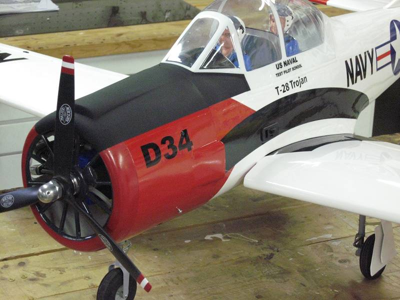

PS: pic of a change I made today to the cowl. Matches a pic that balsabuster shared back on page 18. Jon

ORIGINAL: maukaonyx
Jon,
Looks like mine on page 15.
Hit the gloss black with some flat Lusterkote. It'll keep the glare out of the pilots eye's.

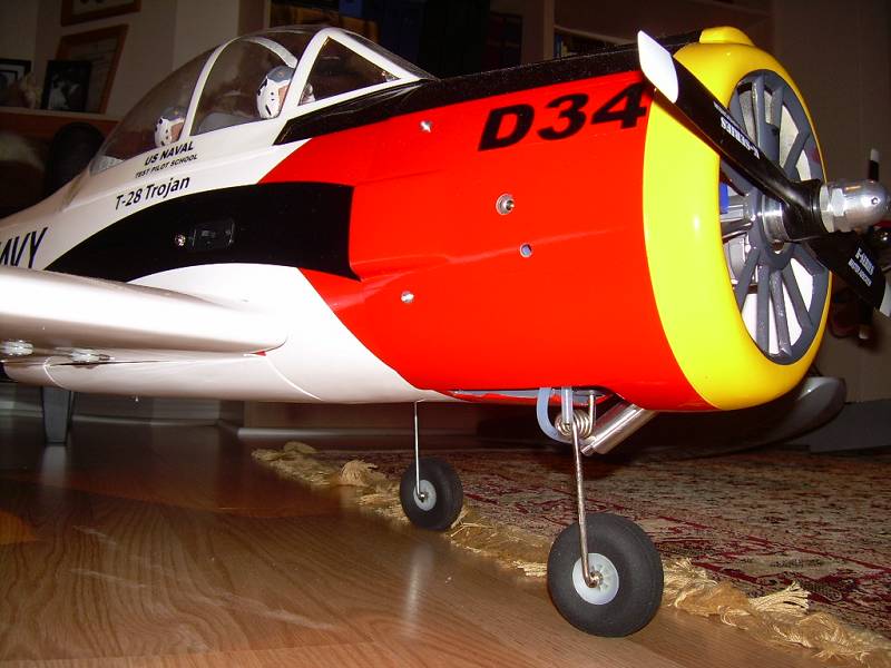

Couldn't help myself...those big holes in the front of the cowl were begging for some treatment!
Before:
AFTER:
I now have the world's first 6 cylinder Saito 82, haha. It was fun. Last night, my son got a good photo of my engine for me, resized and printed it (not as easy as it sounds for a dunce like me). Today I mounted it on 1/32" ply, fuel proofed it, and mounted it (5 separate pieces) with fiberglass cloth and resin. I like the effect it has. I tried to do the photo chopping myself on a real radial engine photo, with no success. Jon
