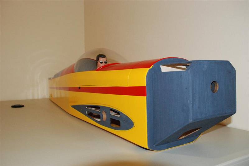

I would like to open a discussion about mods you guys have done to the bird.
Specifications:
- Wingspan: 81 in / 2,006 mm
- Length: 72.4 in / 1,840mm
- Weight: 12.8 Lbs / 5.8 Kg

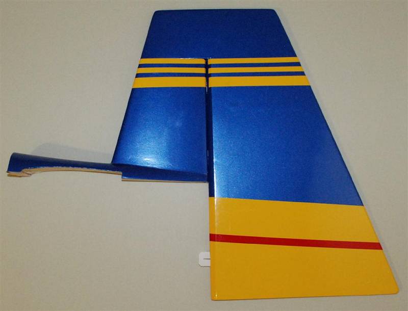

On my side, the landing gear is going to be changed for a less heavy one. Digital scale give me 238gr. / 8.40oz for OEM lg. .
I might also get another tail wheel system... will see.
I have weighted all airframe parts + OEM hardware and: 3330gr. / 7.28lb
Also, I have checked all airframe parts and no one is twisted. Covering job is more than decent for an ARF.
What is your electrical/engine setup?
JYM.

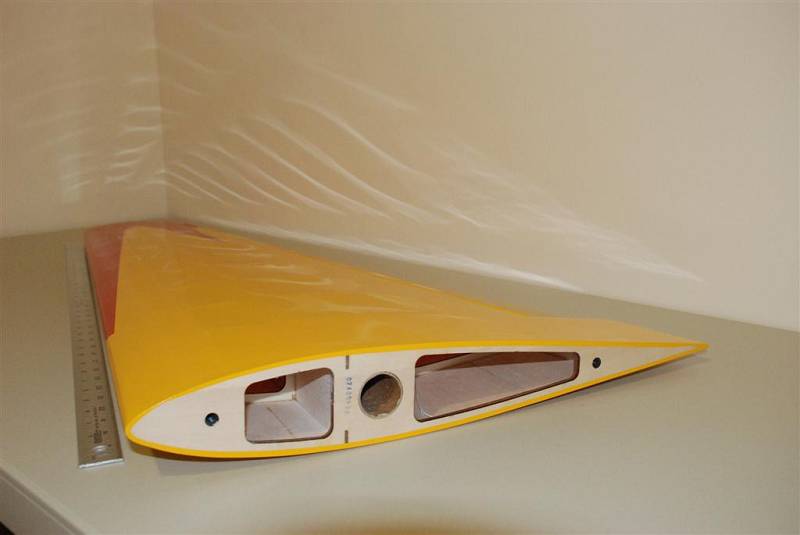

RE: BH MODELS (CAP 232)

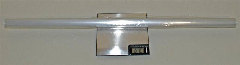

Hi guys,
My first thought was also about set it up with a gasser. But after I scaled and inspected the aiframe it seems more lightweight oriented. Example, the leading edges are half sheeted. I concur about the smaller BH Cap, I had one also. This one is definitely 3D capable. More pictures to come... when the kid keeps an eye on something else than the plane or the reflex cam which I tell you is way more difficult to control than torq rolling.
I am amazed there is not one who is flying it already?!

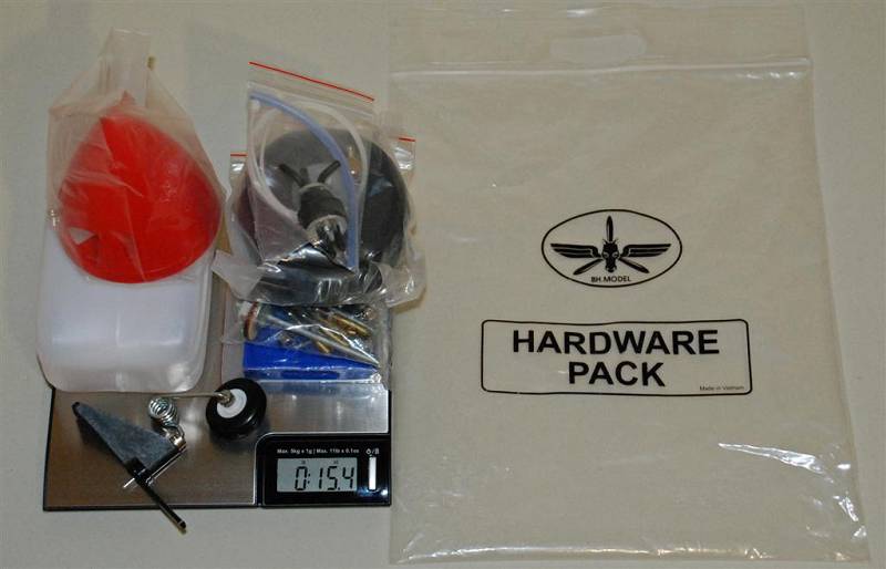

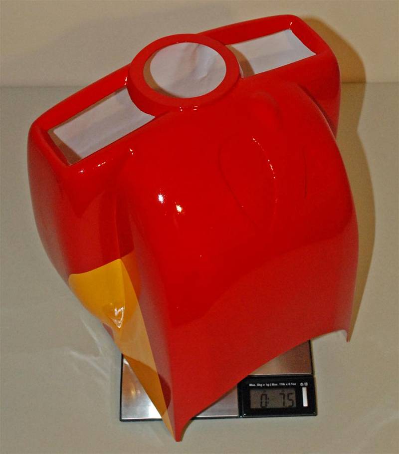

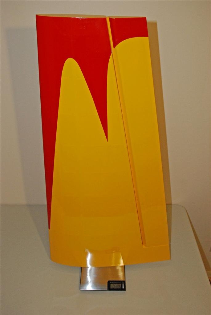

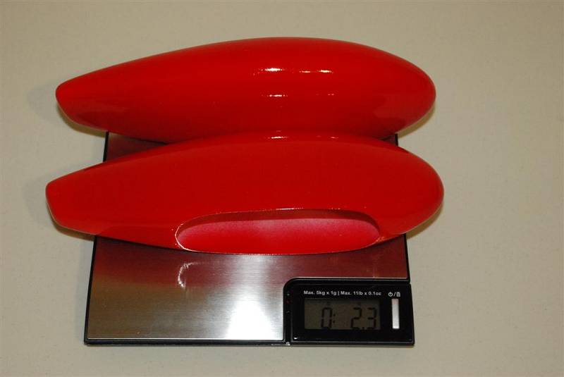

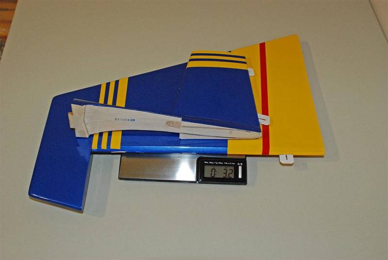

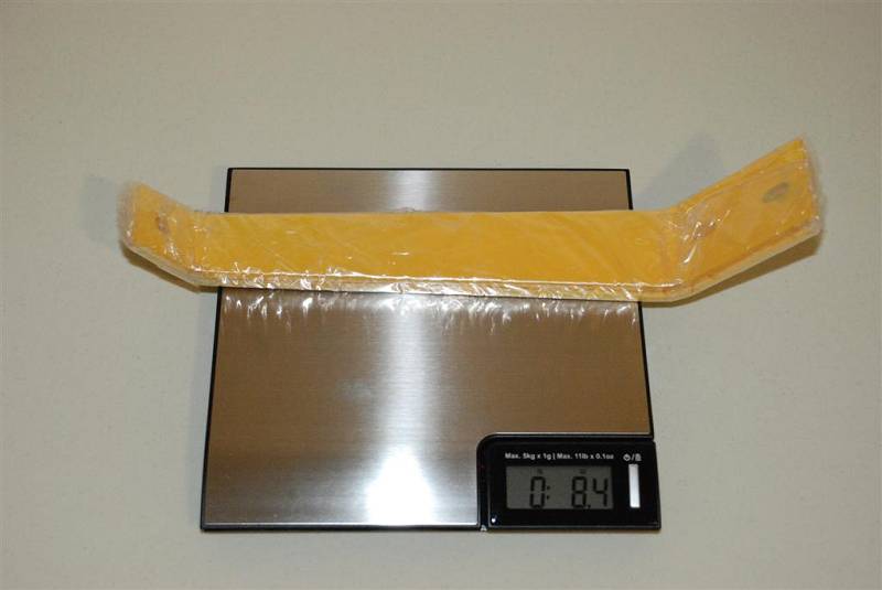

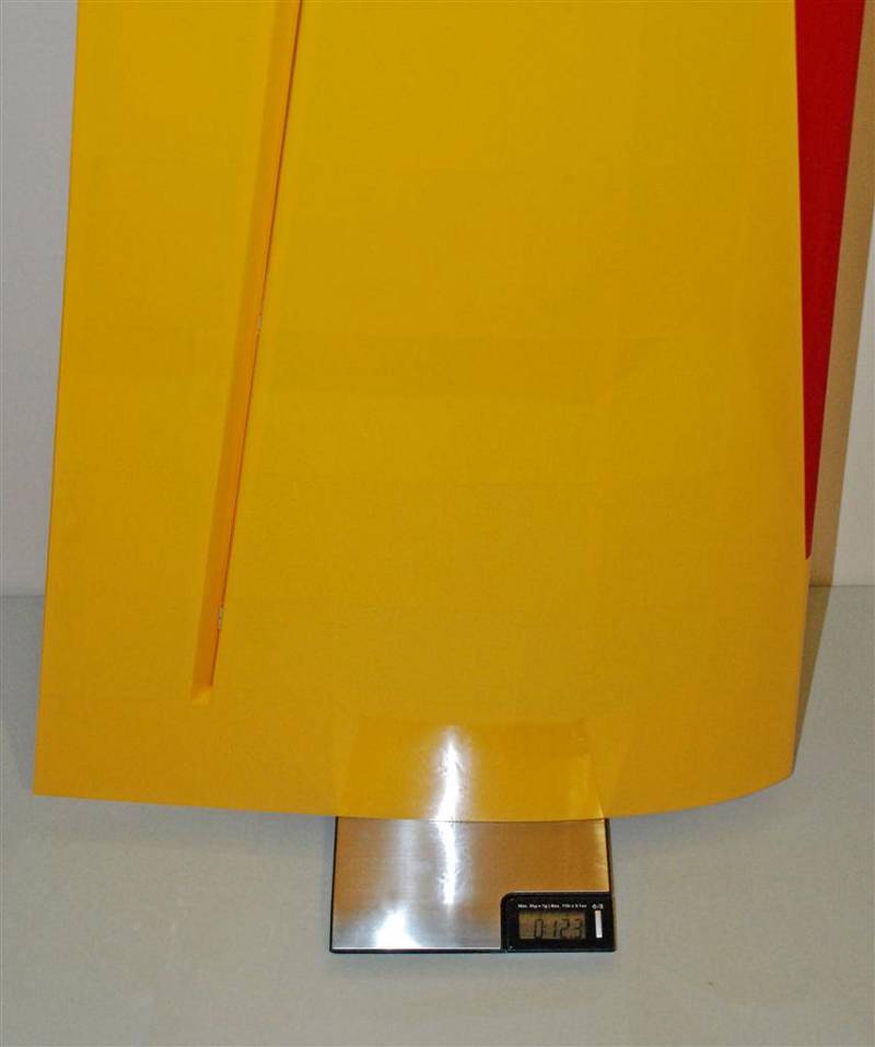

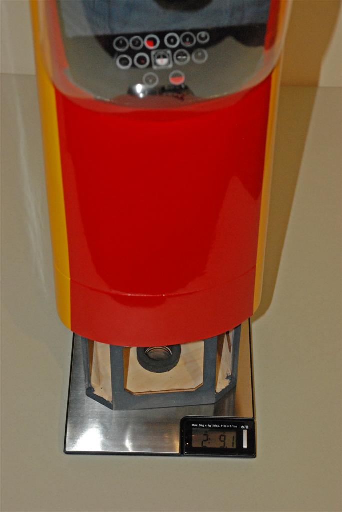

Just to confirm you've made a wise choice... .
Fuselage: 2lb 9.1oz
Wing (right): 12.6oz
Wing (left): 12.3oz
Vertical stab: 3.2oz
Horizontal stab: 4.6oz
Cowling: 7.5oz
Landing gear: 8.4oz
Wheel pants: 2.3oz
Aluminium wing brace: 6.1oz
Hardware: 15.4oz
Total: +/- 7lb 1oz
Remark, I added the weight of the stickers in my first measures.
As soon as I have some servos in the mailbox, I will be able to balance the plane and make a list of engines that could fit.

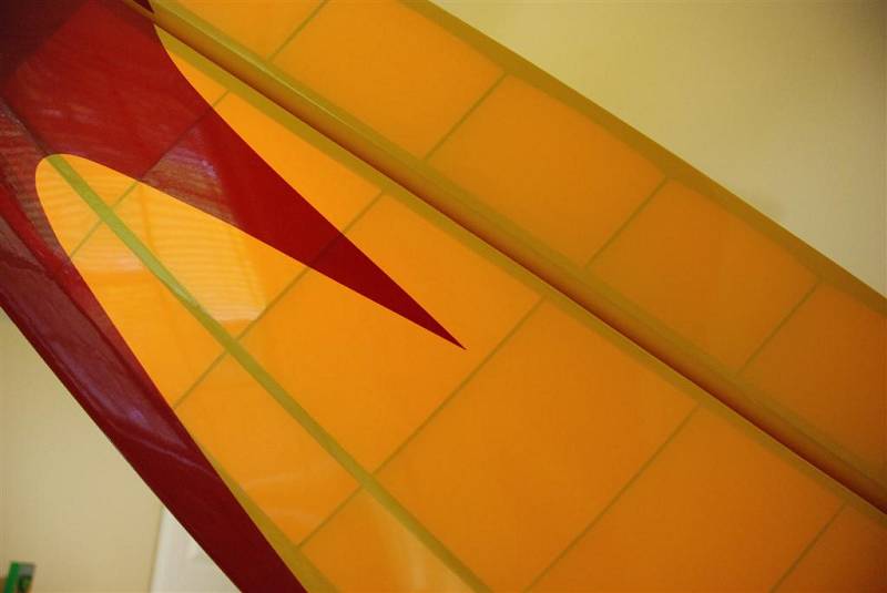

You're welcome TB. Pilot must be the Vietnamese size I guess.
With a little work you should be able to replace it. I might kick it out also and paint the canopy for a few onces less on the airframe.
With a glow engine, we should be able to keep under 13lb. with not much problems.
I just checked my pictures and forget to tell you that the bottom wing is flat yellow, no stripes or so. Some Ultra/Mono kote will be cool to have on your hardware list... if you do not have any in extra.

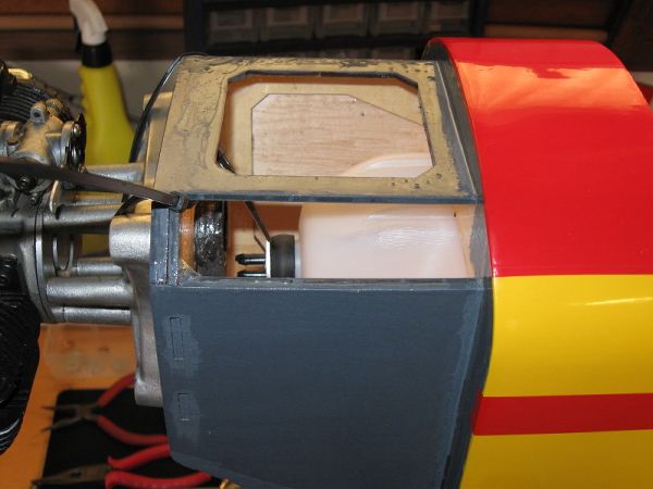

RE: BH MODELS (CAP 232-80)
Hi guys,

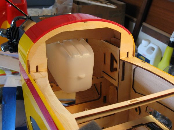

I took the plunge and bought the CAP, and I too was pleasantly surprised at what you get for your money! An even better, the Saito 270 twin fits perfectly INSIDE the cowl! Woohoo!
I have one question, though. I find the fuel tank position to be very strange. It seems that the tank is designed to be installed at about a 30 degree angle (front is higher than the rear). There is no sectional diagram to show inside the compartment, only some dodgey b&w photos in the assembly manual. What have others done about this? I am thinking of modifying it so that the tank will sit level, but I am not sure if I need to. My feeling is that as it is currently it should be fine when flying straight and level, but when inverted the fuel would run to the fron of the tank and starve the engine.
Any thoughts?
James.
Any thoughts?
James.

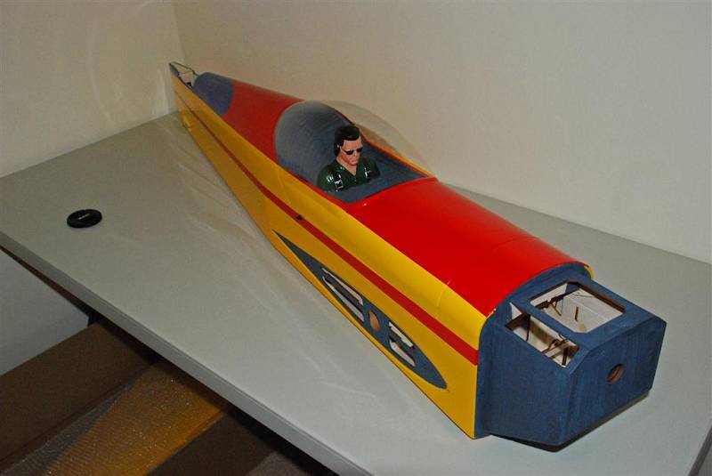

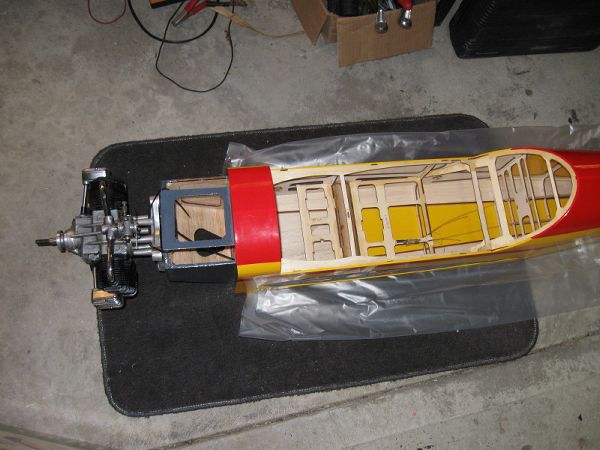

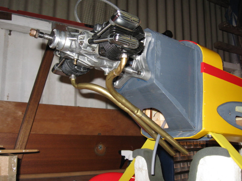

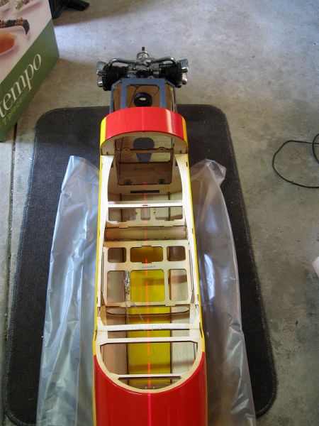

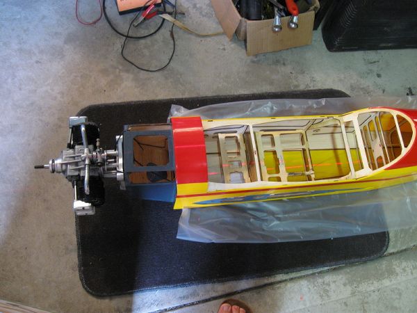

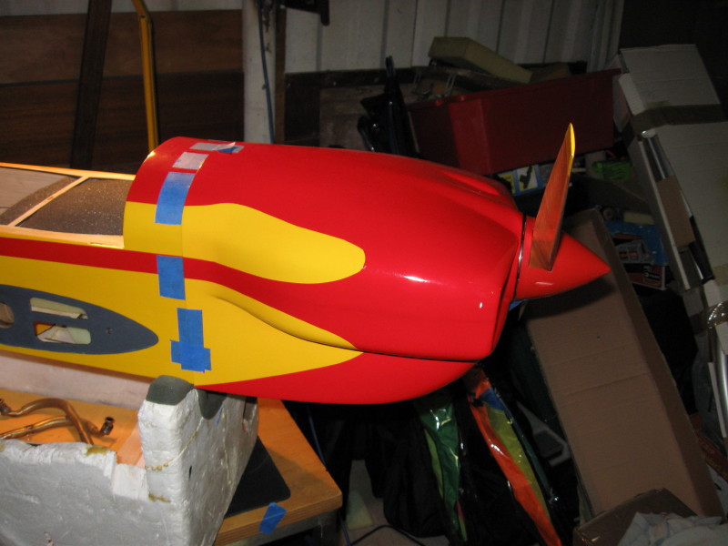

Hi guys,

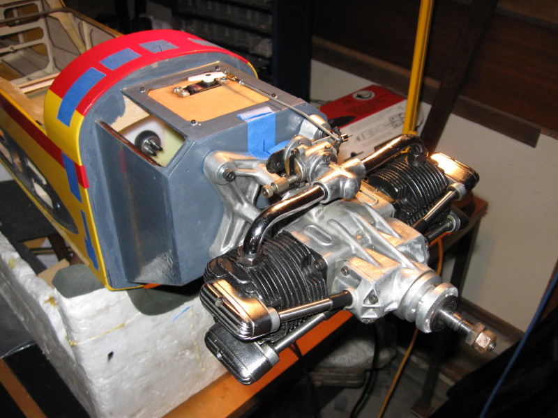

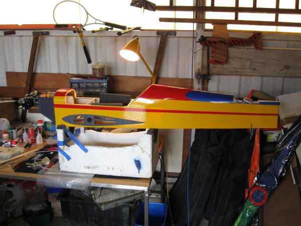

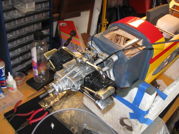

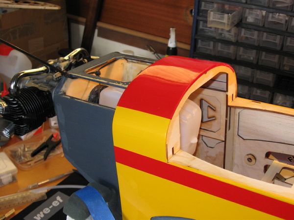

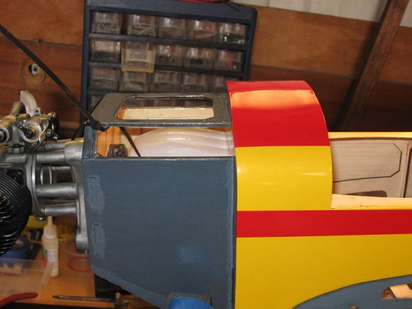

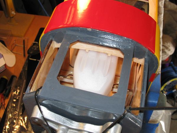

Here are some pics of my build so far:
you can see the tank in the "stock" position, which is at a fairly steep angle, and then when I have positioned it horizontally. In the horizontal position, the front of the tank is too low to poke through the fire wall. I am thinking to either modify former F2 so that the tank can sit higher and horizontal, or mount the tank over the CG. The latter may be better, seeing that I have the extra weight of the Saito 270 twin up front.
Also, you can see how I have lined up the prop shaft with the centre line. I used a laser level that my dad bought me years ago. Now I have found a use for it!

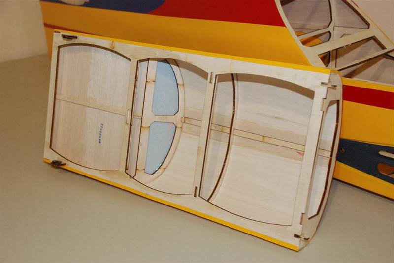

After looking at some of the pics that jymster posted, that plane looks to be redesigned, my bh 232 did not have a removable canopy hatch, this must be a new and improved??????????
JS615,
Yes, this is the "new improved" version, with removable canopy hatch and two piece detachable wings. It is built very light, as you say. Maybe even lighter than the original. The only things I do not like so far are the stock tank position and the flimsy ailerons. One of the ailerons was warped right out of the box, and it has been a real bugger trying to straighten it. I used a heat gun, and some of the covering has shrunk so much that the wood is now showing. [:@] The ailerons twist quite easily too, which concerns me. The control horn is only about 1/3 of the way out from the root end of the aileron, instead of in the centre, so I hope it does not twist. Someone mentioned that the older version had spaces for a second set of aileron servos in the wing? Mine does not have this, unfortunately. If I have any trouble, I may replace the ailerons with solid balsa ones, or at least a stiffer design. Will see how it pans out.

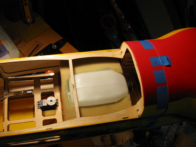

Hi guys,

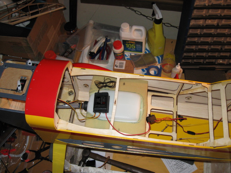

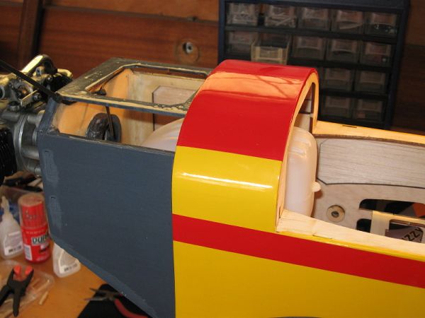

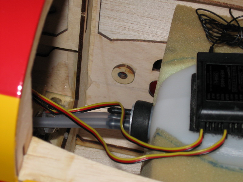

A little bit more done on the cap. Has been pretty hot here the last few days, though, so the garage has been a no-go zone during the daylight hours.[] Temperature was around 38C yesterday and today (approx. 100F). Is forecast to be the same tomorrow!

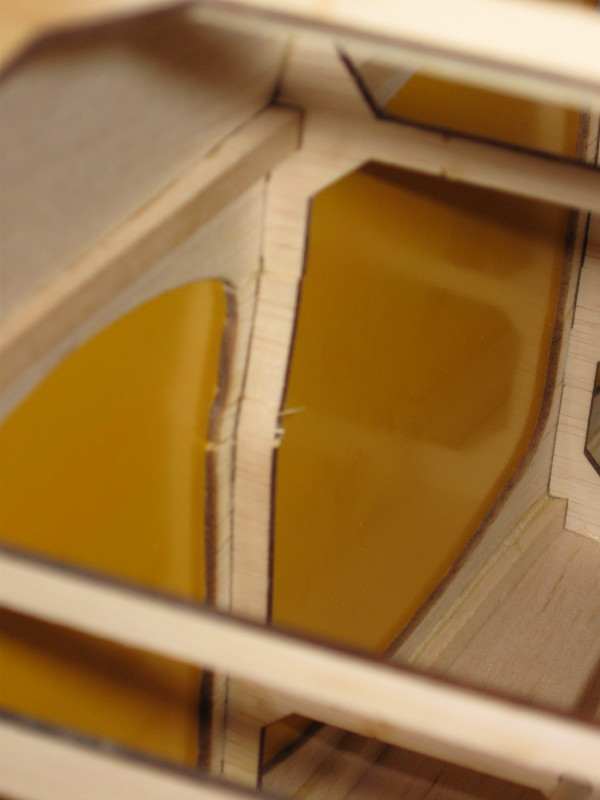

A little progress, though. I have decided to mount the tank near the CG. It is a little forward, but only just. I will have to deal with fuel draw issues if and as they arise. I have also mounted the throttle servo, on top of the engine box. I had originally envisaged this plate being on top of the box, with the servo mounted on top of the plate. Unfortunately the servo arm fouled with the cowl, and so I had to mount both the plate and servo underneath. My only concern now is that some fuel splatter may pool in this area. Again, will deal with this problem if an when it arises.

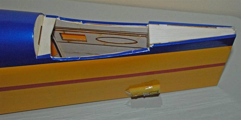

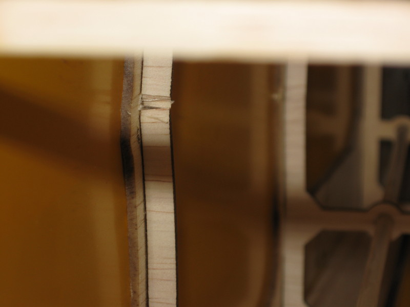

Also, I am not sure if it was the heat in the garage, or maybe my overzealous use of the heat gun, but it seems that several formers in the rear of the fuselage have collapsed. Probably a combination of both. This model is built a little too light, I think. I will try to prop up the formers with balsa sticks and see if this helps.

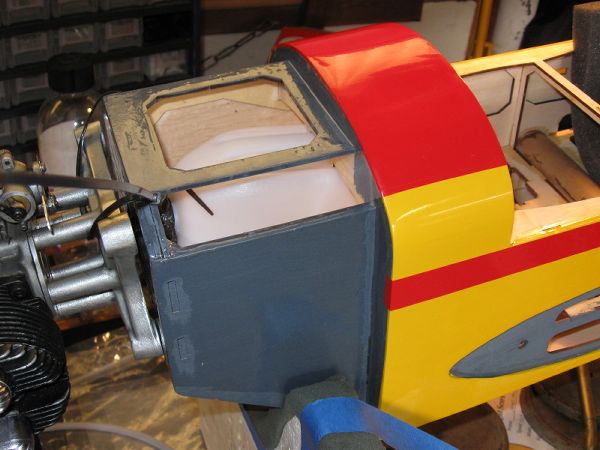

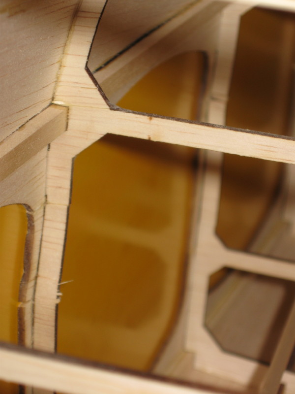

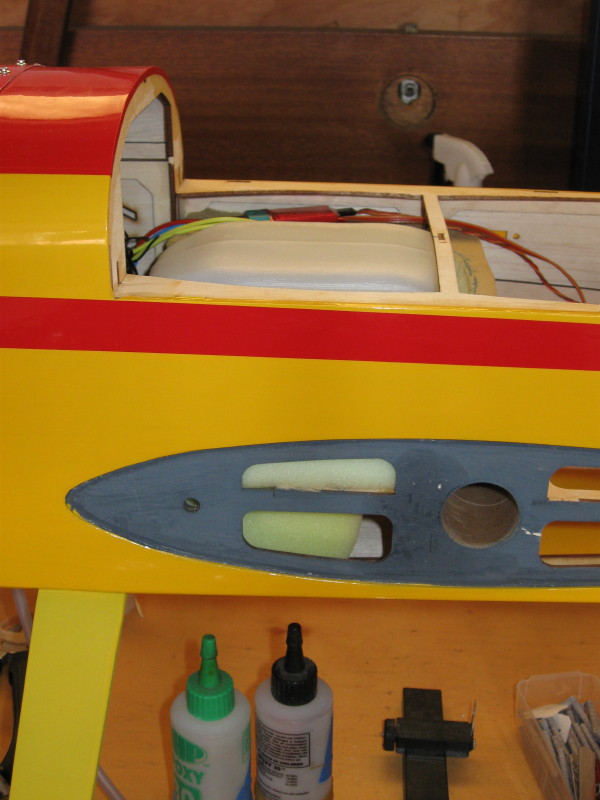

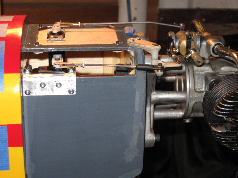

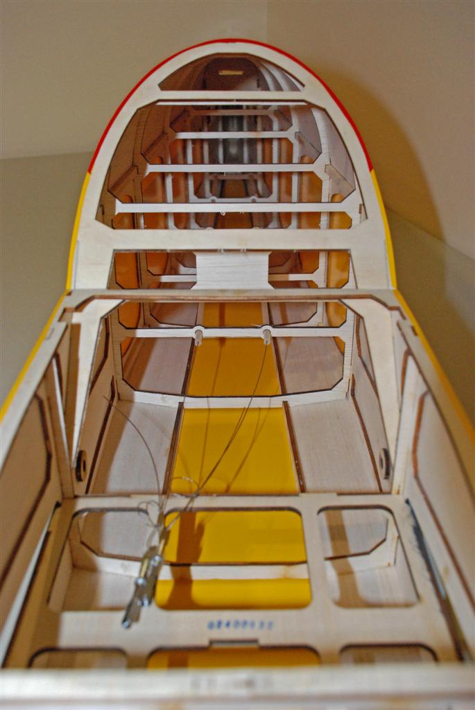

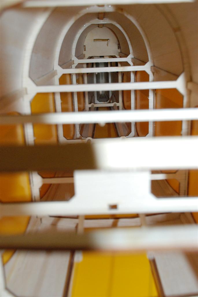

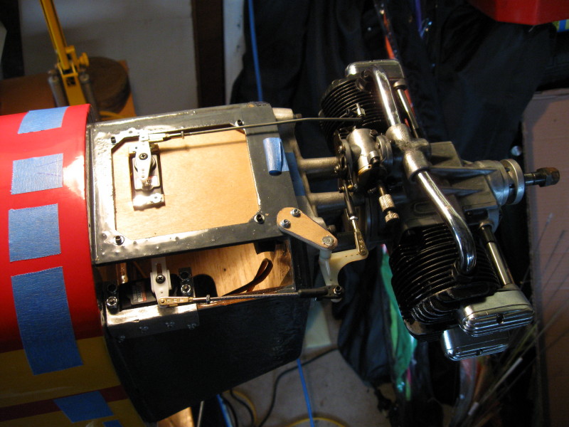

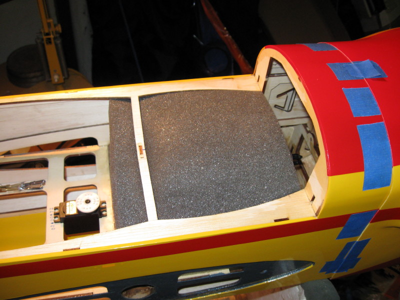

Another update.

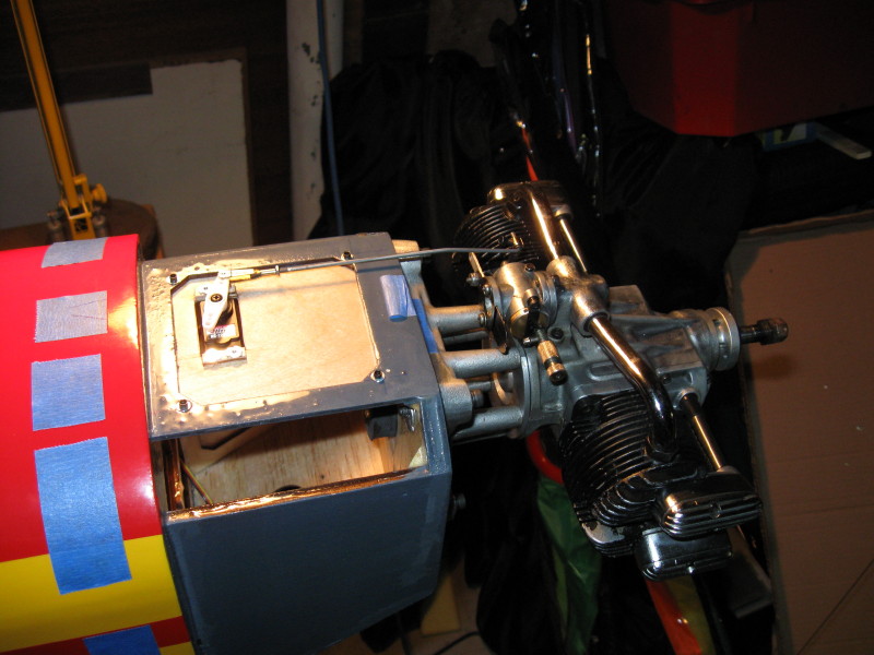

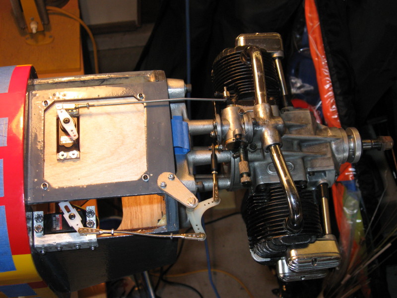

Have finished installing throttle and choke servos. Each is a Hiteci HS225BB. There is a small amount of chatter at the end points with the choke setup, due to the slop associated with so many connection points. But a little tap on the engine box stops this. I suspect that the with the vibration of the engine this should not be a problem.
I have moved the tank back even further than previously. I had it just in front of the cross bar above the wing tube, however this got in the way of access to the front wing fixing bolts. I may now have to use a Perry pump to deliver fuel to the carb. I have actually fitted a pressure nipple to each exhaust pipe, to see if this will work (pics later). But I guess the Perry should ensure reliability.

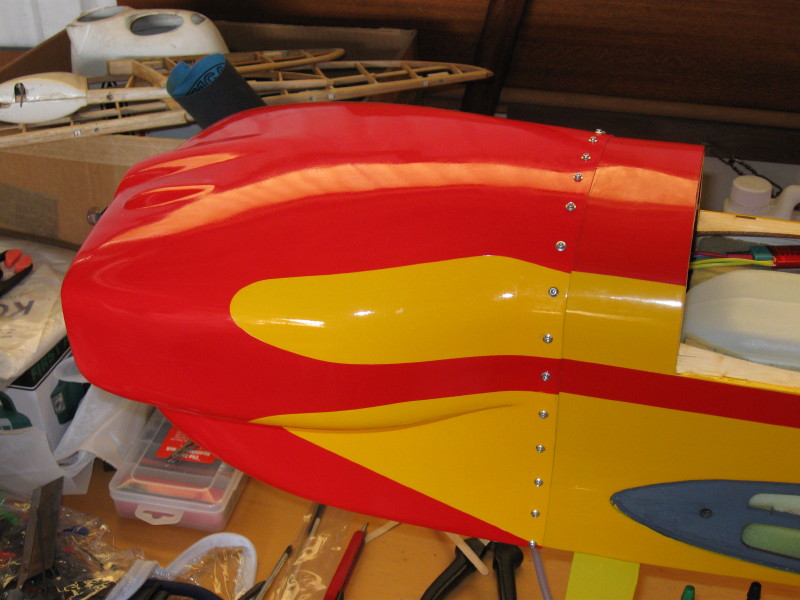

Cowl has been fitted. I decided to go with a more scale look, and used a bunch of screws to fix it on. In the end, I think I used a few too many screws. I have used servo screws for now, but will replace with #2 button head socket screws. The full scale has screws with a head diameter of approx. 18-20mm, so 4-5mm will be good. I will also put a row of screws along the part line of the cowl cheeks.
I have repared the broken formers using balsa sticks. Have also done this on the "good" side, just in case it decides to fail as well.
Installed a more scale-like tailwheel.
Now I am just working out how to lay out the wiring and reciever.
Hi James,

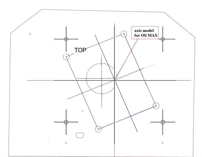

I bought one a few days. I have to put an engine of 45cc Chainsaw. I have two questions. How did the engine located? Mouting templates for OS MAX are right axle with 11mm (0.4 inches). You mounted the engine to fit in the cowl or used for mounting the axis for OS MAX. You have reinforced the wall of fire, it seems a bit fragile? What weight is your engine? Mine are completely 1865g (4.11 lbs).
Thanks for your help.
Migurel,
You will see from my post dated 1/3/09 (3rd January), that I actually used a laser line tool to get the centreline for the engine. I did not use the template in the box, as my engine is very different. I think it weighs about 2.2kg, so it is very heavy. Yes, I also used the cowl to position the engine properly. I did reinforce the firewall with lots of epoxy. I did not add any ply, but just epoxied all of the joints. I also fuelproofed the entire engine bay with epoxy.
I am currently having trouble with fuel draw, as I suspected. The model flys very nicely, however the engine dies when I do a high G up elevator manoeuvre. I tried adding a small 2oz hopper tank, to bring the level of the fuel higher, but the problem still persists. I am not going to try a Perry pump, to see if this will fix the problem.
James.
Hi James,
Thanks so much for your help.
I saw the device but I do not have something, I do the template of plywood and mounted the engine in various locations will match up. Because the engine is hard you had trouble center, had to put some weight in the tail?To Rx power you used something like PowerBox or servo directly mounted receiver. What hinges did you use, the original flexible?
On your engine, you tried setting a little more rich? The engine is new? If not, we saw that a certain number of hours the engines 4stroke be corrected in the valve seats with pasta sander. It could be this one case. You can try using a system that Yamada engines with engine pressure through a nozzle directly into the fuel tank and a one-way valve pump without Perry.
