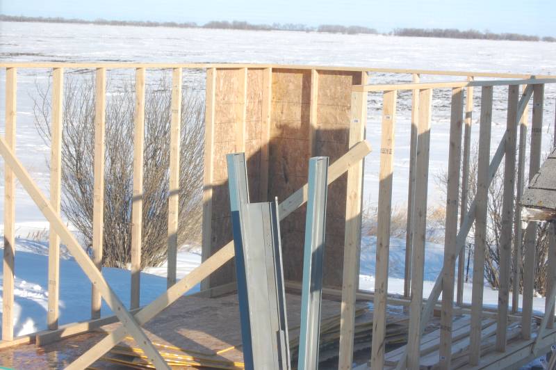

Thats whats good about north dakota! Ha the economy hasnt seemed to affect anyone here...due to budget surplus maybe? T1-11 is the siding were using. So 2' studs are too far apart according to you?? what happens when we already have the 2' stud walls already up?

I noticed that in the pic that is why I said something. You could place three 2 x 4's running horizontal between every stud. One toward the top one in the middle and one toward the floor. It will help support the T-111. If your studs are 2' on center then these braces should be about 22 1/2" long to fit inbetween the studs but measure twice and cut once. Another thing that will help is make sure you buy the 5/8" T-111. It is more rigid than 1/4 or 1/2". You said you are going to have 8' walls. Remimber that T-111 is only 8' long so you might have problems getting it to come down far enough to overlap the outside perimiter of the floor.

Just put your sheets on so it covers the floor and use your soffit to cover the 1 1/2 inch's at the top. Or add a small strip if it makes you feel better.....but do it on top....can hide it that way. Nice work so far man. 2 foot centers is fine. If there is no 2nd story then no need to be that beefy. Make sure to double up the top sill is all. If your putting the trusses on 24C as well they will line up with your wall studs and put direct load on the studs.

Alright thanks flaminheli, i think i will put the horizontal 2x4s in. There will be no progress until this weekend once again, work, and school. Any more tips/pointers will be appreciated. Also keep the mancave toys coming while i wait for the weekend.

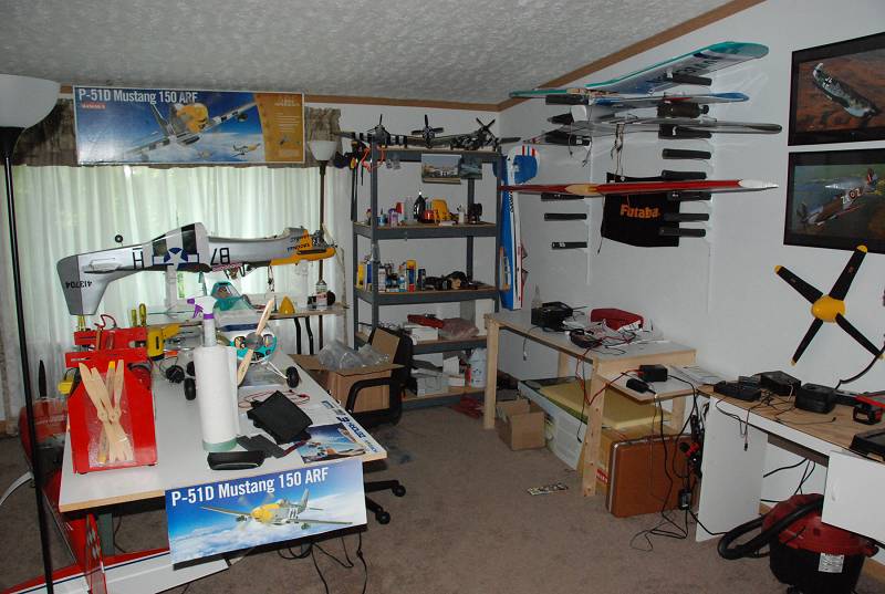

Heres my Man Cave. Its the living room that wasn't really being used for anything since we have a big family room. Off to the left I have a 36" TV with satellite hooked up. Love it. Took some convincing if you know what I mean.

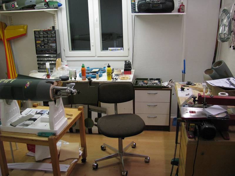

ihave 10m2 room for airplanes and garage for my cars and next summer we built new 96m2 garage.

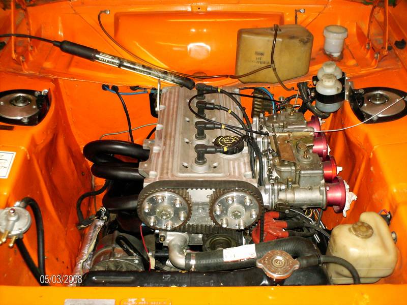

Nice little shop there Findland, I have to ask...what kind of car is that and is that a Cosworth engine?[8D]

ford escort mexico 1600GT with ford cosworth 2000cc 16v engine

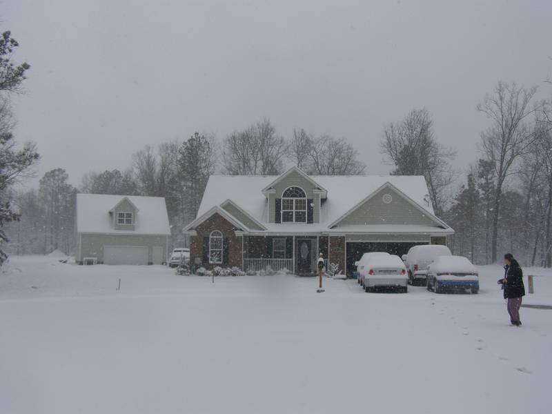

Since we are sharing pictures of our "man-caves" you can see mine here in the back yard. I started it this past summer and still have to get my heating/AC, electricity, insulation, etc. Also is a shot of my newest "used" ARF
