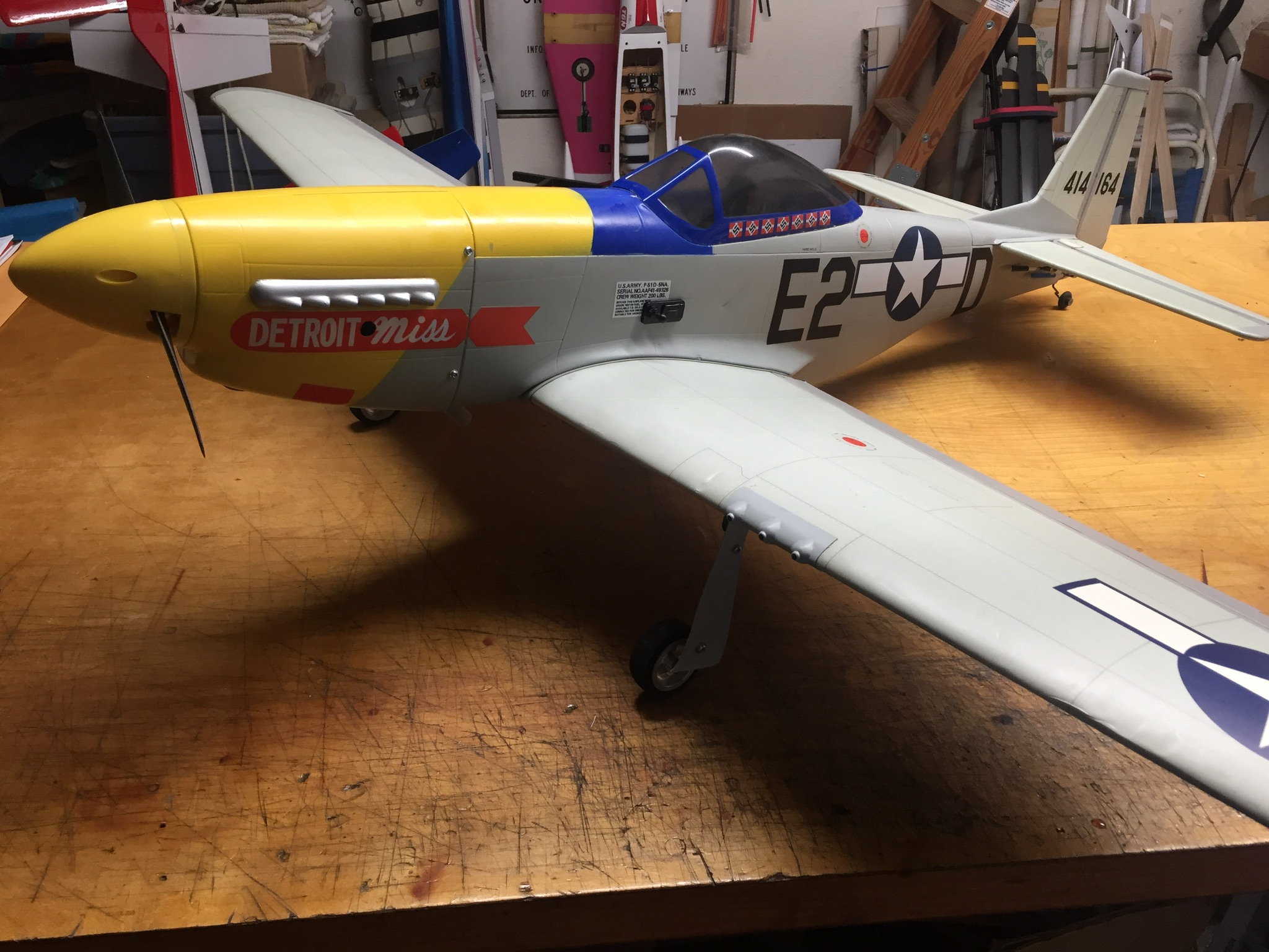

Resurrecting another one. Found it at a swap meet. Had been finished but never flown but was moved around so much over the years it needed a lot of work. The OS .28 in it was used so I pulled it apart and thoroughly went through it......runs absolutely great! I replaced all the original radio equipment with lighter and smaller servos to lighten it up a bit. Needs more cosmetic TLC but I don't want to invest any more time in it until I've put a hand full of flights on it.

Nice find!
I put in two of the 40 size Mustangs by EZ, guess I wasn't meant to own one lol

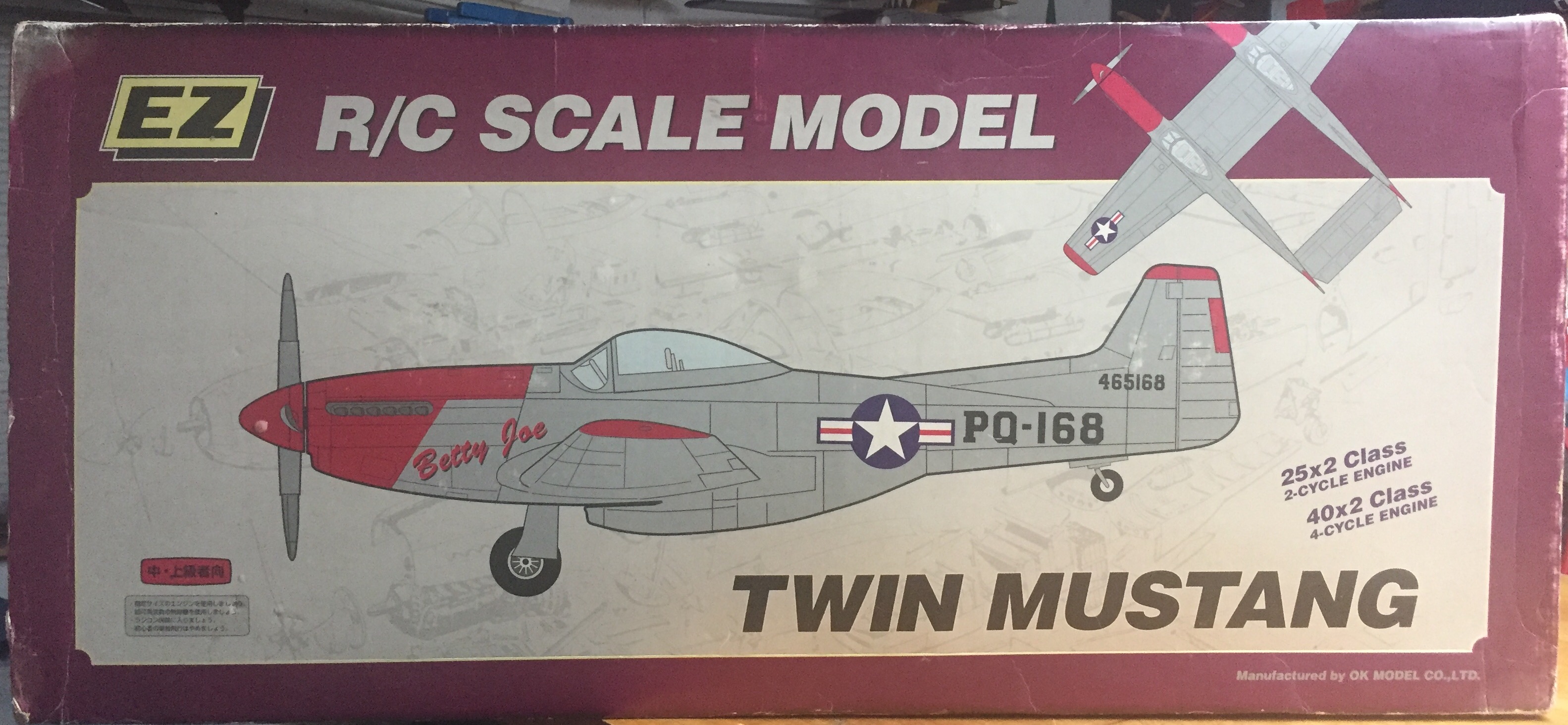

I've heard it said that when something is very rare one will tend to phrase..."It's rare as hens teeth".
Well I got pretty close.....a very rare find indeed I've been blessed to find!

Very nice find! i don't even remember that being available.

It was never one that was distributed in the U.S.
Sportsman Aviation made several models that weren't. Some were re-branded through Hobbico, Great Planes, Lyon Models and even Royal. Slight changes were made to some. For example the Hobbico Ultimate that was distributed years ago was brought in in the red, silver and blue scheme. In Europe is was under the E/Z brand and was the blue with yellow stripe "Bluehawk" sheme. Another one that is interesting is the Hobbico Diabolo versus the E/Z version. Absolutely identical with the exception that on the Hobbico version the horizontal and vertical stabs are aproximately 1" longer in overall width/height. I know this because I have both and have layed one on top of the other. At the root or base where these would be epoxied to the fuse the dimensions are the same .
Im assuming at Hobbico they said.....Yeah, we'll take "X" number of kits but we want these a little longer etc.
Smart marketing not to re-invent the wheel rather improve a touch.

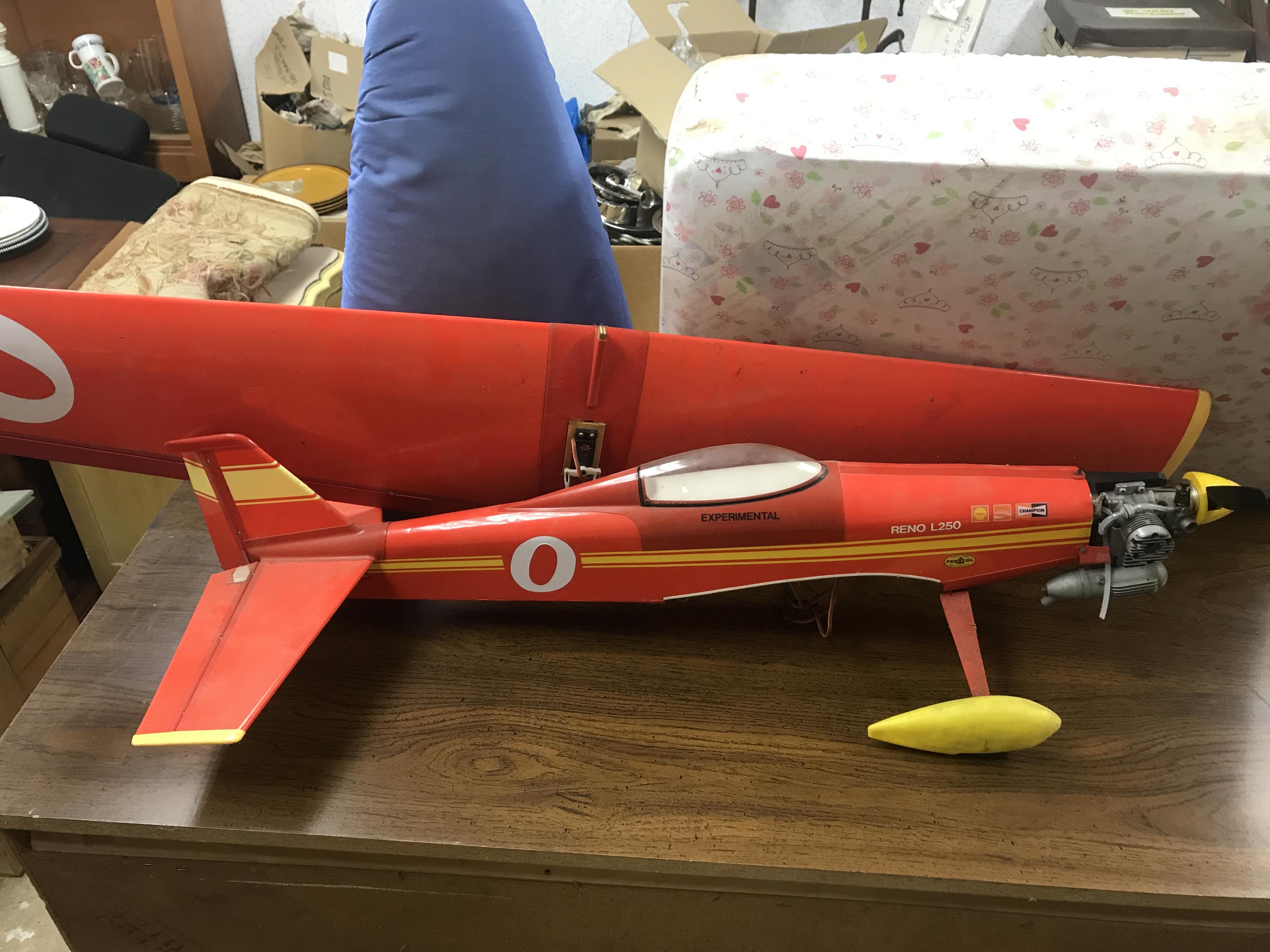

Selling this Reno Racer, I know nothing about this plane my Dad asked me to sell it for him while he was cleaning out his hobby room.
Asking 75 obo
