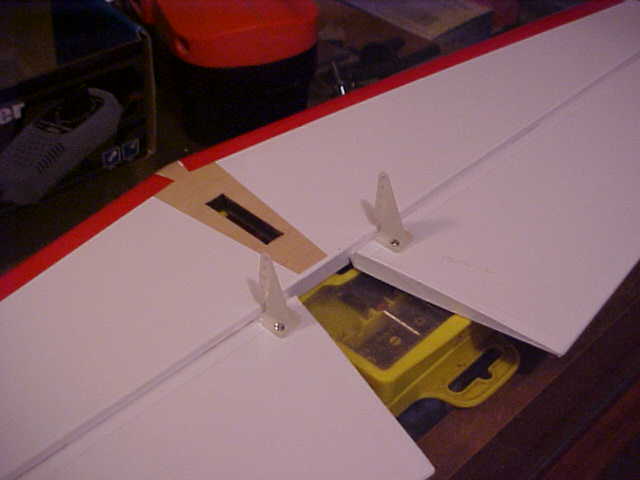

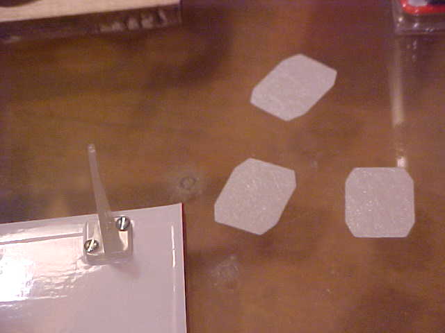

Heres a look at the new control horns VF is sedning with their ARFs The first shows the installed horn on the rudder and the hinges I plan to use, Gerat planes CA hinges.
Miloh.
Miloh.

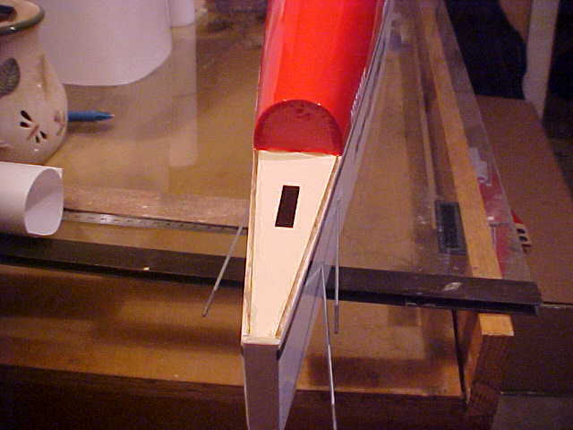

After setting up the proper position of the horz stab I marked it with a pen and cut the covering back to take advantage of all the gluing surface available.
Miloh.

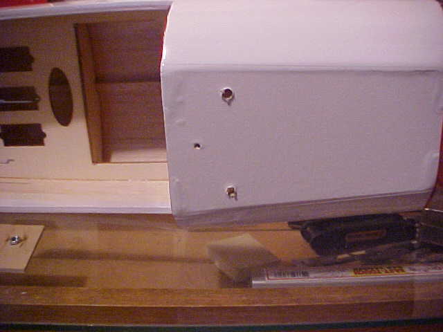

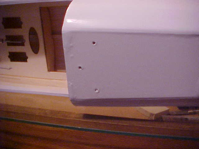

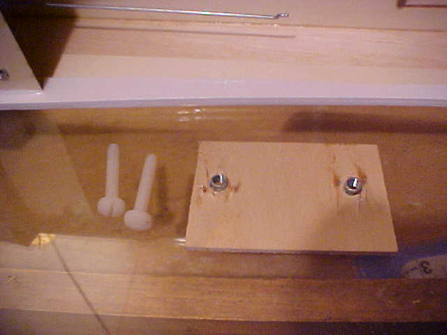

Now for the landing gear plate. I made a plywood plate and installed 440 blind nuts then drilled the bottom of the fuse. The ply plate will be epoxied and pulled down tight with the nylon bolts. Hopefully the bolts will go before tearing the gear plates out. Hopefully nothing will have to break. Should see saturday morning.
Miloh.
