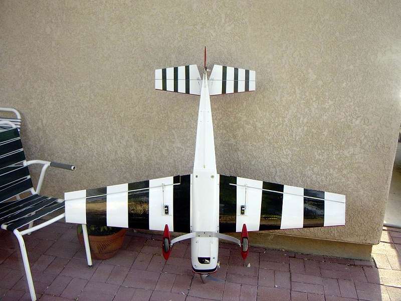

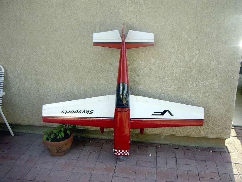

I now have about 40 flights on mine and it just keeps getting better with every flight. I removed the original magnum 91 4 stroke and installed a Thunder tiger 91 4 stroke. The magnum engine never gave me any problems and flew the plane great. The only reason that I changed the engine is because the TT engine has a little better performance. I use an APC 14x6 or 13x8 prop and the plane now has a little better vertical performance. I had to relocate the battery about half way back to the tail to get the plane to balance on the CG. Here are a couple of pictures.
Rick

What size spinner is that?

It is a great planes 2.5 inch.

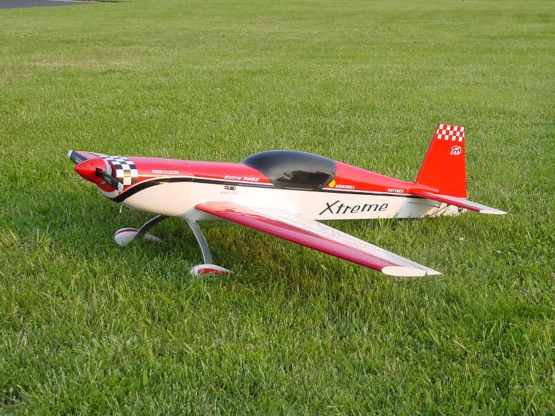

It's a flyer!
Went great, The bird flys beaeeeaaaaytifuuuully
