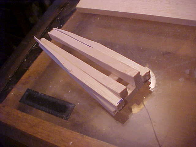

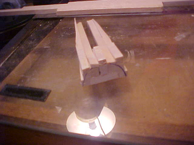

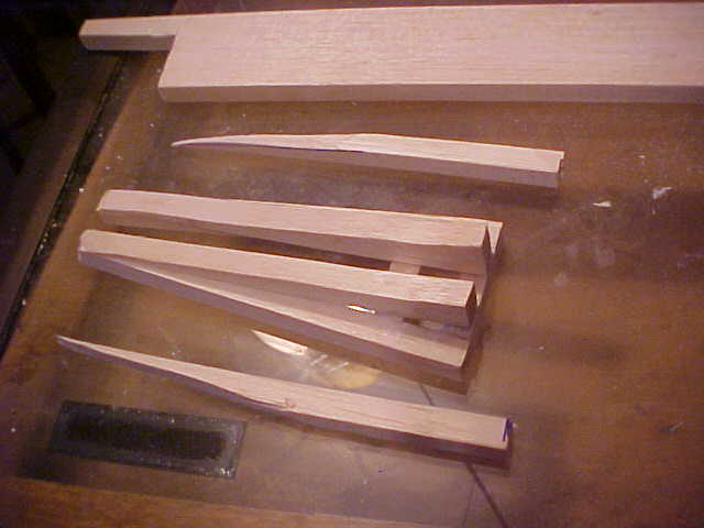

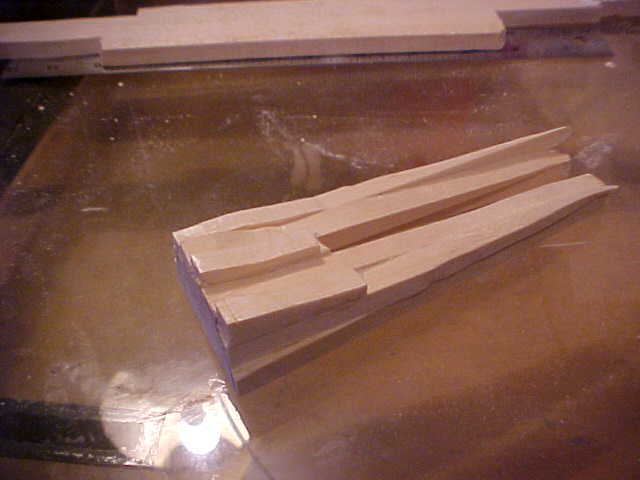

Ok Guys a little more this morning. The last thing I worked on last night was the plastic piece that goes on the back over the horz stab. I got it all cut out and placed but just didn't like the way it looked. So I decided to do it with wood like David Moen. If David had not done it this way and told us I probably would not have thought of it. I did not carve mine I built it up and sanded to shape. the first pict shows the piece of balsa I started with. I just cut in into planks and started gluing it together. Heres a pictoral that can be used as a guide. It took about an hour to make it. Enjoy.
ID:	71183   Click image for larger version
ID:	71184   Click image for larger version
ID:	71185   Click image for larger version

This piece weighs 6 grams or 1/4 ounce uncovered and looks real good. It will also work for added stringth in the tail feathers. back to the building board.
Miloh

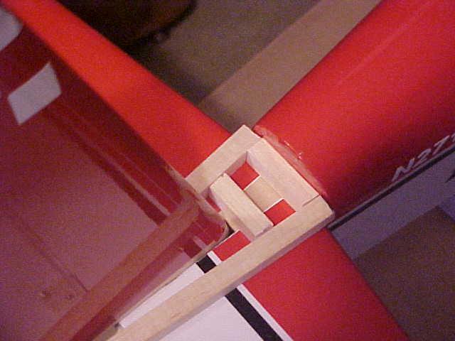

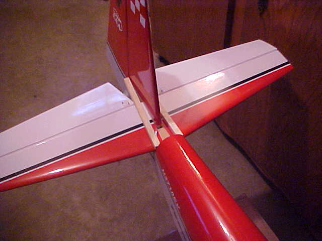

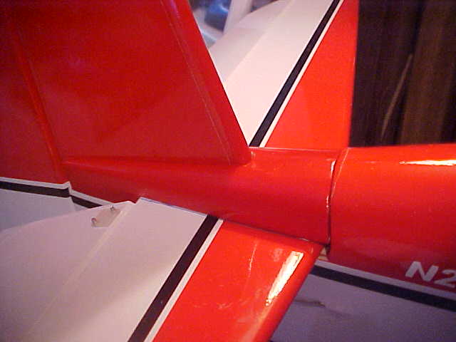

Alright here it is all covered and installed, Prety nice if I do say so myself. It gives a lot of gluing serface and should make the tail feathers bullit proof.
Miloh.

Once again VF has blown my mind with their continued effort to make their customers happy. I sent them a picture of the mod on the tail faring and this was their reply.
Miloh.
Dear William:
Thank you very much for your message. The balsa tail fairing is very nice! Also thank you for your input regarding the landing gear plate. Both of these parts are under design review and hopefully will be modified soon.
Thank you again for taking the time to write to us. We are grateful to all our customers whose feedback is an essential part of our ongoing improvement process.
We will be soon changing the materials of the belly pan and the wheel pants, to a much stronger plastic, similar to the cowl's. As soon as we have these available, we will be happy to mail a set to you. If you do not automatically receive a new set within 2 weeks, please send us a reminder e mail.

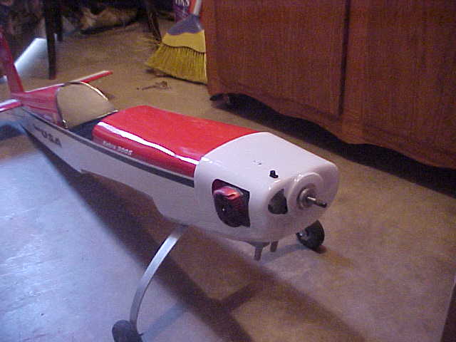

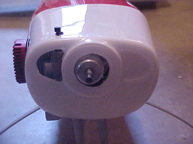

MORE PICTS:
I had to get my slide rule out for the motor mount and cowl setup. As you can see in the picture of the front I got some right thrust in, not sure how much. I put two small washers 1/64 under both the front motor mount bolts. no down thrust at this point. For the cowl I cut and cut.....and cut some more then I cut some more LOL. finally..... It's not up to my standards but it will work. Getting into the back of the firewall to position the blind nuts for the new motor mount was a challenge to say the least.
I'll say this bird is tougher that I thought it would be, I use a glass top on my building table and it's 36 inches to the concrete floor. not having the wheels on yet the plane wanted to slide around a lot and when I turned my back one time it fell off the table and landed upside down on the vert stab and cowl!!!! not a mark. and when I was trying to get the orig motor mount blind nuts out I put a bolt in from the front side and pounded them out. It got pretty violent and every held very nicely.
Anyway It's coming along pretty good so I'm headed down to the hobby shop so I'll post some more later this evening.
Later, Miloh.

David Moen: The cowl will only go so far onto the front of the fuse. At the point that the cowl stops My motors shaft was still hidden inside the cowl. the only way I could figure to get the cowl far enough onto the fuse for the shaft to potrude enough to put a prop on it was to cut the back of the cowl off so it would slide further back on the fuse.
Did this all work out for you without cutting the cowl?? if so what motor and mouht did you use?
