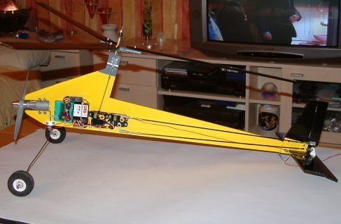

This recent Saturday I tried to fly the Ciervia given to me. Contrary to what "Kwmtp" said, I tried to take it off from the ground. Every time it would veer off to the left on the left wheel. Bob Haines who gave me this rotorcraft said that the rudder and rotor tilt need to be at 5 degrees to the left. Is this true? If the plane would veer to the left, wouldn't it need right rudder and rotor? A couple of heli pilots came over and tried to help, but they really had no idea what they were talking about.

Hi Kyle...
I surely agree with Phil...taxi take-offs with gyros are tricky. Side wind gusts can tip it over before the rotor is up to speed and frequently you run out of runway or by the time it lifts off it's so far away it's easy to lose orientation.
One approach you might find helpful is to hold the gyro with the nose up at about 45 degrees, while walking slowly into the wind. Give the rotor a spin by hand and keep walking until it really is pulling upward. Then lower the nose to a level flight attitude, give it full throttle and "feel" if the plane wants to tilt one way or the other. Correct the tilt tendency with lateral trim of the rotor until the plane feels as if it want to fly level. If it feels as if it wants to fly....go ahead and release it with a GENTLE push...better if is just wants to fly out of your hand while still walking into the wind.
Once you have it trimmed properly, then taxi take-offs will probably be easier.

Hi,
During my recent Giro developements the initial problem was the
craft tilting at lift off time of the take off run.
Full scale Giros would be tough to hand launch, so they all have
had to take off themselves. If our objective is to emulate full scale then take off is a primary part of it
To cure a problem one needs to know what it is and the cause. Research found the tilt was caused by retreating blade stall, more precisely a differential in lift between the advancing and retreating blades.
A rotor accelerates from zero RPM to flight RPM. In that process a point is reached where sufficent lift is present to leave terra firma even though flight RPM has not been achieved, It is in this RPM spectrum that retreating blade stall occurs. Fortunately the spectrum is small and is not present during flight
The obvious solution to no tilt take offs would be to get through that RBS spectrum quickly, full scale learned to do it by prespinning the rotor, that should work for models also if there was a means.
Happily a simple means was found. We wind the prop up to start the engine why not wind up the rotor to start take off?
Proved to be easily done, add a prop spinner to the blade hanger, use the engine starter motor or better still a power drill and simply wind the rotor up. Question could be how many RPMS is sufficent, Easily determeined. Use wind to wind up the rotor, tach the RPMs, the speed where lift starts to occur would be the minimum spin up rpm.
Proof of the pudding? Since using prespin for 100s of take offs there has not been one abort of any kind!
Hope I have been of some help, do have fun !

Kyle,
Did you get the manual with the "C.4"? It's very explicit about 5 degrees left tilt and 5 degrees left rudder as THE starting point for the "maiden" on the "C.4".
If this is your first toy autogyro and the "maiden" flight for this "C.4" by all means do what the manual says and hand launch! Did you receive the video for the "C.4" with the model? It shows precisely the proper hand launch takeoff technique.
Where do you live? (Perhaps we can get you paired up with an experienced toy autogyro pilot?)
