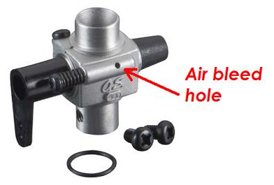

This filter will help avoiding the foaming or bubbling and the junk accumulation in the needle:
http://www3.towerhobbies.com/cgi-bin...&I=LXD741&P=RF
For this engine, the little air intake hole at front of the carb stack get clogged with little particles (like grass seeds) some times, messing up the low end adjustment.

There's nothing to go wrong with the LA carburetors. If the fuel passages are open, they're pretty much bullet proof. But it doesn't take much to block a fuel passage. A small piece of plastic from the tank (the size of the head of a needle is huge) is often all it takes.
The airbleed screw should start with the air bleed hole 1/2 blocked, and then adjust from there. If the end of the airbleed screw has been damaged, that can screw things up (sorry about the pun) as well. A small piece of dirt or grass in the hole will drive you crazy chasing the tuning.
