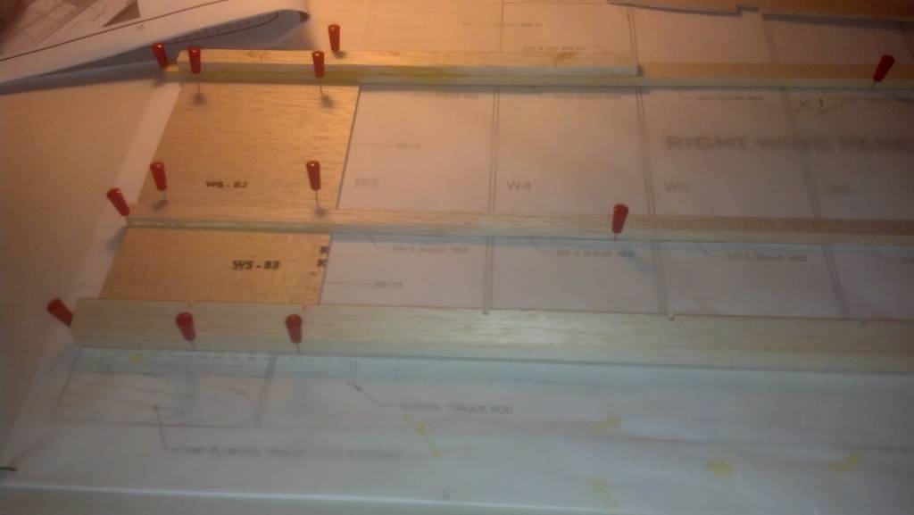

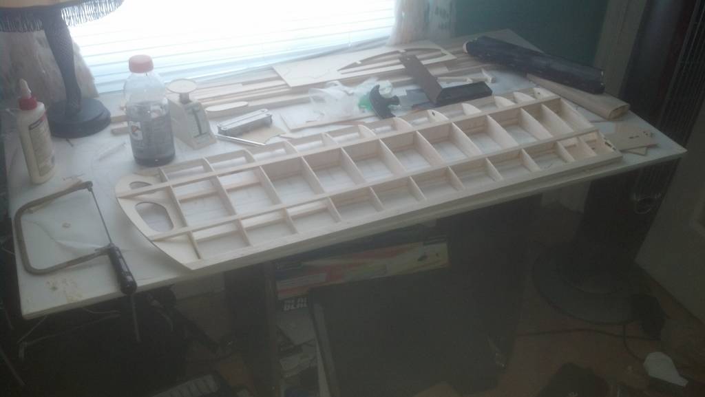

Ok so quick update.... I was on a 3 day off from work and was able to get alot done... even so there a lot more to go. Got both wings constructed mounted motor on fire wall and did the fusealge doubler. I stopped here because I'm still trying to figure out how I am going to go about the tail dragger conversion. Post to follow just adding pictures now cause i cant from my phone. Sorry for the blurry photos will try to get some later.

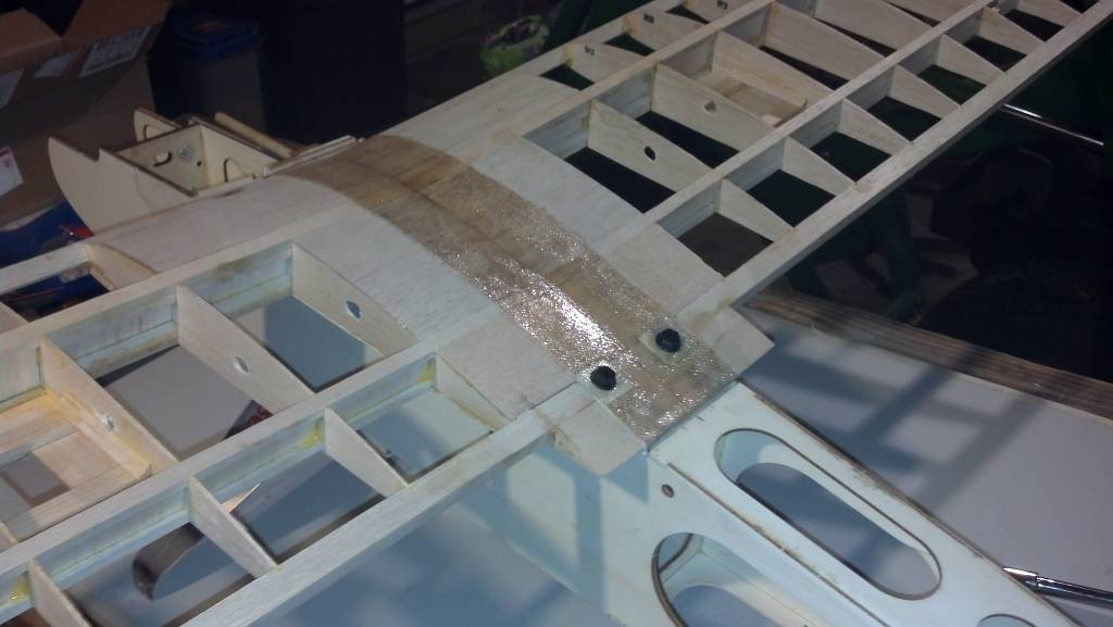

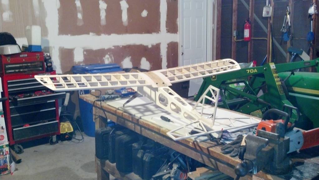

Yeah so anyway I still need to finish wings as far as joining them and installing the airleon servos and completing the bolt on mod. <div>
</div><div>I am gonna complete the plane as a taildragger and want to do it now because it will be much cleaner and i dont wanna tear it apart in a few months to do it. The areas j will fly at are both grass fields so thats why im doing it.</div><div>
</div><div>Yes i used the search function but have yet to find a step by step WITH pics (most have dead links) showing how to do it. I get it for the most part but wanted some opinions on wheel size, wheel brackets and whether to use a pull pull system, direct to servo connection or connected to the rudder conection. It seems they all work but i would like to know which is best. For instance a pull pull system seems the most sturdy but adds more weight.A direct connection to servo is good but the rod may need more support guides due to warping instead of fully pushing. and then the connection to rudder ive seen post of people busting a part the rudder due to stress caused by rough landings.</div><div>
</div><div>thoughts? </div>

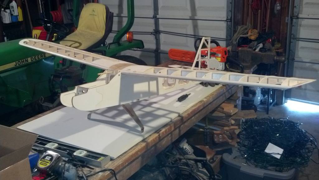

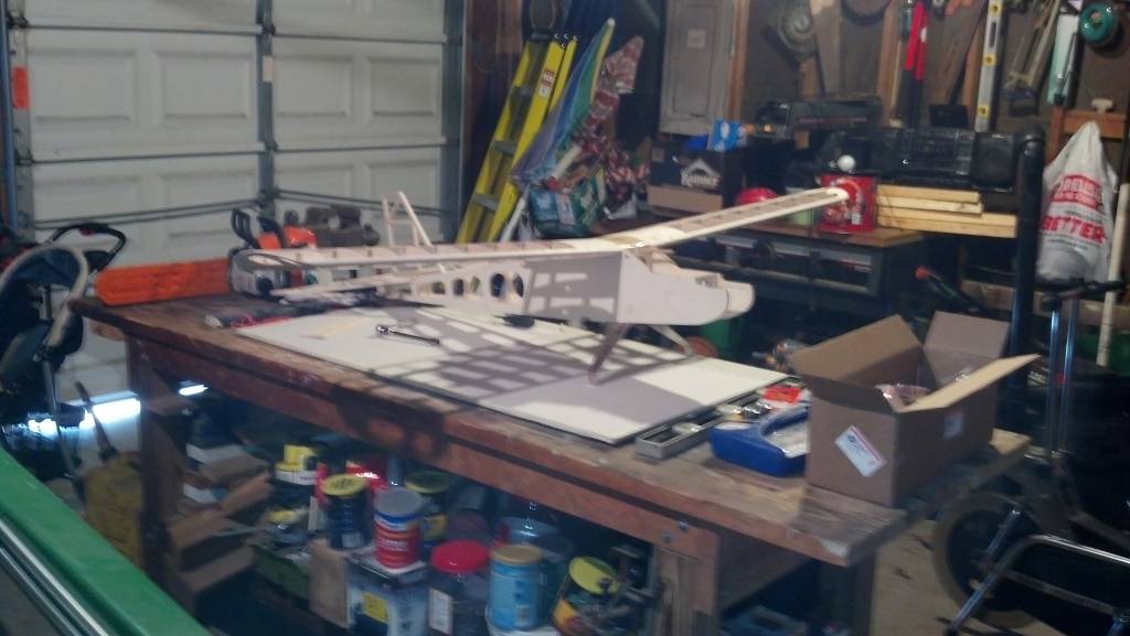

Quick update... nearly finished main construction just need to install landing gear and support for it. Install stabilizer and do the covering. Is it worth keeping the fin off til i cover it? I have been ordering stuff as i get paid. All i need now is covering, iron, reciever and battery... oh and fuel and I think im good to go.
