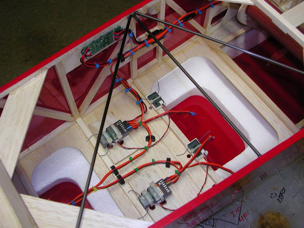

Anyone notice in the OP's photo... the wire to the second receiver is draped over the ignition battery... you keep these two systems (ignition and radio) as far apart as you can. And there is no ignition wire to plug into the receiver.

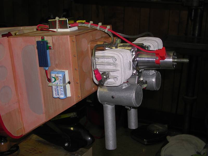

1. The Ignition batery wire runs from the 2000MAh battery pack to the kill switch and then back doown under the gas tank to the ignition. I thought this could be an issue so I removed this and went straight from battery to ignition with no change. When I have the battery connected to the ignitino direct I did move the battery up in front of the received but there was still no change.
2. I have a ball connector that is plastic connected to a metal push rod that connects to the servo with a metal connector. this is only about 3 inches long and does not run along any wires. I am going to change this but I assumed that as long as the connector was not metal to the engine it would be ok. maybe not.

1. Keep everything associated with the radio separated from everything associated with the engine by at least 8 to 12 inches. The 14 you were quoted is gold plating <imnsho>. That means the switch, the battery pack, and the ignition module all need to be 8 to 12 inches away from the receiver and any servos.
2. Always use a golden rod to connect the throttle linkage to the throttle servo that is back by the radio gear in line with Rule #1.
3. Always use a resistor plug.
4. Never allow metal to touch the engine or its mounts because it WILL create RFI you don't want.
I see by your pictures and text that you violated at least 3 of those rules and that is probably why you have a problem. I think if you correct those, your problems will go away. I very strongly suspect the solid throttle rod is playing antenna and transmitting RFI splatter to the throttle servo lead which is carrying it back to the receiver. Even in 2.4GHz systems, the IF strip inside can be swamped.

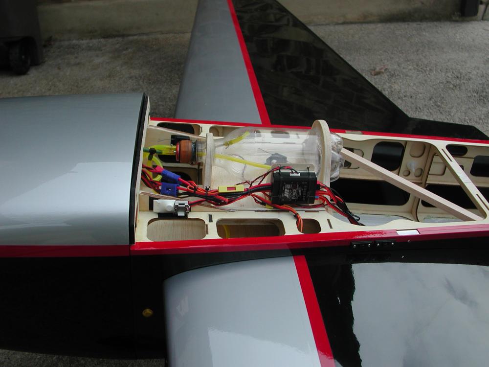

Hello and thank you to anyone that can help.
i have completed my first gas build and it is a treehopper and I have installed a DLE 30 with Walbro carb and electric ignition. Yes I an a noob[img][/img]
I am using a Spektrum DX7 with spektum AR8000 received
I have the throttle servo mounted right behind the firewall. The Electric ignition is about 3 to 4 inches away and under the plywood that supports the servos and fuel tank and about 8 inches away from the recieved that is in the back section. I do have the recieved close to the battery but I do not think this is a issue as none of the other servos jitter or move. See picture below. The ign wire does run out the firewall next to the throttle servo and the throttle servo wire i have run above the plywood and as far to the other side as possible. It is next to some of the kill switch wires but not touching. I can start the engine and keep it at idle but if i give it any throttle it wants to jump to full throttle and back down or it kind of jitters around unless i keep it at the lowest thottle settings.
So where and I going wrong? I have tried to mess with some of the wires to see if one of them in the back makes it worse or better but so far no luck. I have thought to move the thottle servo back behind the gas tanks and move this up but it will still be about the same distance away from the ignition but it would get it away from the ign wire. Anyone have better ideas? Or should i just put in a huge electric motor and not fool with the gas? [img][/img]
Dlvsm<br type=''_moz'' />

I have a DX7 and two DLE 30 gassers and both have the servo just in front of the fuel tank no more than five inches from the ignition (if not much closer) and not one minute's problem ever. I agree with some of the posters that imply to isolate this down one thing at the time until you nail it.

<span style="font-family: Calibri, sans-serif; font-size: 16px;"> First off thank you to everyone who helped or had advice! Thank to one poster I did not see who as there are many replies and I had tried just about everything here but alas I finally figured out the RF issue I have been having. I was about to move the servo but before I did this I thought I </span><span style="font-family: Calibri, sans-serif; font-size: 16px;">would</span><font size="3" face="Calibri, sans-serif"> try a different brand servo like one poster had suggested. I had used a Hitech and the first install but it got fried so I bought another one but was still having the issue but just not frying up as I had added limiter or resistor whatever it is called to the receiver. So this time I bought a Spektrum servo that was </font><span style="font-family: Calibri, sans-serif; font-size: 16px;">about</span><span style="font-family: Calibri, sans-serif; font-size: 16px;"> $5 more but I figured it matched the receiver and sure </span><span style="font-family: Calibri, sans-serif; font-size: 16px;">enough</span><font size="3" face="Calibri, sans-serif"> problem fixed. Not the kill switch or any of the mess of wires I have in there just a simple crappy servo! Now off to the field to see if this thing will fly!! Thanks again!</font><div><span style="font-family: Calibri, sans-serif; font-size: 16px;">
</span></div><div><span style="font-family: Calibri, sans-serif; font-size: 16px;">DLVSM</span></div>
