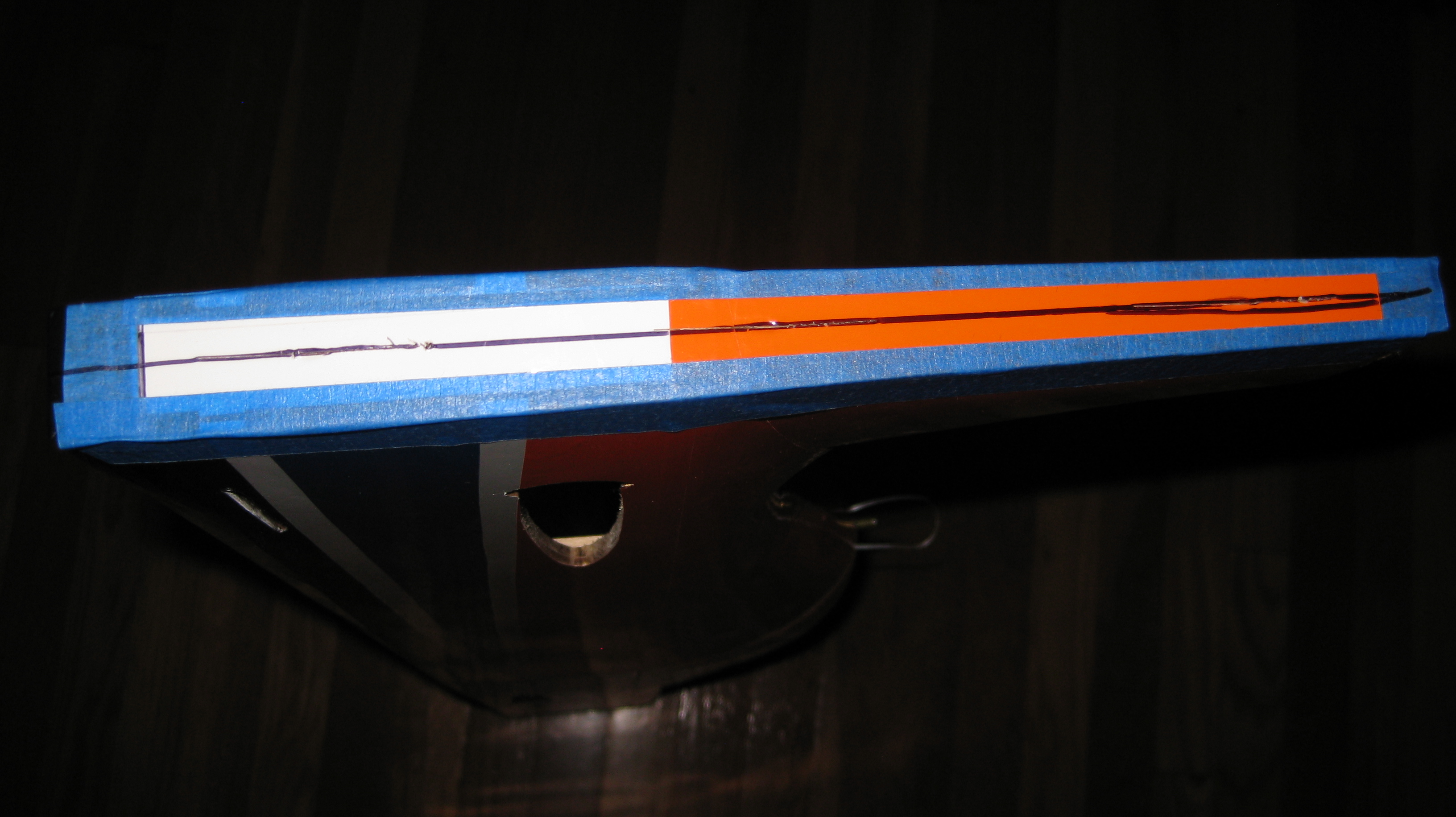

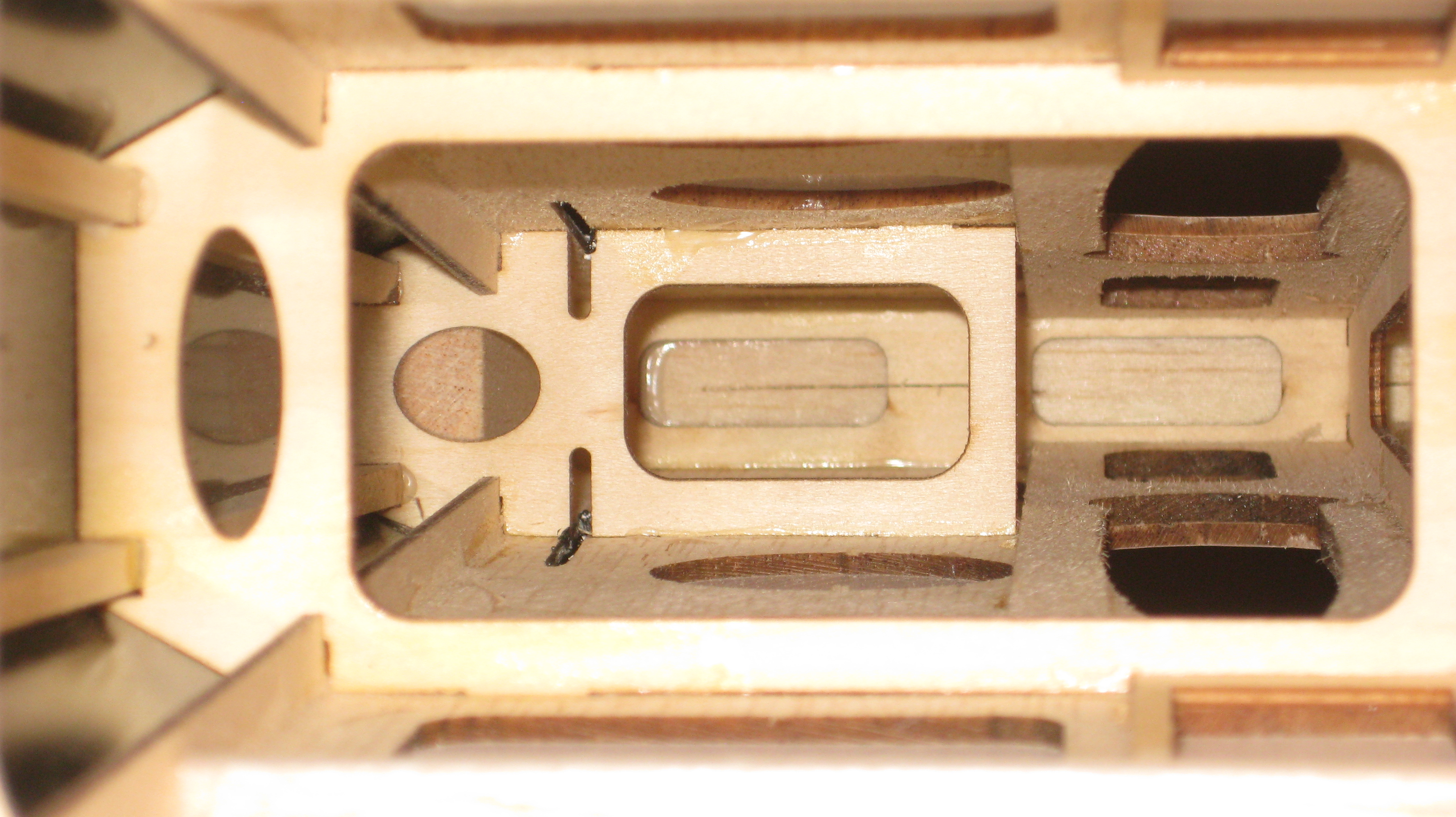

Despite flying for a few years , I still find myself needing to come to the beginners forum! Goes to show there is always something that we need to learn...with that....
I bought a Arfmfg/Skyline/Goldwing Sbach 342 60" quite some time ago. Ive recently been debating on getting started with the build. Upon a very detailed inspection for anything that needs to be done(reinforcement, gluing, modifications etc) I noticed a small issue with the rudder area. It seems to me that there isnt enough meat on the airframe to install robart hinges as originally planned. To be honest, I doubt there is even enough wood there to install CA hinges and not have them pull out. Ive attached a pic of what I can see from inside the fuse. It looks like the only wood back there is the external sheeting and ply framing.
Can someone provide tips on how I could make installing robarts(or even CA hinges) dependable without pulling out. The vertical line you see is where the manufacturer has slotted for hinges. If at all possible, I would prefer not to tear apart the covering to get at this. Ive thought about gorilla glue because of its expanding characteristics, however just don't see less that an eight of an inch of wood(give or take..) being enough to hold on. Maybe Im over-thinking this.

I think you need to investigate the thickness you have at the rudder post.
Drill a 1/16th hole from the rear and measure how thick it is.
If it is 3/8 or better,I would use fuzzy mylar hinges pinned with cocktail sticks.

So I did as you suggested and came up with 1/8" balsa sheeting ( This is in areas not backed by ply former).
Doesn't seem like much to work with

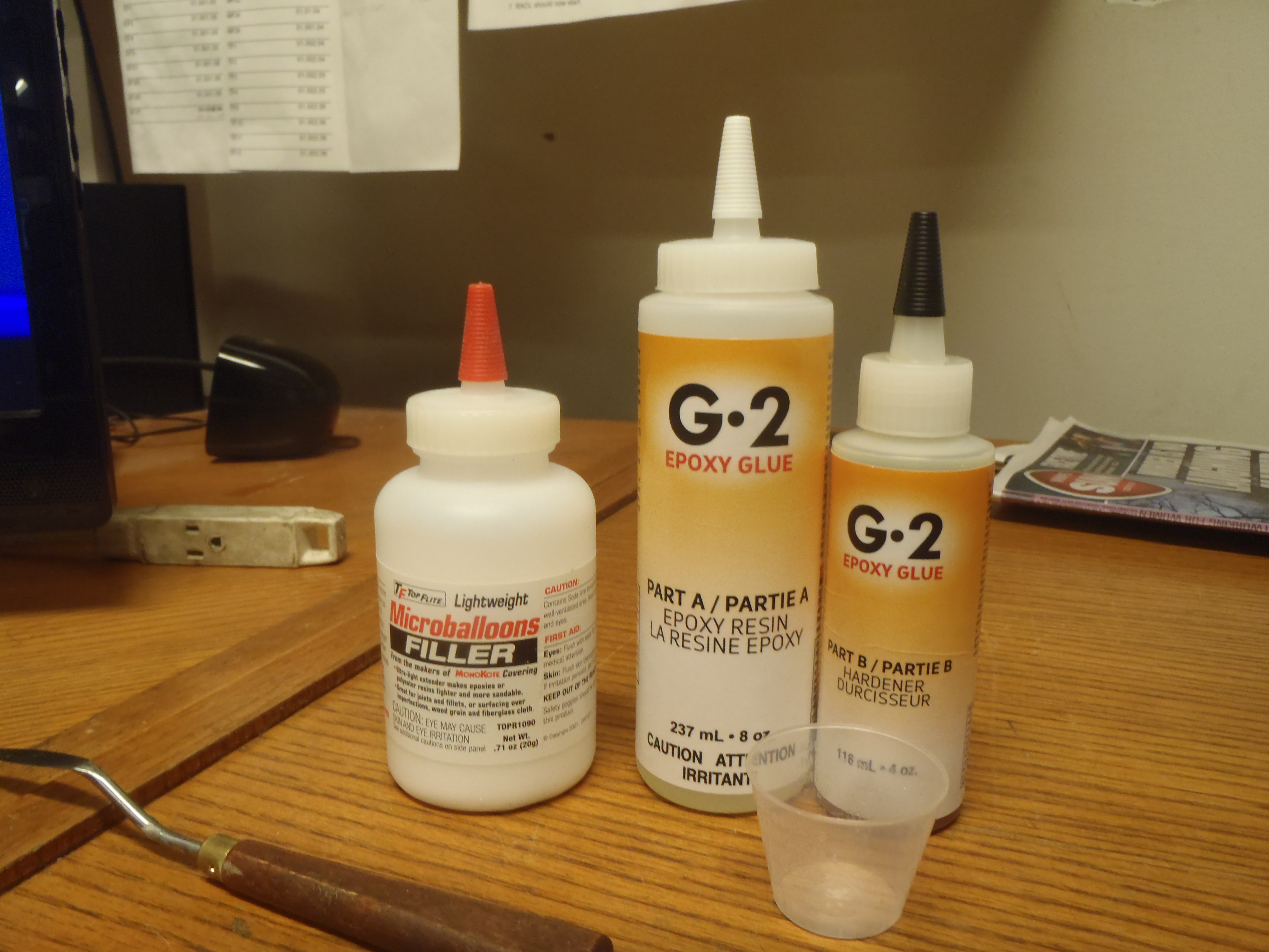

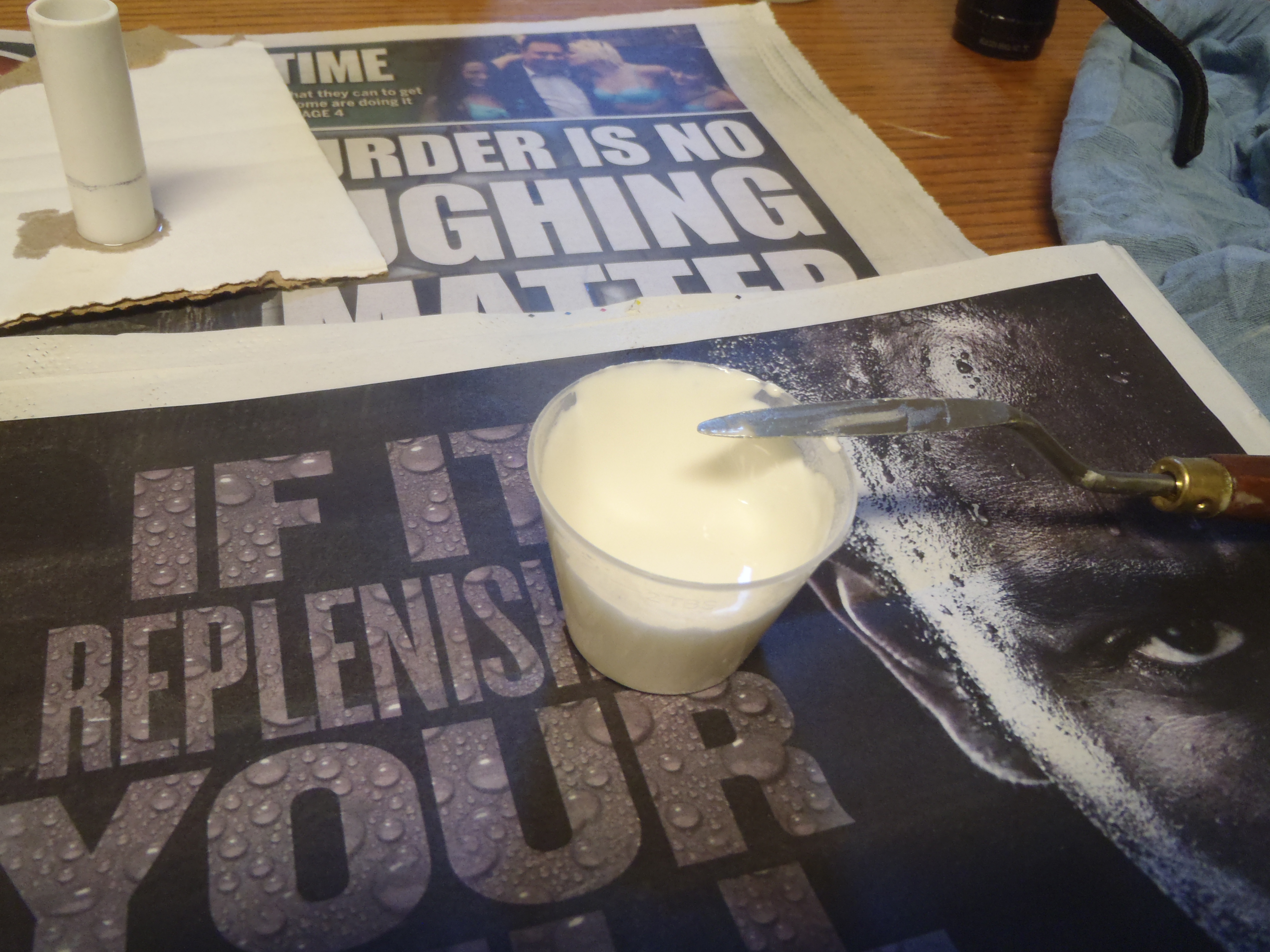

Just for the heck of it I am going to do a little experiment to see just how much epoxy and microballoons will hold. I mixed up a 50 50 mix of epoxy and balloons and have set a screw into 3/8" deep layer of it.
Tomorrow when it sets up I will use a luggage scale to see what the yield point is. When I made the mixture any thicker it would be a pain to get it to flow into the cavity. I like the G2 epoxy it seems to have a pot life of hours, great for this type of project, as long as it is strong enough

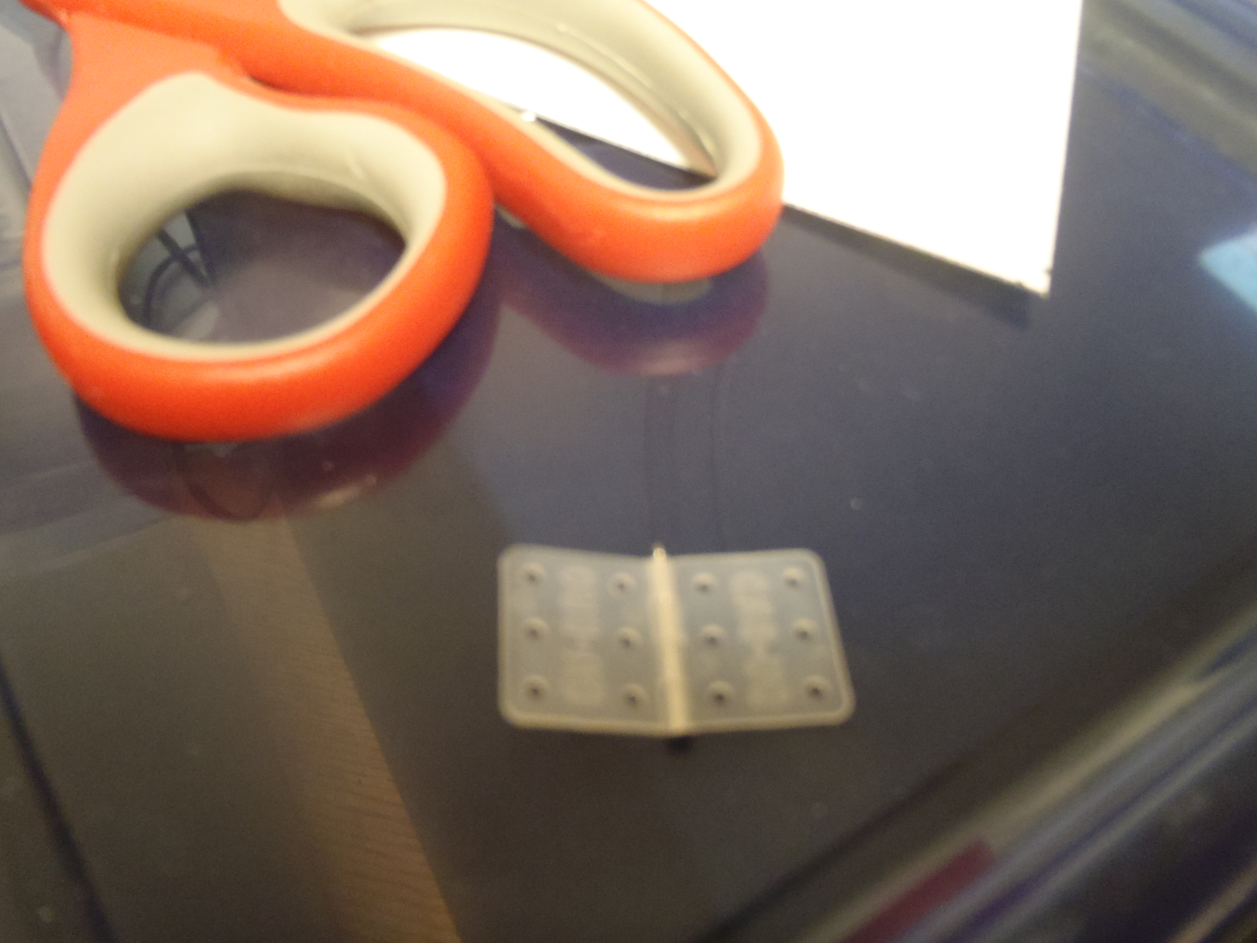

No, a hinge pin is just a barbed two piece point. The flat hinges look a bit like a CA hinge cut in half with a brass pin holding them together. They come in several sizes. I just used the last of the small ones I had on hand for a water rudder on some floats and the rudder was only 1/8 thick. I have used them on rudder on my 3-D arf, it is only 1/8 thick sq. They hold great with just epoxy.

DO you mean like this Gray Beard?

I think in that case I would add at a least 5 of 1/2 sq x 1in balsa blocks and use Robart barbed hinges.
What is the rudder construction like?

Yes, that is a Du-Bro flat hinge and they come in many different sizes. I do find it odd {even for an ARF} that they have such a small TE and LE. There is also a very small, about a 1/16 hinge pin by Du-Bro. Most of these small hinges are located in the electric plane parts shelves at my local hobby shop.

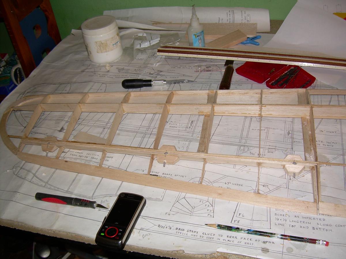

I used dubro hinges on this because the pivet point for the ail was at the very top but you can see the balsa blocks i added for the hinges . joe

Another shot ! And one of it doing its thing .lol joe

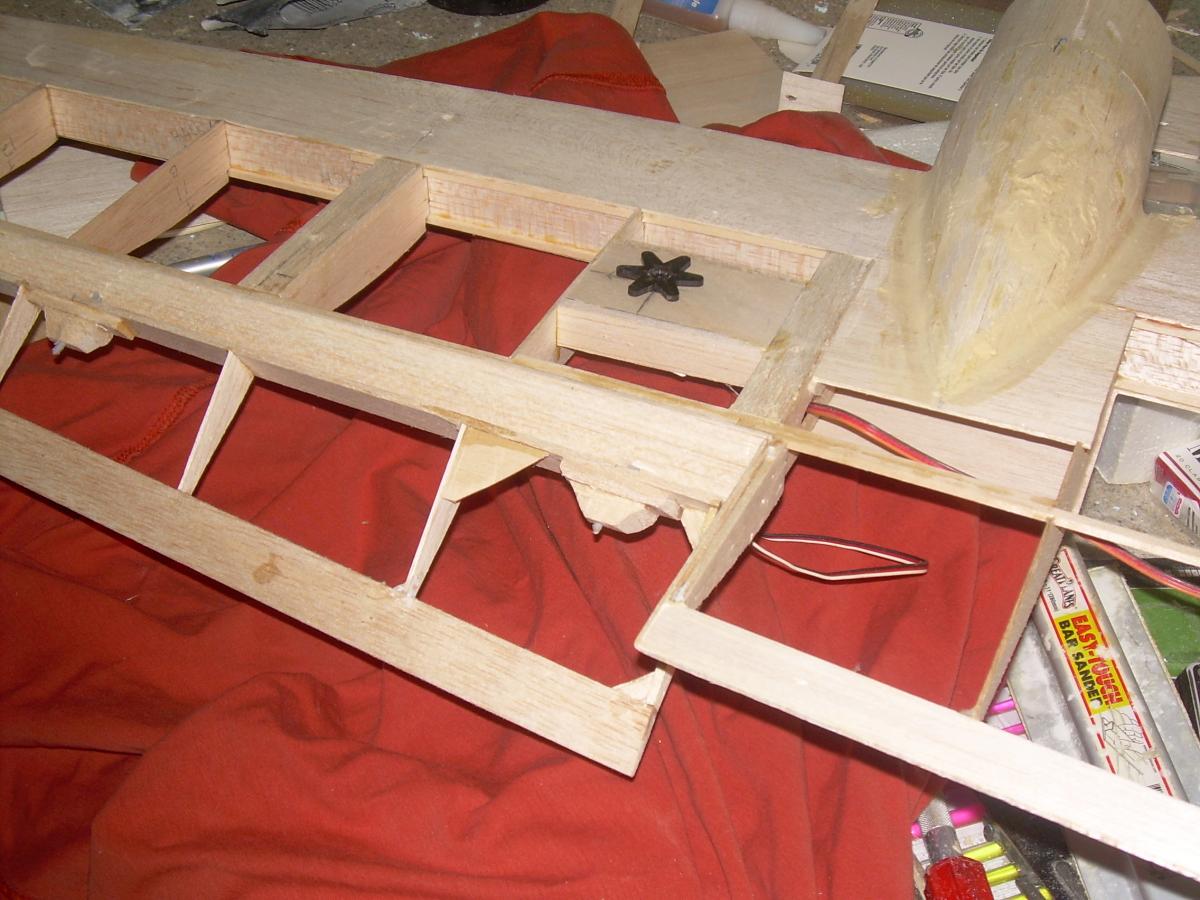

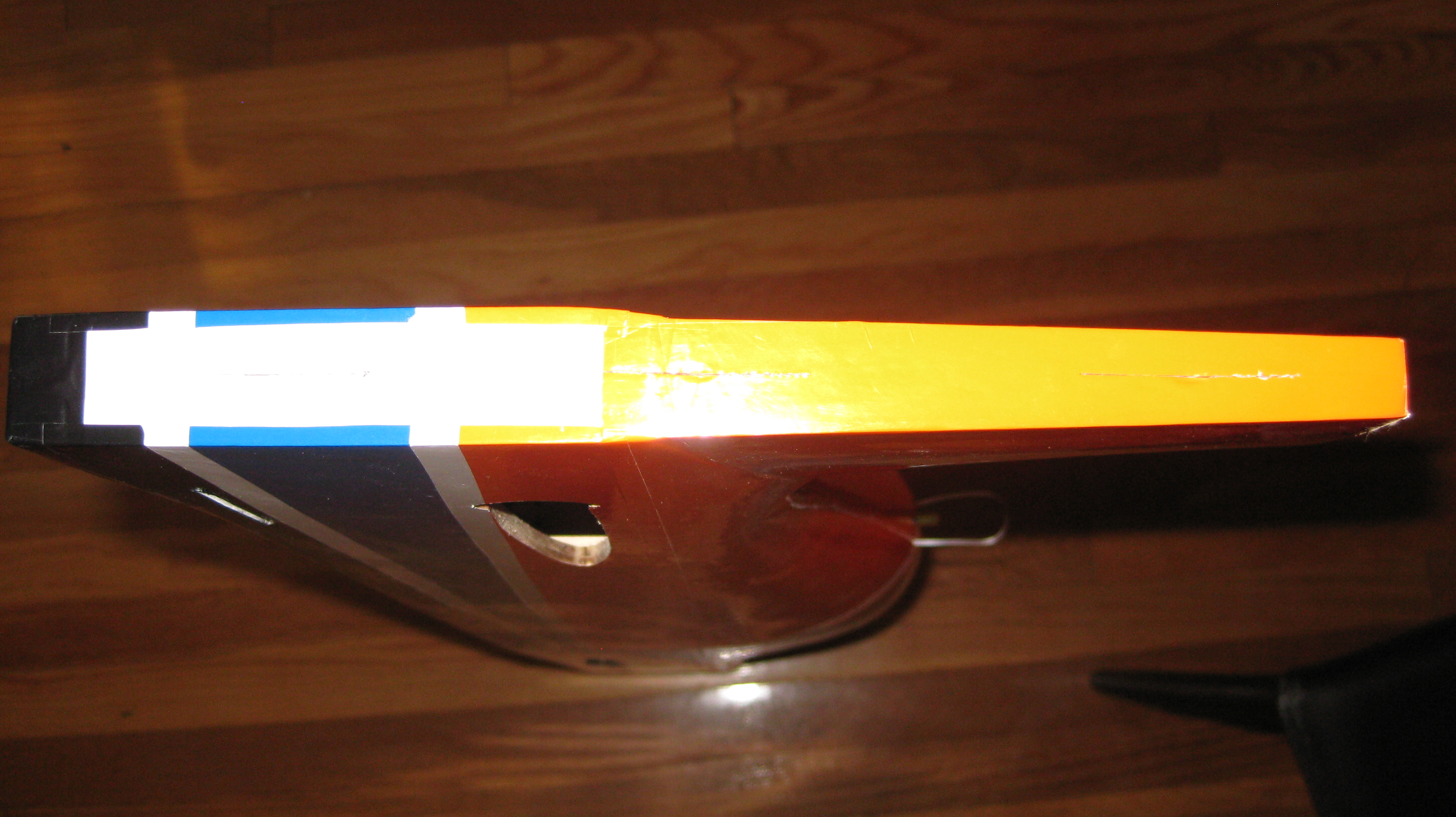

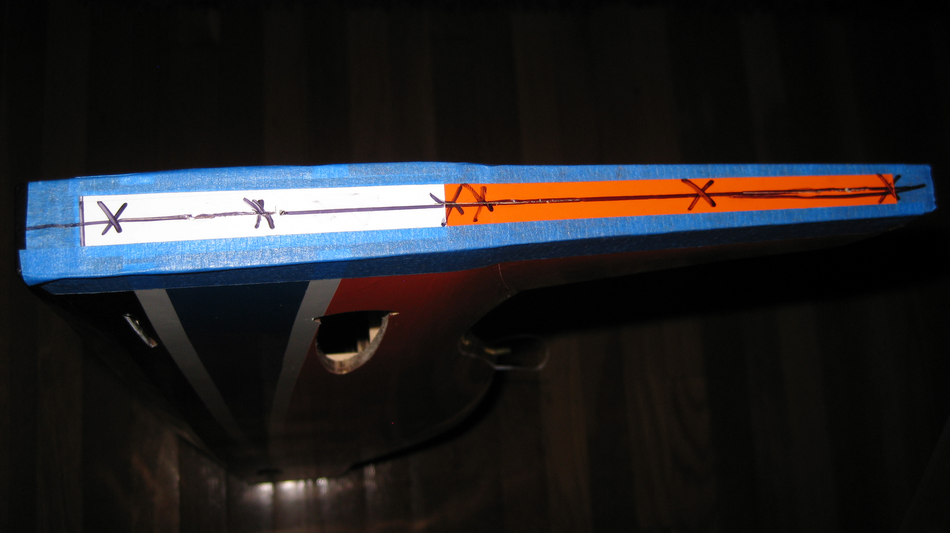

So here is where I'm at currently thanks to your input...I figured I could mask the tail end in order to peel back the covering with the tape acting as a stop. Then, Im guessing, cut out the section that has been masked, install blocks and reinstall same piece, or new piece depending on how it comes off.
OR being that I would like to avoid cutting pieces out of a new, covered frame.....
I could also drill out holes along the tail and glue in dowel rod to add depth for point hinges(Robart type). If I go this route... what would be the best way to glue in? CA would be ideal as it would just soak in, but would that really be enough to hold? If I used Epoxy or Gorilla Glue, most of it would come off when inserting the rod into the hole.
The "X"s in the pics mark where there is a former of what seems to be 1/8" ply. The rudder seems fine as the leading edge seems to be tristock all the way up.
Thanks Joe for the pics. Ive used that method previously on a rebuild I did of a Funtana a couple of years ago. But in that case I had the plane stripped to the bare frame which made it the best method. Here, Im trying to avoid stripping the tail down and keep the covering intact.

Well the results of my epoxy/micro-balloons look good, I gave it a 30 then a 60 pound pull and no sign of failure
Next I will give the stuff a weigh
Calvi

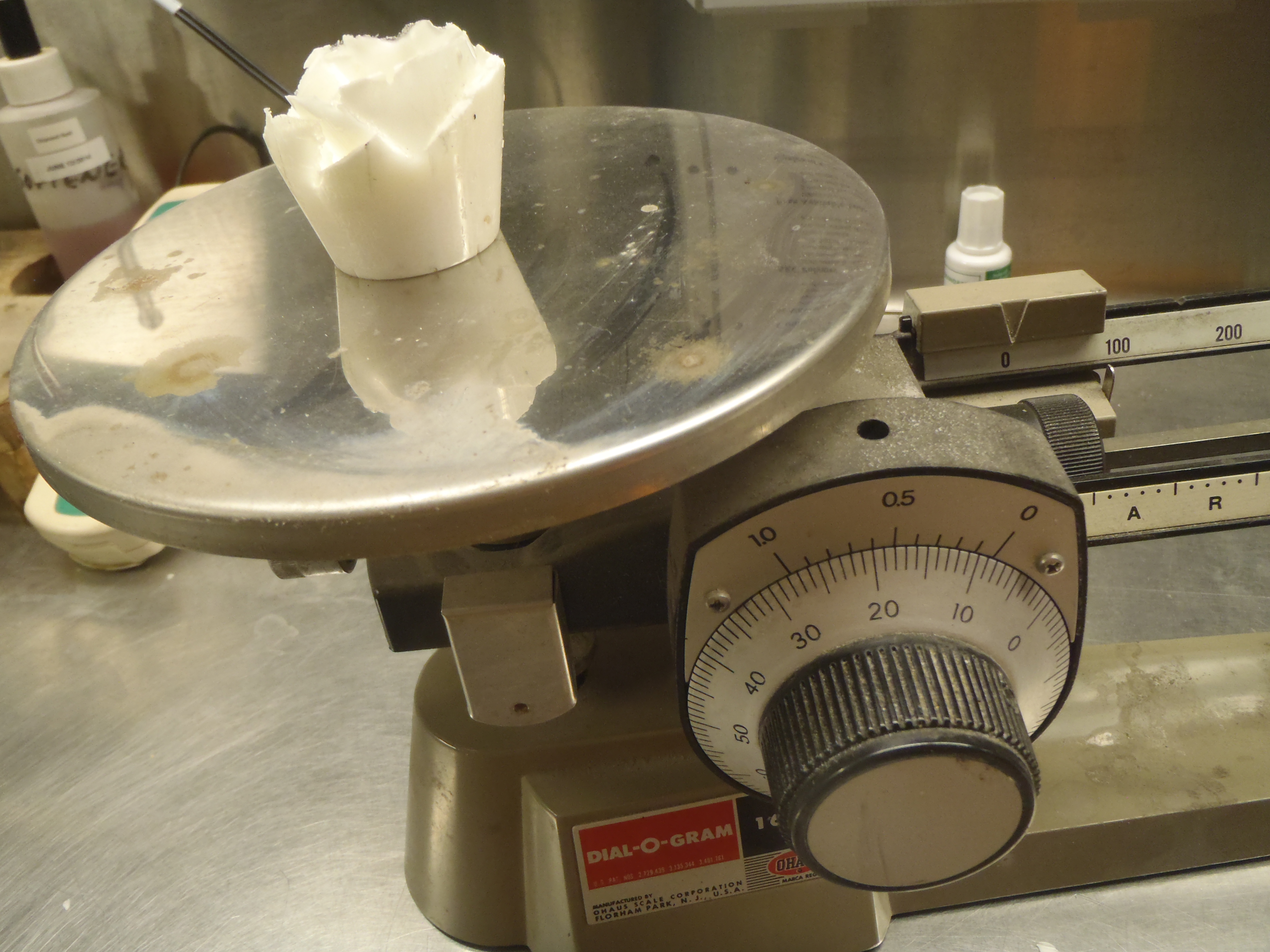

OK it looks like 20cc's of it weigh 9 grams, so less than half that of water,give or take
