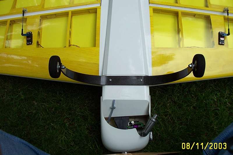

The outlet is just any opening behind the engine where air can go through.
Blow in a tube. Where you blow in is the inlet and the other end is the outlet. In this case you want the hole in back to be bigger than the hole in front.
Or... if there is more than one hole in front or back then the sum of the holes in the back should be bigger than the sum of the holes in the back (total area).
What you're thinking is fine. A lot of people used to use the black bottoms from the old style 2-liter soda bottle for cowls.

Wings - Yes - the outlet is (fore to aft) between the engine and the firewall, but they must lead to the outside of the aircraft. The easiest thing to do is look at a plane at your local field that has a cowl and it will instantly make sense.
Wings:
If you could find the front view of a Tiger Moth, you will see a slot in the front of the cowl for the air inlet. For us just move it over to the front of the cyl.. The outlet is under the cowl at the firewall, about twice the size of the inlet. There is a lip on the bottom of the cowl at the outlet to aid in causing a low pressure area to help draw the air out.

Wings - The cowl in the pictures you posted does not enclose the engine, it only makes the front of the airplane "prettier" and more aerodynamic... the majority of the engine is still exposed to outside air for cooling purposes. The "cowl" the others are refering to is the type made from fiberglass or plastic, one that encloses the engine, either completely with the head and all under a cowl or mostly enclosed, meaning only the top of the head (or valve covers of a fourstroke) protrude from inside the cowl. I have included a couple pictures of my Funtana to help you understand. As you can see, most of the engine is enclosed. The two holes on the front are the cooling "inlet" holes, the large cutout in the bottom of the cowl which is visible in the bottom veiw of the airplane would be considered the "outlet" hole. The air coming into the cowl is getting forced in by airflow generated by the aircrafts forward speed and propblast coming off the propeller. Once inside the cowl the air gets slowed down by the engine, motormounts, fuel lines, carb and anything else you can see when looking through the cowl from the inlet holes to the outlet hole/holes in the cowl. So, if you loose air velocity as it travels through the cowl you need to increase the VOLUME of air that can exit the cowl so that the hot air coming off the engine is not permitted to circulate in a pressurized, turbulent area outside the most efficient path of travel that the majority of the air is taking through the cowl, hence an "outlet" that is at LEAST 1.5 times the size of your inlet, preferably twice the size. Hope this helps
