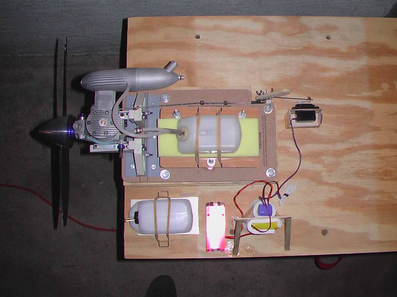

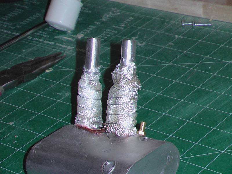

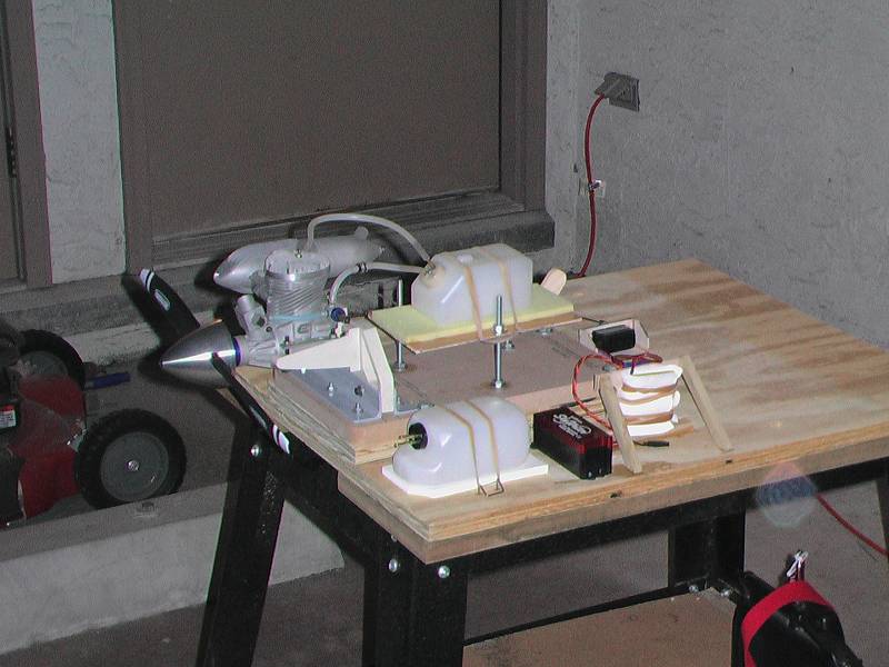

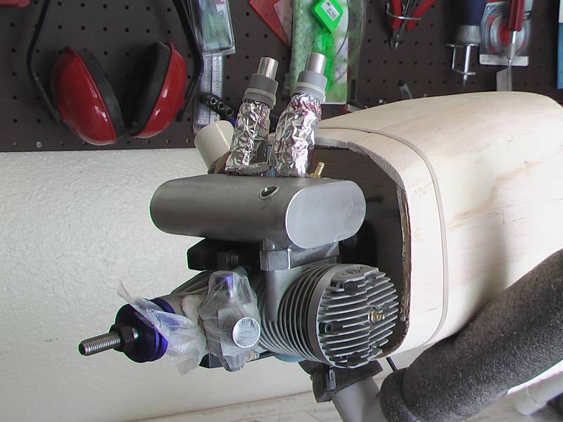

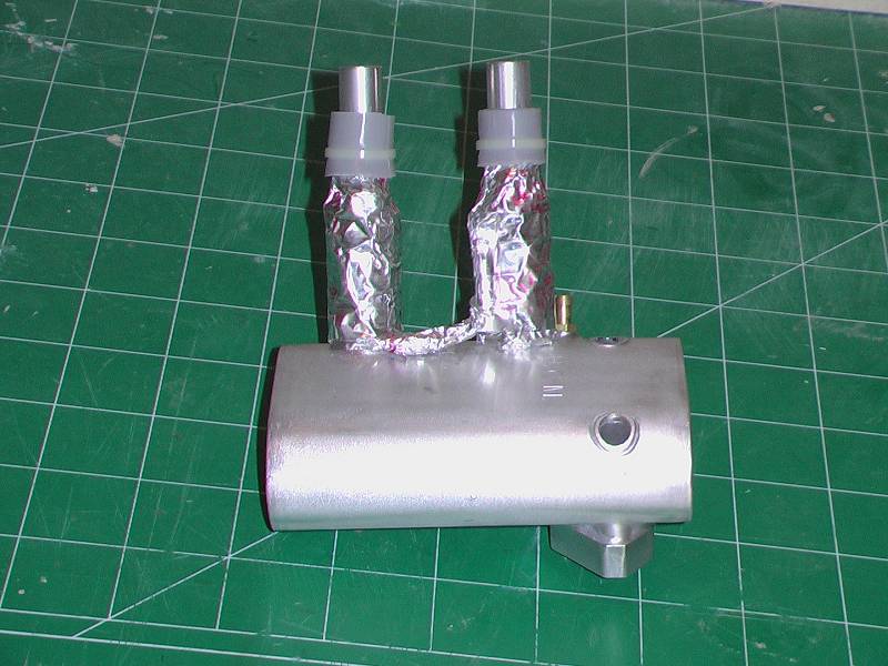

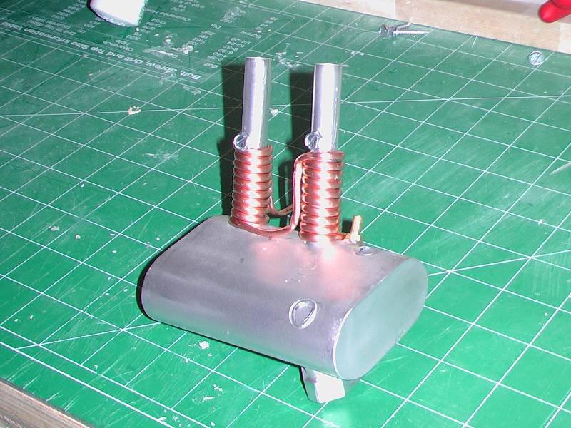

I just found this thread but I'm testing my smoke system tomorrow. I have a Evo 1.00 2-stroke w/ a pitts muffler. 2-strokes don't get that hot so I had to use 1/8" copper tubing insulated with 3 layers of fiberglass & aluminum tape as a preheater. I post the video this weekend. Here are some pics:

nice work, quite the contraption! do post pics for sure... post the rest of your setup too... tank size, how much time you get and any other settings...

BTW did U use the "sand in the tubing" trick to wrap around? NICE JOB!
Minn, I did mean the flat part of the muffler (port chamber) thanks!

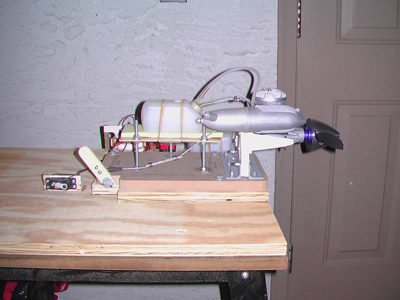

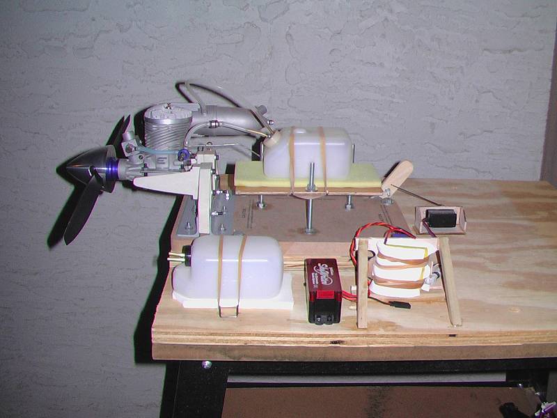

Minn knows what he's talking about. I've seen guys tap the crank case to pump the smoke oil through, but I wasn't comfortable with drilling a hole in my engine. It was much easier to get a pump (I got a Sullivan Showtime Kit-all tubing, filters, clamps needed for $69.99 at tower) and a separate 6V battery to power the pump. I made my stand to where I can test everything (smoke system & engine) remotely with the TX. Here's a few pics:

ORIGINAL: vasek
Nope, this is the great thing about 1/8" copper tubing; it's so soft that you can wrap it around a pencil (~1/4" diameter) 20 times without getting kinks! 1/8" Copper tubing is available at most auto parts store in 6" rolls for $9.77. I got mine from Advance Auto Parts here in FL.
